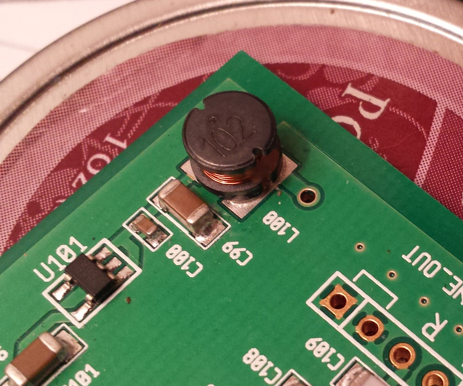

I have the ODAC PCB and I broke it by carelessly handling it while the power was on. I wonder if I can repair it. The L100 inductor gets extremely hot when plugged in and I wonder if replacing it might fix the problem. Is this something worth trying out? What specs should I look for if buying a replacement?
