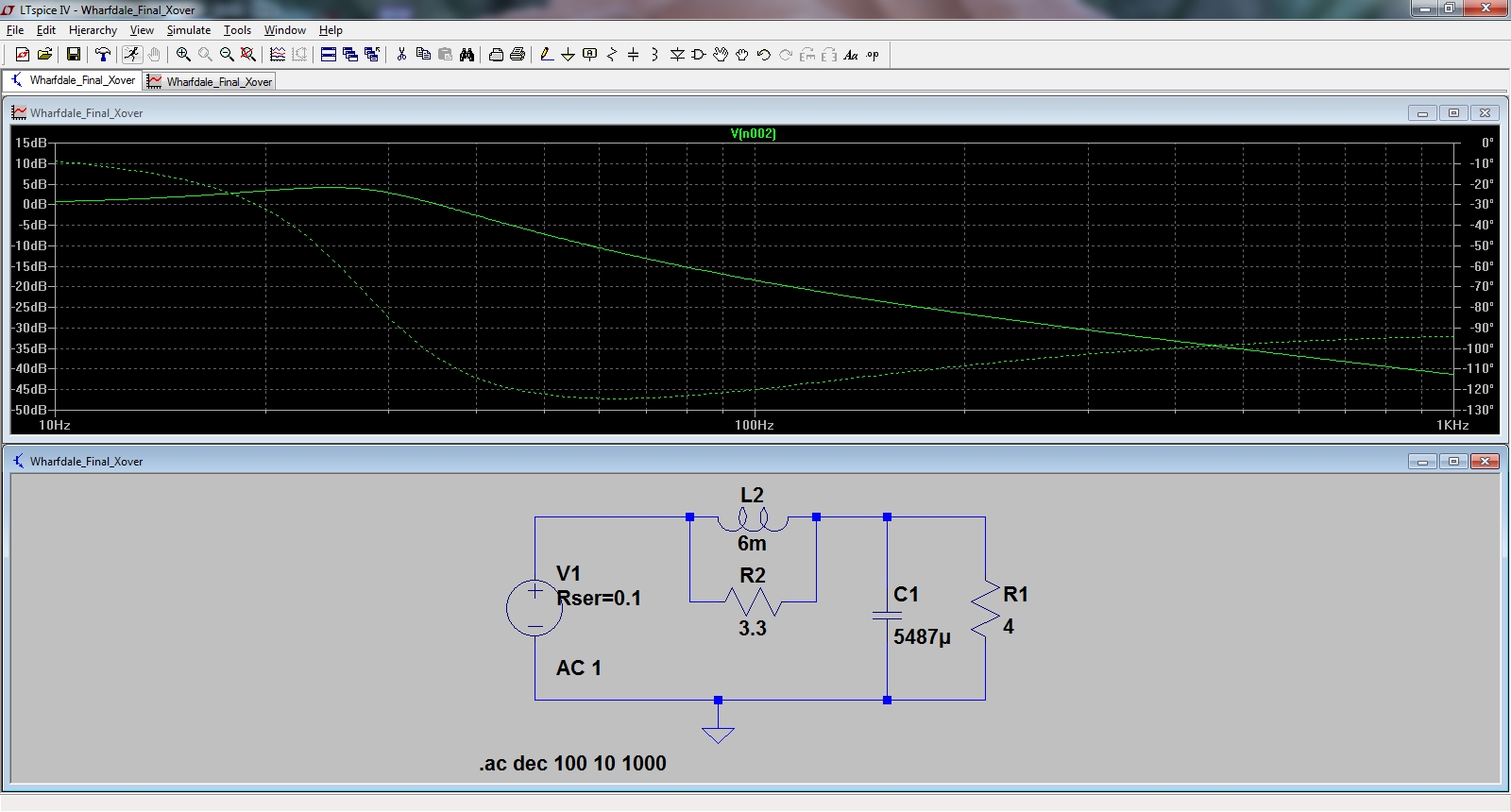

Okay, here's the "xover" part.
Had to start somewhere, so I bought a pair of the original xovers. Throwing everythin' I could find from my junkbox, they ended up like this - added inductance (parasitic resistance not included) and added capacitance...
Yes, that is 5000+ uf, from 4 X 10,000uf power supply caps I removed from a Sherwood amp. connected back to back. Only value I have 4 of...
I'm driving these with a Dayton class D amp, 75 WPC. Was using a 50 WPC class D, which didnt even get warm at my listening levels.
So I'm getting a reverse rising response if I shelve what's shown up by the volume level on the Dayton amp. I eventually want to design such a "reverse rising response" into the amp itself, by modifying the rear panel bass/treble adjustment circuitry. It appears to be op-amp based. (No schematic, of course! That's never stopped me)
However it is I came to crafting the xovers and adjusting the amp volume to taste, the bass sounds fantastic; all notes even and plenty deep. It just doesnt sound like an acoustic bass is standing there between the speakers, as the visceral that instrument is capable of doesnt come through. I'm elated with the sound, also that I can listen at a comfortable level - with bass - w/o bothering anyone else in adjacent rooms of the house. Compromising on the visceral oommpph in order to be able to do so.

It looks like the response of your filter is more or less a first order lowpass. That will compensate for the dipole cancellation, however, the effect of the driver's response must also be included into the equation.
On an open baffle a driver will have a response that is very much like its free-air response, that is a second order highpass with F~Fs and Q~Qts. Unless your driver happens to be one of those "high Qts" open baffle specific ones, the driver's own response will be "drooping". If you want those lower notes that give you more visceral bass then you must also flatten (via boost of LF or cut of HF) the portion of the response due to the driver itself. This would be like (in your terms) an additional "inverse" second order high pass filter. You might be surprised how much additional power is needed to make up for all of these losses when the driver Qts is e.g. around 0.35, which is the typical Qts for a driver designed to be used in a vented or sealed box.
Also, you will not have an easy time measuring the response from this driver at the listening position. A nearfield will not include the dipole cancellation, and a far-field measurement needs to be done in a large space or outdoors to eliminate reflections from the room boundaries.
There is a way to model the response starting from a nearfield measurement or the response predicted by the TS parameters plus the dipole losses. You might want to give that a look.

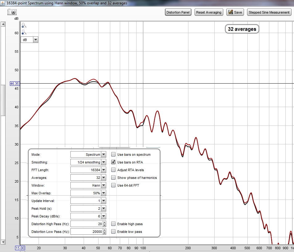

Placing my Apex 220 measurement microphone 1' above the carpet about 1M in front of the right woofer (only woofer amp running, right speaker), using the RTA in REW with my Ivie pink noise source I get (pic 1). Did I just get lucky?
Removing any toe-in and measuring at my listening position, with both speakers running, I get (pic 2). Maybe I just snapped the image at a good moment? If I toe in at all, I get a big peak @ 70-80 Hz.
I turned the amp up quite a bit when I first turned it on and noticed "Wow, look at those cones move" at which point one of the channels shut down. Fortunately it recovered with a power cycle... So FAIK the amp could be outputting crazy high power to make it do this, using the speaker level Xovers. Not to imply line level filters would make the amp work any less, just not into such a crazy load.
Let's say what I measured is real. When I go into the room next door, I hear nothing. I'm pretty sure if I used the sub to get the same SPL over the same frequency range, it'd be just as loud in there as my listening position.
Why? (and it could be a good thing if predictable and manageable)

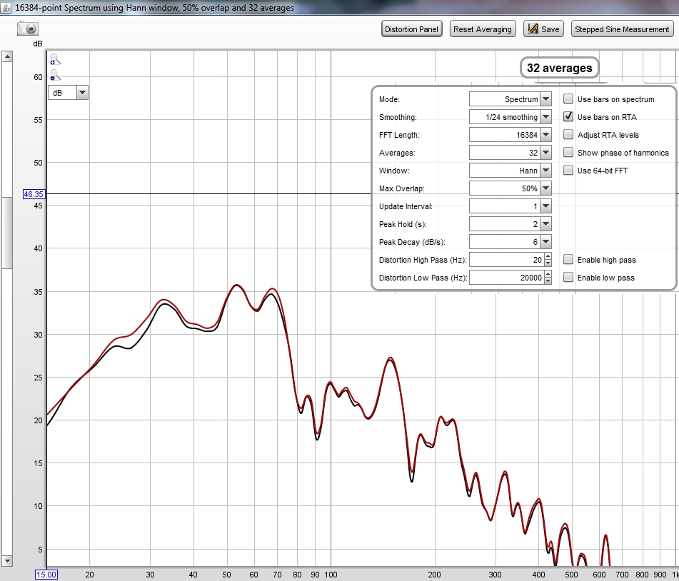

I tried to do a FR plot of the whole OB speaker today and it seems I like the bass just a little bit up from the rest of the spectrum. To match the SPL of the rest of my pink noise induced FR analysis using REW's RT spectrum analyzer, I had to turn the woofer amp down really far, which surprised me. Almost into "why'd I even bother" land...
To get rid of a crossover notch at ~70 Hz, I had to reverse the phase of the 18" woofer.
Then after EQing the rest of it for as flat a response as I could get, I didnt like the sound. At all. Turns out I'd rather live with the notch, than the woofer out of phase, which sounds worse... I cant even listen to the system that way, so I had to put it back in phase.
I need to find a way to run the 18 and the Lii 15 in-phase at some Xover point between the Liis natural roll off ~70 and say, a few 100. I guess the in-phase part requires Linkwitz-Riley 24 db crossovers - but the low pass output needs the reverse rising response also.
The amp I'm using to drive the Lii has a circuit opportunity for two additional high pass filter stages, which I could put over the top of the Liis 60-70 Hz rolloff, maybe that could get me 24 db / oct all told. Then what to do for the woofer XO?
Or buy someone's stereo LR 24db crossover and modify the low pass output to give the reverse rising response. Another $100 to get this OB in the ballpark of working - and sounding - right.
Maybe look into the Dayton Audio DSPB-K DSP Kernel Board. With the programmer, perhaps I could turn that into 2 low pass outputs with the 24 db slopes and reverse rising response. I'm not sure what's the best tack at this point.
