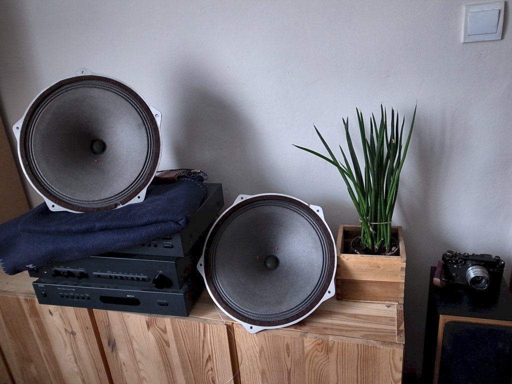

My not so clear question : I'd like to build an OB with a fullrange running 6-8" with a bass driver low-passed 150-200Hz 1st order do match a 2w tube amp. I got a beautiful pair of vintage 14" alnico Tesla ARO835, 4Ohm . But im not sure of FR selection and its impedance / implementation / safety.

just a snap of new babies on a testing rig
