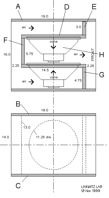

Scale this up to a 15" driver.

Regarding cavity width for a W baffle, I had the same question and couldn't find a hard answer. The height and depth dimensions can result in cavity resonances, but they're well above a sub's frequency. You just don't want it too narrow to create air flow noise, so the narrowest possible with the push/pull alignment leaving reasonable clearance if the pole is vented should be fine.
How about if I made all three chambers the same size? Then I could try facing the drivers either way.

Thanks, Tom. I've got that gif saved somewhere. WHen I said middle section, I was thinking of a design I saw where the drivers were facing each other. Wonder where I saved that? :xeye:
You may want to rethink the drivers facing each other. Here is
a response from Roscoe Primrose to the question of why is it better to have them oppose each other rather than face each other....
Second order distortion cancellation. Remember, in a W baffle the drivers are moving in opposite directions, so one cone is moving towards it's magnet structure wile the other is moving away...
Peace
I think Tom didn't mean "oppose each other". You want one facing the basket of the other, so they are facing the same direction but moving in opposite directions. They both fire into the chamber at the same time. One is pushing out of its basket and the other is pulling in, thus Push/pull. I did some experimenting and there is an audible difference at medium to high volumes and it becomes even more important with cheaper drivers.
