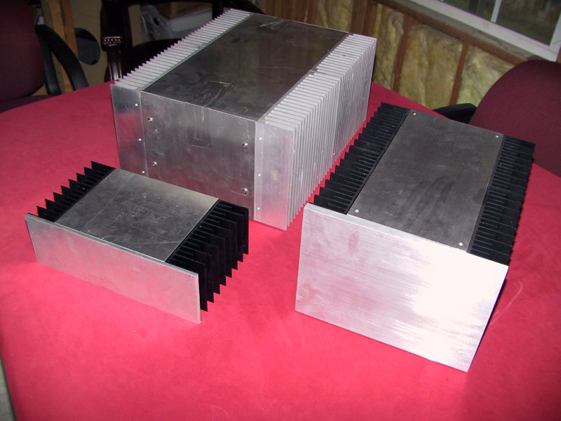

Here are some of the chassis that I have made for Class A amps, but never finished...
The smaller one in the front is made from cutting one of the bigger black ones in 1/2. I bought these with Rob and his chassis is made with 5 heatsinks.
(aluminum not finished yet.. needs some work to get the scratches out. I built 2 of the large ones with surplus heatsinks, originally for Aleph 2 monoblocks)
