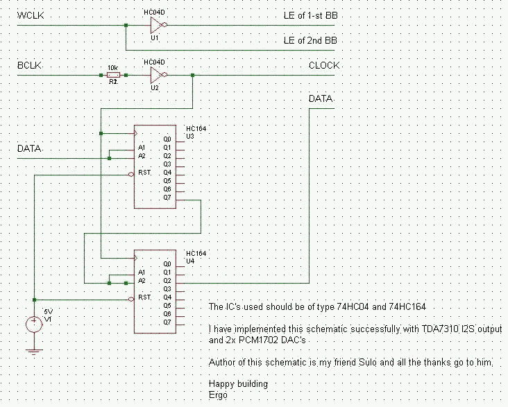

Well, I finished an experiment during the weekend that consisted of Philips CD610 (model from the beginning of 90's) used as a transport and I2S taken from the players servo SAA7310. I also replaced the clock with a four pin in can unit from ELFA. I don't have any verified audiophile clock on hand, but this ought to be better than the original oscillator inside the SAA7220 digital filter.
The I2S was fed through some logic IC's into 2 BurrBrown PCM1702 DAC's. I own a big thanks for interface schematic to my frind Sulo. The DAC chips were fed with +/- 5V created with LM317/LM337 regulators sepparately for digital and analog. Before regulators the supply had LC filtering - 10H indictor and 10000uF of cap.
The analog stage of the DAC - well there wasn't any. At first I fed the signal straight from the DAC output pin to my passive attenuator (10k) and then into JLH'96 amps. As it turned out the DAC clipped with 0dB sinewave with this configuration, although it was very soft tubelike clipping. So by experimenting the final value of the resistor from output pin to ground was 680 ohm. This still showed a little distortion with 0dB signal but it was about 0.1% of second harmonic so I didn't go any lower. There rarely is any information on cd to reach 0dB anyway.
The only techical remark till this was that the output of the DAC without any active stage is about 400mV - a little low

Yes I'm sure there is no oversampling. The original schematic had SAA7220 digital filter that did the 4X oversampling and TDA1543 DAC. It is also verified as I checked the bit clock and it's 2.8x MHz...
I'll try to input the schematic into some editor in a few days, at the moment it's on the corner of some piece of paper

Jocko,
I am confident that oversampling will sound better. However, given that there are now so many enthusiasts for none-oversampling, I thought I'd rig up something to get a first hand impression.
Have you experienced sonic differences between NPC, DF1700 and DF1704/06?
As for the soldering: the freeware version of Eagle (www.cadsoft.de) will allow you to make double sided boards up to 100x80 mm². It contains a footprint for the SSOP28 case. If you want to, you could even design a SSOP28 to DIP28 adaptor PCB...
Soldering a SSOP28 is pretty easy if you use solder paste and a hot air blower. I have even successfully re-placed a SSOP28 on a home-etched PCB. Only one wire pealed, meaning I had to hand solder a thin wire.

little flaw
Hi Ergo,
I believe there is one cosmetic flaw: the L and R signals will not appear at the outputs at the same time. Rather, there will be a skew of 23 microseconds. I doubt that this is audible, it corresponding to one speaker being advanced by 7 mm, but if it does not hurt my purist ear, at least it hurts my purist eye...
Greetings,
Eric

I2S Philips format conversion to Sony/Burr-Brown
Hi All,
The Analog Drevices Application 207 note takes care of that using a dual D-type flip-flop and a quad NAND gate.
The two stereo channels separation is accomplished by the so called "stopped clock" technique i.e. the bitclock is stopped during loading the data to the DAC of one channel (don't remember which one). Both channels are latched simultaneuously as they share the same LATCH. No timing difference between left and right channel.
Unfortunately the Application Note is no longer on the AD website but I can send the PDF file by email if in need.

Re: AN207
AN 207 IS available on the ADI website at http://www.analog.com/library/applicationNotes/AdAudio/AN207.pdf
Alas AN207 will not work with the PCM1702 or PCM63 as is.
ray.
