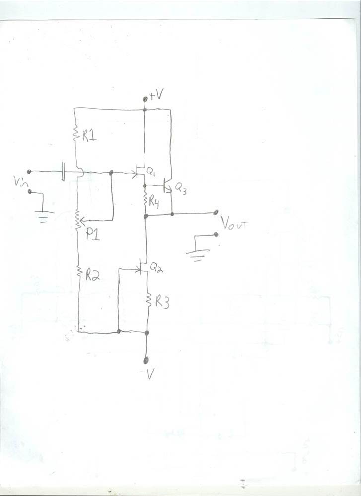

non-NFB buffer
Q1 is a Jfet follower and is biased with a constant current because R4 will always have Vbe of Q3, or 0.6V across it. P1 sets DC bias, Q2 is the self bias J-fet CCS. Regulated PSU is a must. Just a quick thought.;)
