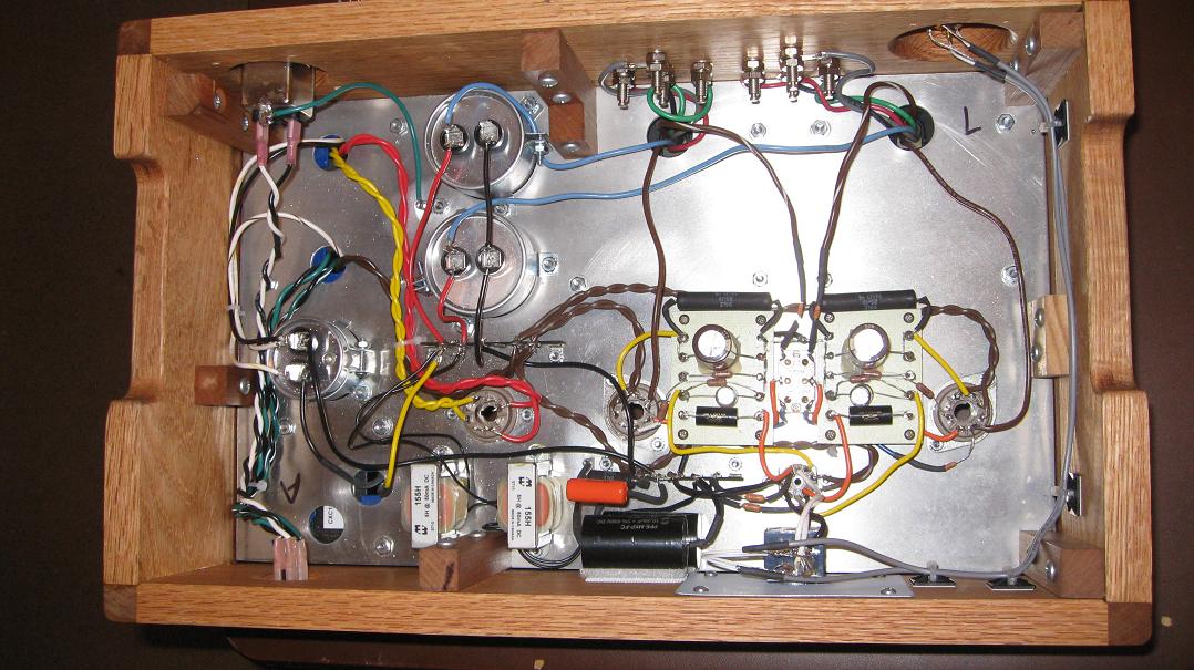

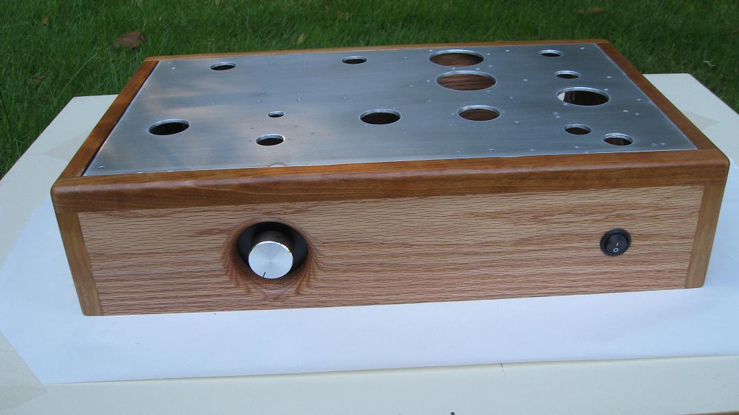

I appreciate the beauty of wood myself. For my tube amp, I compromised with a wood frame with an aluminum top plate.
One trade-off was that I had to lean on a friend with metal cutting tools. :D
