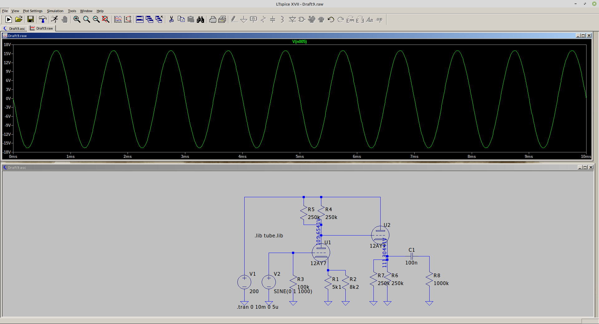

This could be normal, how sensitive are your speakers and how much gain does your amplifier have? If you have excessive gain in your system, then the preamp noise floor may be over amplified and it would appear to be noisier than it otherwise would be with a properly matched amplifier/speaker combination.
This problem will be made much, much worse by using a 12AY7 in a linestage preamp. Even with the unbypassed cathode resistor on the first stage, the gain of this preamp will be stupidly high.

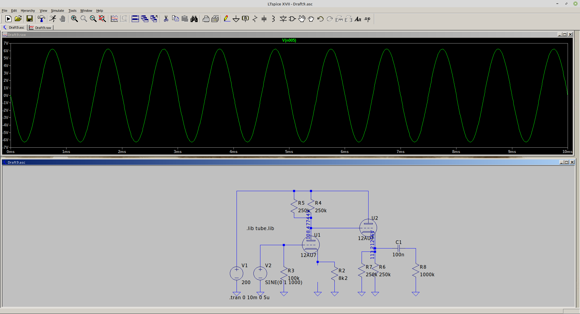

Maybe just a lot of gain. These days the volume control would be placed between the pre-amp output and the power amp - not in front of the pre-amp. Maybe 12au7 rather than 12ay7 but will need changes to the cathode resistor (maybe remove the 5k1). You want the plate voltage to be about the same as the 12ay7. The cathode follower should work OK without mods.
You could also split the cathode resistor on the cathode follower and take the output cap from the tap in the middle. This would reduce gain as its quite linear.
Maybe it is a good idea to try to replace 12ay7 with 12au7 in the line stage (and maybe also follower).
Any idea how o modify resistor values them? Ra and Rc.
Or would it work to decrease gain using current 12ay7 and reducing Ra?

Thanks a lot! Will definitely give it a try. I don’t have any 12AU7 with me now so need to get some.
Do you that this 6 dB gain reduction can help with noise?
And can similar be achieved by reducing Ra (anode resistor)?
Ok, so I have some RCA 12AU7 tubes, removed the 5k1 cathode resistors and seems it helped - the noise is lower than before with 12AY7.
It is still audible but when I play LP with silence in the track and compare it with the noise of the preamp without playing vinyl it the noise level is lower.
I think it is ok no more noise reduction is needed or even possible(?)
Gain drops by 6dB with 12au7 just remove 5k1 cathode resistor
