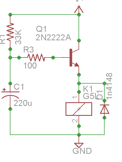

LM1875 has no mute circuit and requires one for both turn-on and especially turn-off. Else you will hear that pop.
I use the one below
Hi, can you tell me more about this circuit? I mean supply voltage and about delay time. I want to use 30-36vAC CT transformer for lm1875.
Dont go much above 30 volts unless the chip is genuine.
And drive the speakers throigh a capacitor.
I run the one in #3 off the same rail as the amp. 34VCT for 23V rails under load. 24V relay, and delay time is calculated with time constant of R1xC1.
I used, from memory, 47k and 22uF but it could have been different.
