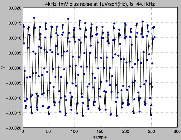

This is meant as a fun little condundrum about measuring noise from FFT style plots - some of you will know this stuff, others might be surprized.
I'm using a notional 44.1kHz sample rate and 256-point FFTs.
Imagine a signal with a -60dBV sine wave (that's 1mV rms just to be clear) added to white noise of 1µV/√Hz voltage noise density (-120dBV). Here's a plot, the tone itself is 4kHz:
The amplitude of the tone is 1.414mV as you'd expect from 1mV rms, and the noise is about 0.15mV rms over the 22kHz bandwidth of the sampled signal. [ √(22050) * 1µV ~= 0.15mV ]
Seems straight forward, 1mV rms of signal tone and about 0.15mV rms of noise.

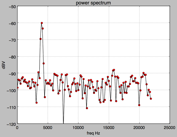

So we take its spectrum using a 256-point FFT and Hann window, and display in dBV:
The 4kHz tone peak is at -60dBV as expected. However the noise floor is around -95dBV.
But 0.15mV rms is about -76dBV.
And our noise-floor was supposed to be -120dBV anyway.
Neither of those correspond to the -95dBV we see in the plot. What's going on?

First point is that the amount of noise depends on the bandwidth of the measurement, whereas the amount of signal doesn't (so long as its somewhere in the passband).
And secondly an FFT is really a series of measurements each with a bandwidth equal to fs/N where fs is the sampling frequency and N is the number of points in the FFT.
Changing the sampling frequency or changing the number of points of the FFT both affect the apparent noise level in an FFT spectrum (and so does the choice of FFT window). The difference in dB between signal peaks and noise floor is not just a property of the circuit being measured.
For instance here are some plots of that same signal (averaged to reduce variation in the noise floor), with 256, 1024 and 8192 point FFTs. In each case the raw data is identical.
They are plotted with two scales, the left one for signal level, the right hand one for noise density, aka power spectral density (well amplitude-squared rather than power to be precise).
When measuring noise you normally want to talk about power spectral density, as this is a property of the system being measured, be it an amplifier or whatever.
If you take an FFT without recording the sample-rate and number of points and window function, you cannot subsequently determine the absolute noise level even if you know the absolute signal levels.
