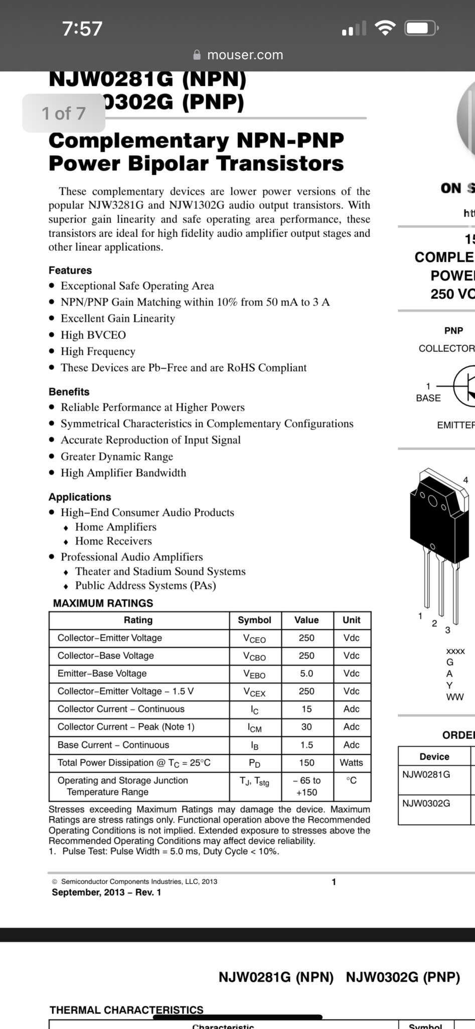

Hey all, I’m hoping you can help me out by answering a couple of questions for me. Comparing these two set, and I guess comparing other TO3P like NJW21193G/NJW21194G. I know the 21193/94 have a much slower Ft.
Would the 0302/0281 pair work in most instances where the 1302/3281 pair is called for? Spec wise they look to be identical other than the 0302/0281 pair being rated for 150w dissipation vs the 200w of the 1302/3281 pair. And then the 21193/21194 pair have that same 200w rating, but also rated for higher voltage and higher current.

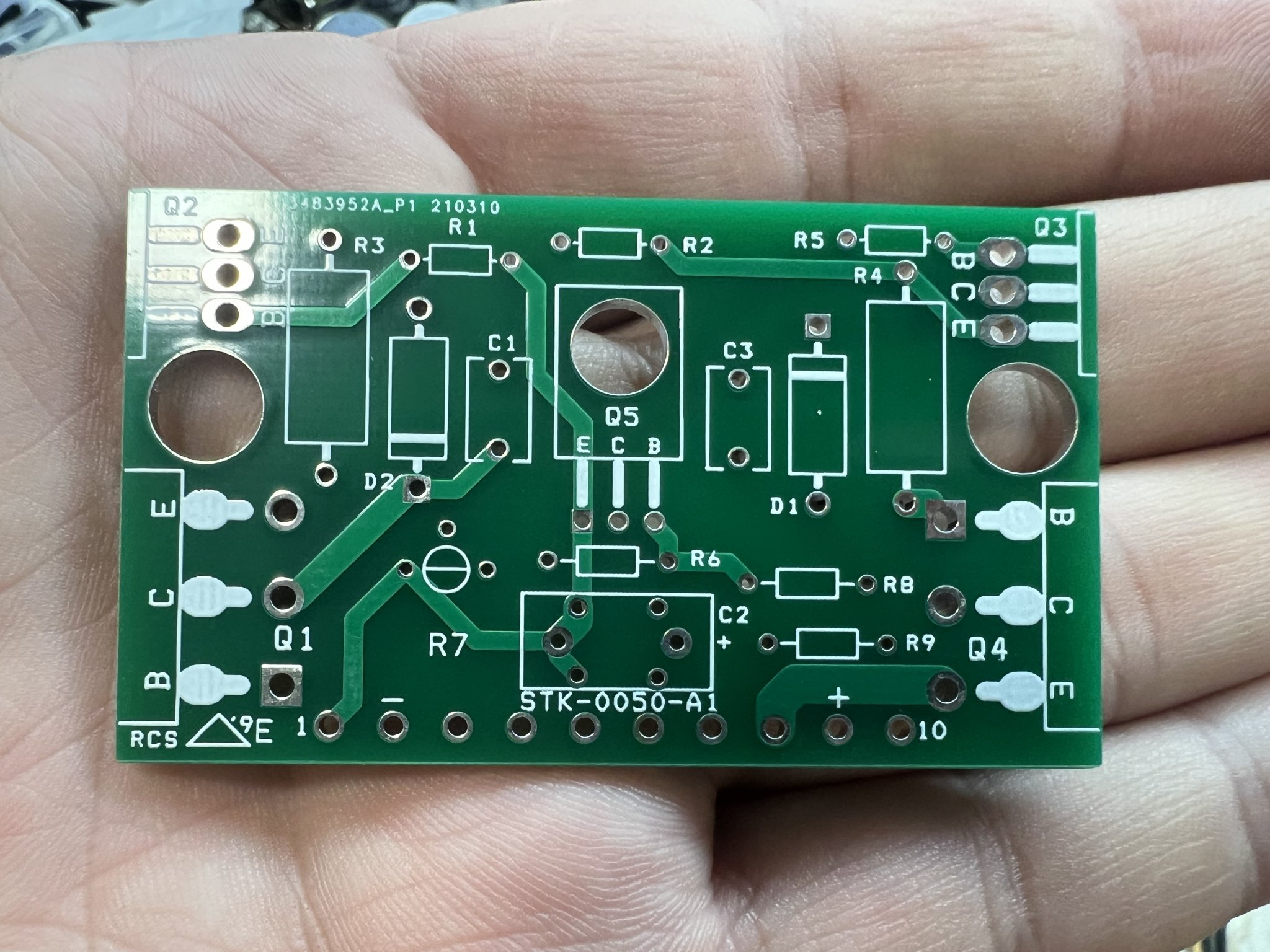

I’m guessing for instance when building this STK-0050 replacement board that was wonderfully designed by great members here and audiokarma
https://audiokarma.org/forums/index.php?threads/stk-0050-replacement-for-sx-780-and-others.721181/
That the 0302/0281 outputs would work just fine in place of the 1302/3281. Are there many designs out there where the extra 50 watts of dissipation would absolutely be necessary?
And then comes the SOA of the devices, I’m guessing that the 1302/3281 is better in this regard, is that correct?
Here is why I’m asking. Parts are starting to get harder to source. The 1302/3281 packages are out of stock and have been out of stock. I still have a couple dozen of each though. I was going to buy in quantity.
Do I buy the 1302/3281 at $3.80 each and wait for them to come into stock which looks like it will be at least 9-10 months?
Or do I buy the 0302/0281 at a much lower cost of $1.50 each, but I have to buy in much larger bulk, minimum of 166 pieces of each device? Plus I get them now.
If there are many instances known where the 0302/0281 devices won’t work where the 1302/3281 do, then maybe it doesn’t make sense to buy so many and just wait until parts are back in stock over at Mouser/Digikey. But, if they will work in most instances (example being the STK-0050 board replacement I linked above) then maybe I should grab them while I can.

I did just find out that the 0302/0281 pair will indeed work in the STK-0050 package replacement. Looks like that has been covered, but curious about the viability of replacing in other popular designs and comparisons of the SOA. Considering that even at Mouser the 1302/3281 devices are a little over a dollar more for each device than the 0302/0281.

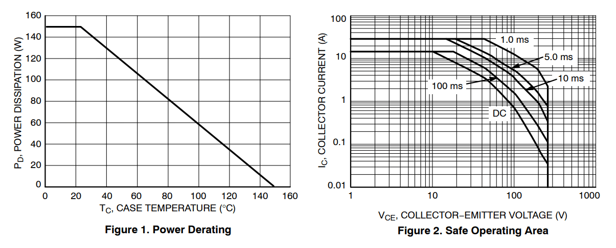

With adequate heat sinking roughly how may watts output for a single channel could a complementary pair (0281/0302) be safe running?

Refer to datasheet for SOA
plenty of more detailed math used for derating and thermal junctions
Depends on Voltage , Current and Case temperature
And there is Only so much thermal exchange between the actual Die to the case, then case to heatsink.
Or in other words without specific calculation, the case is always hotter than the heatsink, and the die is always hotter than
the case.
Fig 1 in Data sheet shows derating for case temp and keep in mind the actual die temp would be hotter.
Fig 2 shows how quickly the die or wire bond fails at 150c, depending on current / voltage
if you can maintain case temperature 60 to 100c then approx 60 to 100 watts
within reason at 80 to 100 volts @ 150c they fail at around 1 amp or less current.
way better than many vintage transistors where SOA at 150c would not be more than 30 to 40 volts.

The 150w bjts are fine for a pioneer sx-780 or equivalent
The 200w are used for higher supply voltage units or in cases where you want to drive lower impedance speakers or multiple pairs
Kits use toshiba 150w (2sa1943n/2sc5200n) for outputs and (ksa940/ksc2073) as drivers, instead of onsemi 150w devices since the toshiba parts have better stocking and shorter lead times

This is the specific amp I was talking about. It was a Fisher RS-2010 and used STK-0105 packs, but at some point in production must have switched to STK-0080 packs. He was replacing the STK-0080 packa using this same board made by the forum members here
It clearly only has space for a single complementary pair of outputs and he used the NJW3281/NJW1302 pair in that video. Was that a poor choice for 100w or am I reading what you said wrong?
But definitely using this board with the 0302/0281 pair in each channel for 100w isn’t a wise choice?

Just so I know, i have trouble interpreting those graphs. With adequate heat sinking and figuring on 35 to 50v rails how much power can I expect to safely get from a pair (one NPN and one PNP), two 150w devices. Could I safely get 75-80w? It was said above that the 200w 1302/3281 were made for 100w amplifiers and again I’m guessing that they are saying one pair (NPN/PNP) make 100w, so that’s one half the rating of the device. Going from the same thought would the 150w devices give me 75-80?

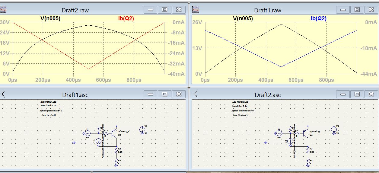

Please don't mix the 21194,21193 and the 0281,0302 options.
21193,4 are slow devices when 0281,0302, 3281,1302 are fast.
Using slow devices in place of fast you are looking for troubles...
I know this the hard way 😉

No, the 2119x and 3281-derivatives are not in general interchangeable. In the typical simplest circuit - an EF2, especially. The higher fT parts will result in audibly less crossover distortion, regardless of bias. But you can beat on the lower speed parts with less fear of retaliation (Burnout). It is just a matter of which one is more important to YOU. In class A operation where crossover artifacts are nonexistent, you will never be able to tell them apart listening. That’s why people can get away with sub 1 MHz hometaxial 3055’s making those cute little 10-20W class A amps. Rugged beats fast there, and a class A amp isn’t going to wait for you to turn it up to war volume before letting you know you don’t have enough SOA. You find out in about ten minutes of idling.
I have found that in EF3 configuration, high speed outputs are completely unnecessary. If the driver and pre driver are high speed and biased at sufficient current to be able to quickly suck all that charge out of a bank of 4 MHz outputs at switch-off.

The STK replacement is not an EF3. 4 MHz outputs will work well enough in an EF2, but measurements and many people’s ears say faster ones work better. In a poorly designed or executed circuit, other distortion mechanisms may be so bad it makes no difference.
The P3A has enough other limitations besides the speeds of the outputs that it may be a wash. CFPs often do no like for you to use transistors which are too fast (problems develop, like internal ringing).
How bad the crossover artifacts are when using slow output transistors depends on the GAIN in between them and the current source driving them. In an EF3, with fast drivers and predrivers, you have plenty of that gain. With sustained-beta drivers and 4MHz outputs in an EF2 there is often enough to get rid of the low level fuzz, but there is usually enough improvement with 20+ MHz outputs to be worthwhile. Stick crap-o 4MHz TIP drivers in there, and it’s bad enough to drive you from the room.
