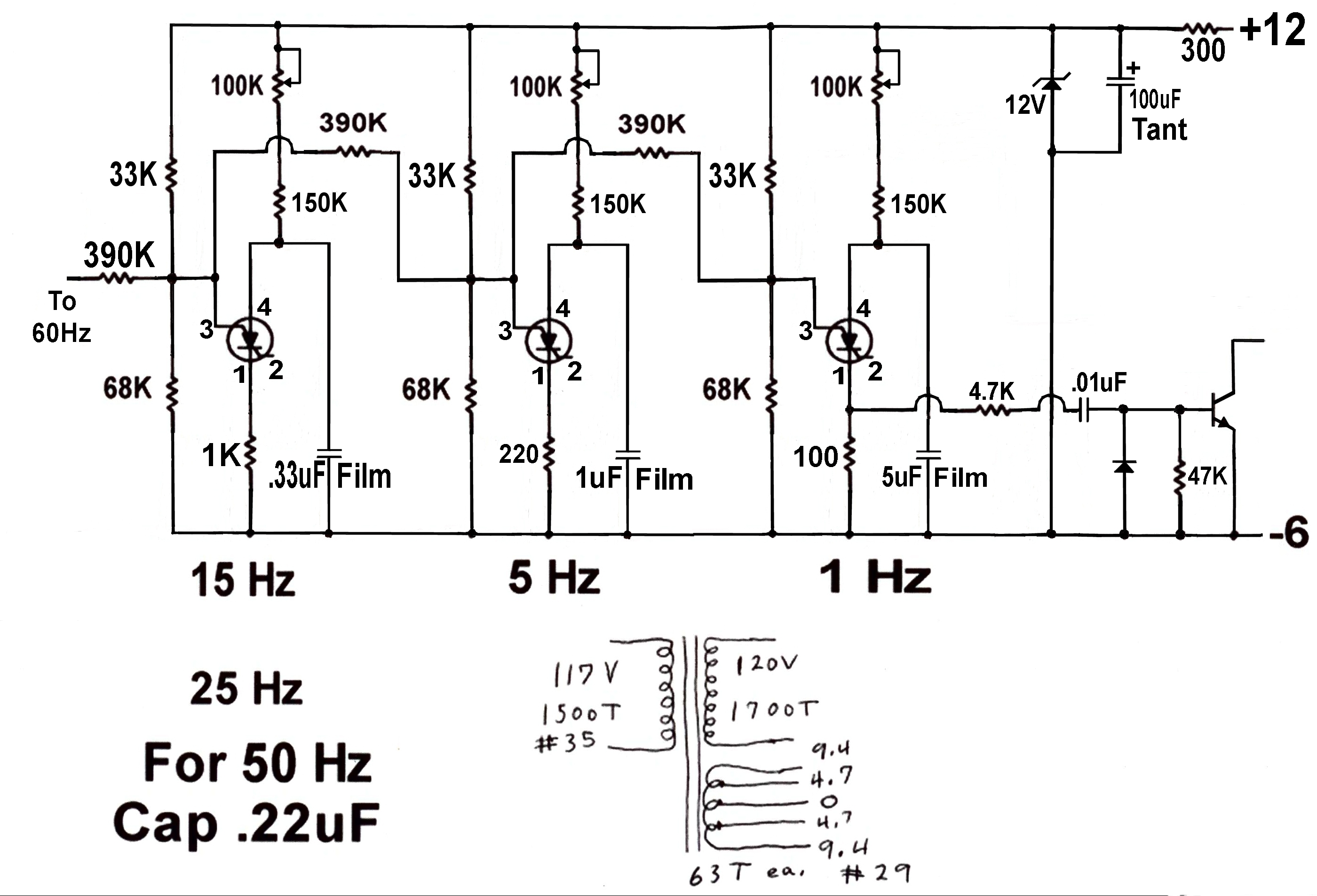

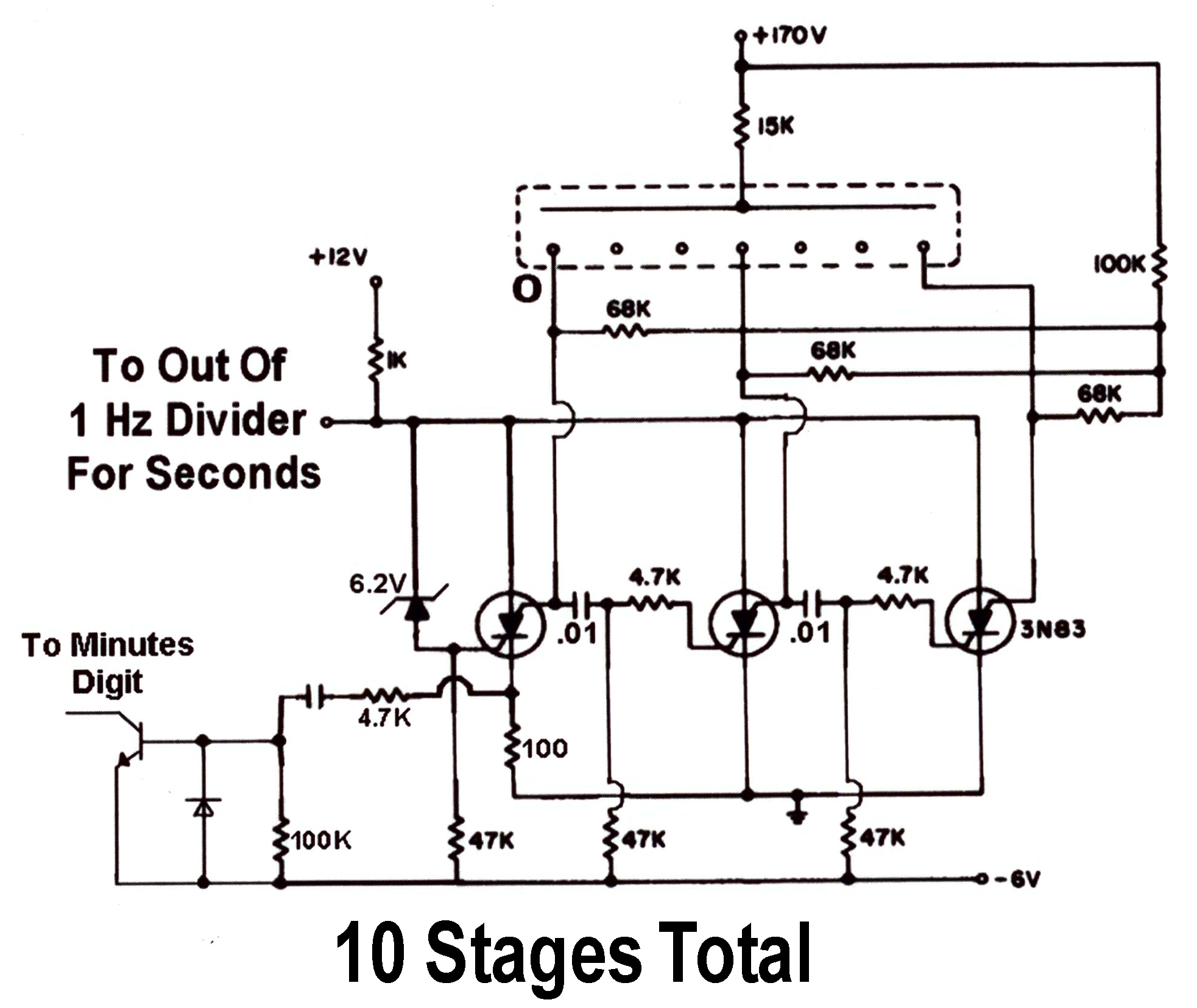

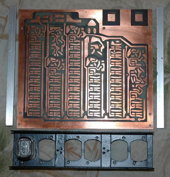

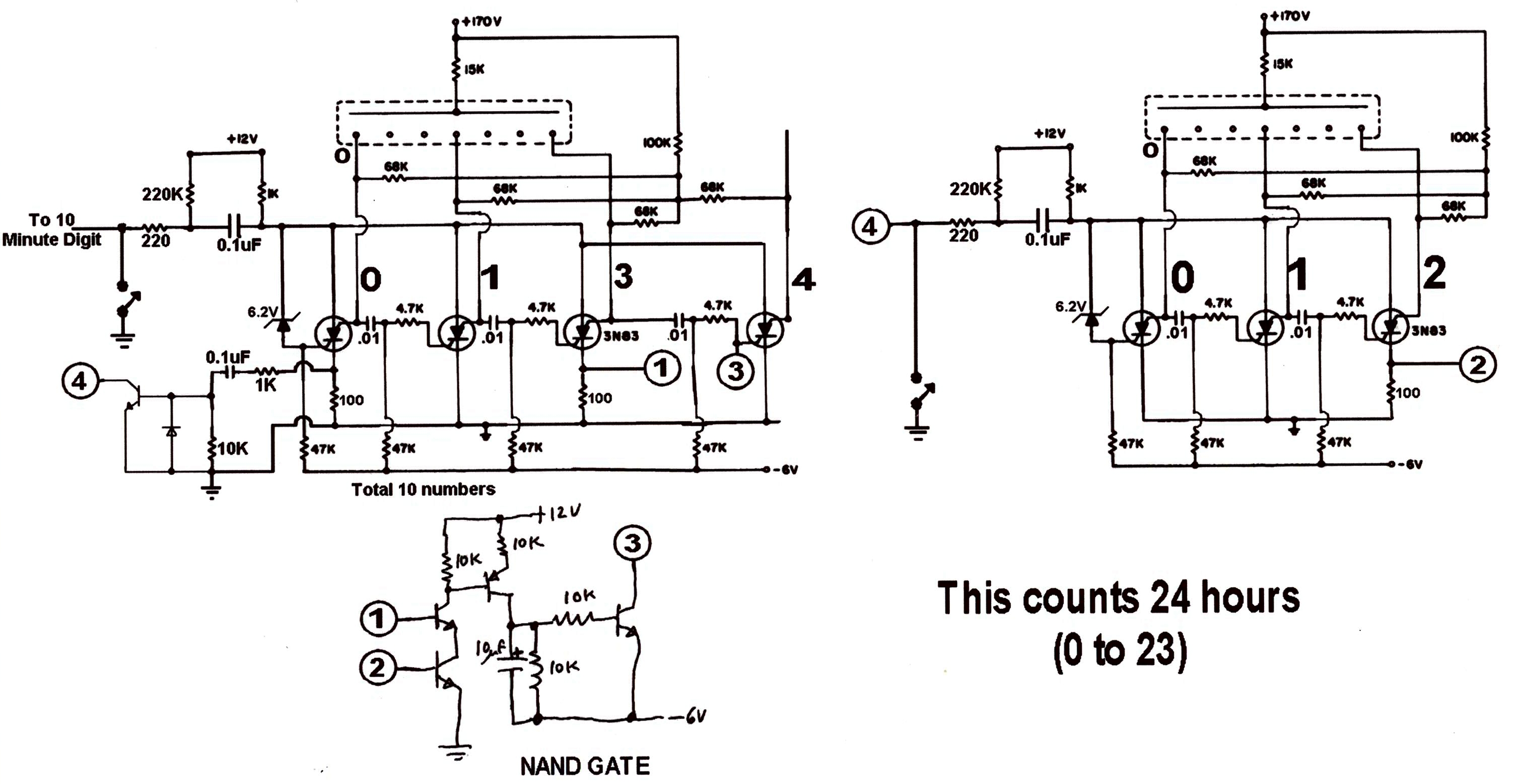

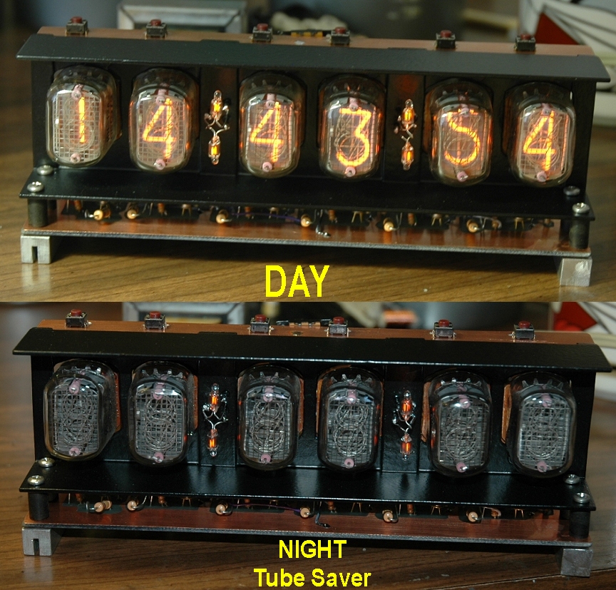

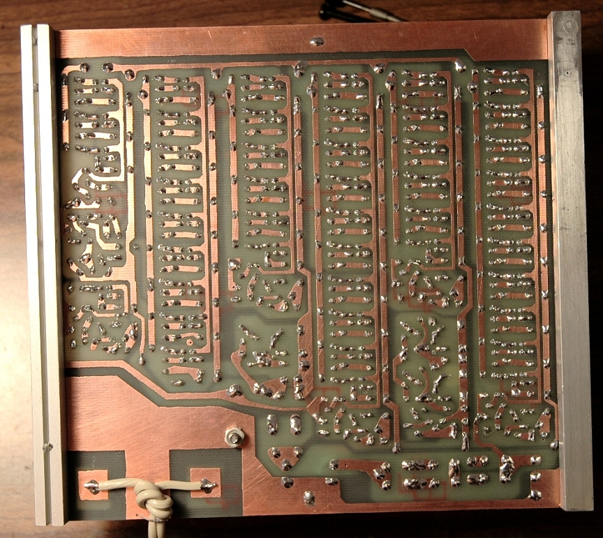

Finished Nixie Clock
I finished it many months ago.
