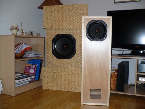

i want to built cabinets for my new super 12 Audio Nirvana.
help me for the size please. Open baffle or bass reflex ?
14" x 14" x 48 " too small ? 15" x 25 " x 48" OK

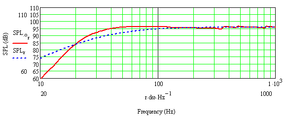

Like this kind of big: 1 MLTL for the AN Super12. 56in x 20in x 14.5in (HxWxD). Zdriver 23in. Vent 4in diameter, 0.75in long, as close to the base as possible. I rolled it off at the bottom, if you want max-flat, increase the vent diameter to 5in. Minimal damping needed -line the box with 1in acoustic fiberglass on opposite faces. Volume for this thing is just under 9.4 cubic feet if you don't want to do the math. They're pretty sensitive, so they should do OK for nearfield listening on a couple of watts before they breach Xmax.

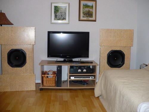

Most people can't live with a pair of cabinets of this size these days (they were more common in the 1950s - '60s than they are today), so a baffle will probably still end up as your best bet.
