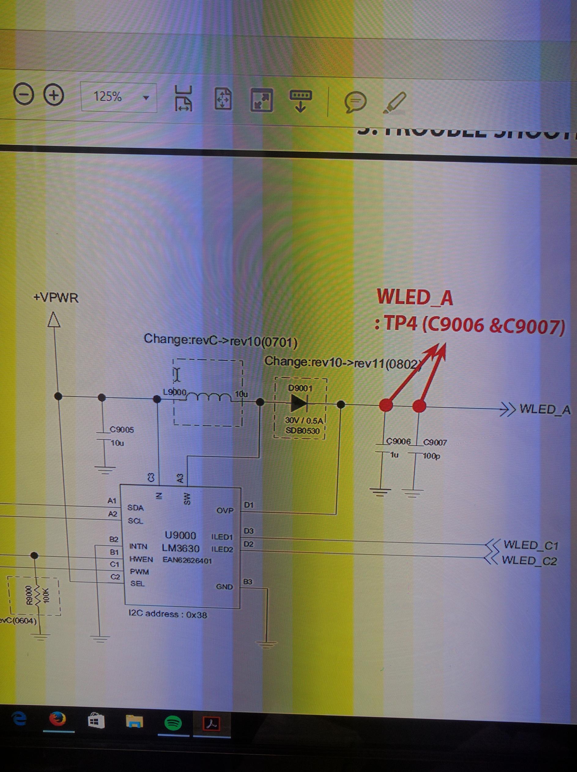

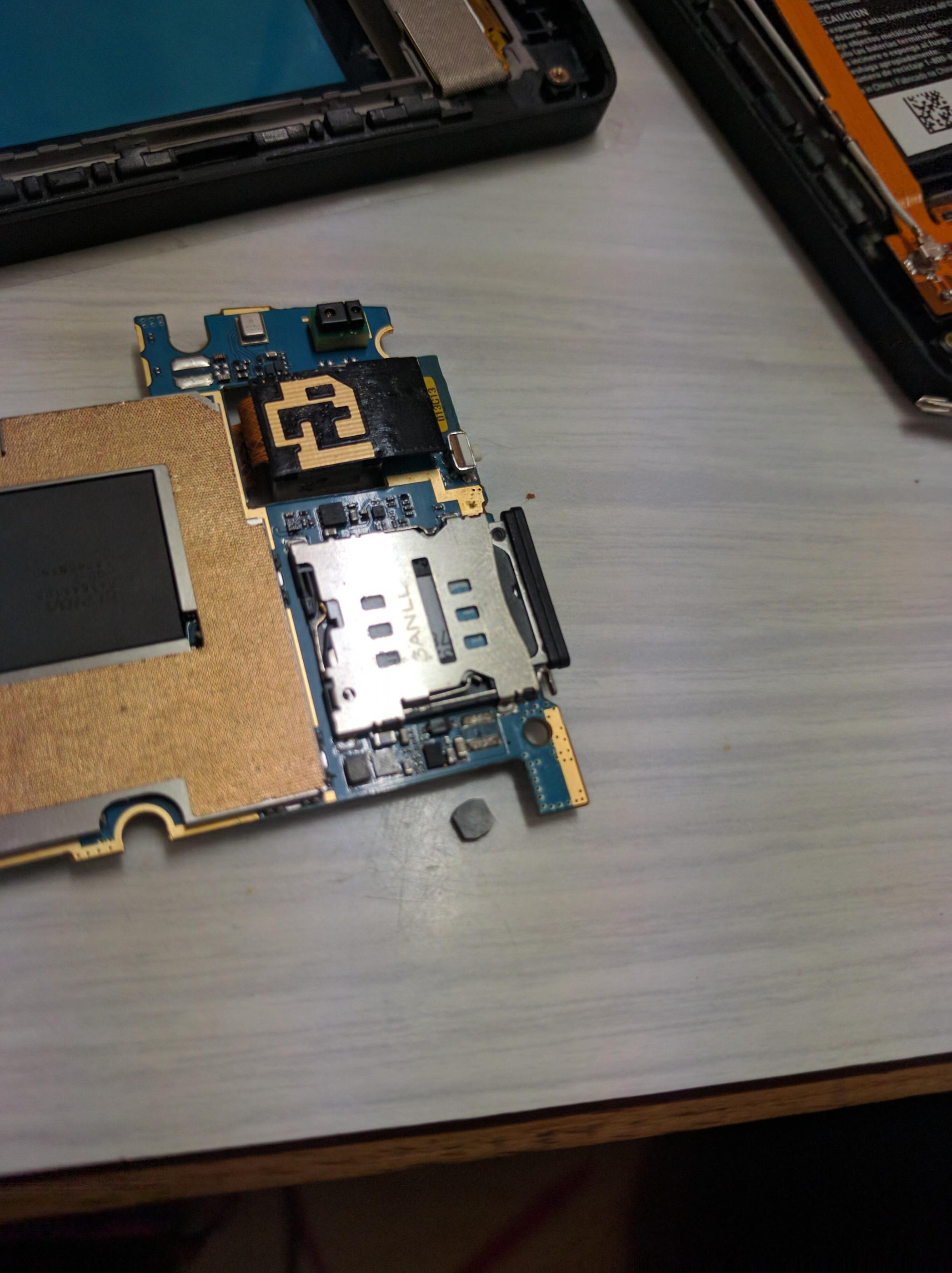

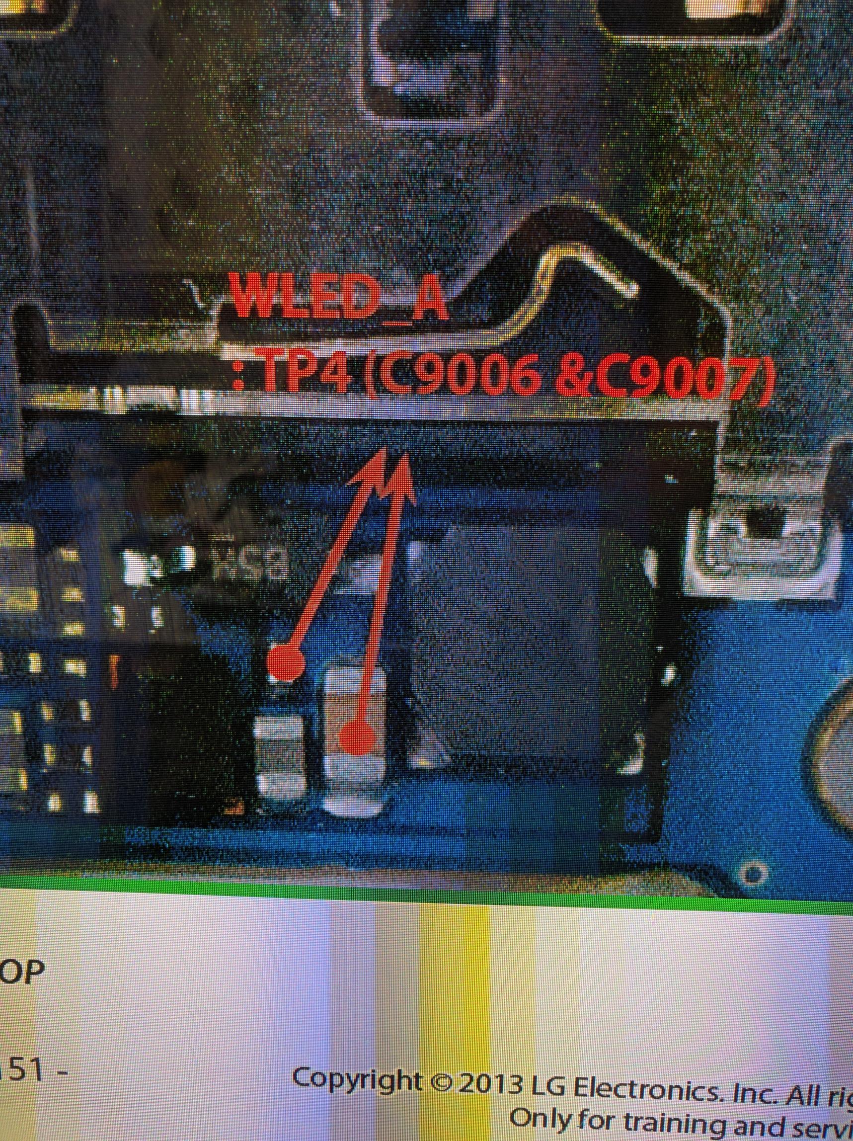

hi my nexus 5 mobile screen is black however the touch still works on it and also i can receive calls through it as well so i thought the flex cable and screen needed replaced so i did that however i still get the same problem, when i was checking over the board today a component was hanging off i have looked at the schematics and have narrowed it down to a coil under the name l9000 however if someone can check i am right i have provided pics below
Just wanted to see if anyone knows what it is
