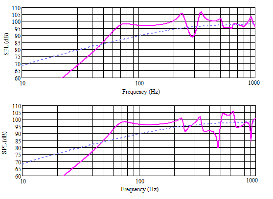

I've a question for Dr. Scottmoose and Planet10. Here's a 3 cubic foot exterior bulk BVR for Fostex 208/225 (and assume 206). RCA-Fan for whatever reason placed the driver low and "in the chamber". It probably ran as 2-way a horn on top.
What response impact (and why - if significant) might occur from moving the driver up to a position more favorable for single driver listening use other than the small increase of path distance between driver center and vent center?

The attached should give a rough idea; this isn't an exact sim (as you can see), but it's close enough for the purposes intended; in essence it shows the relative effects of altering the driver tap location in the chamber relative to the throat in approximately this box. Varies with design of course, but we're basically dealing with load to the throat which affects (to a point) the fundamental, but primarily the harmonics.
There was a thread over on the multiway forum, oh, probably about 18 months back now where I pointed out with some similar examples that the response of many chambered lines was compromised by poor throat location and / or driver tap position in the chamber.
thanks Scottmoose - I would use a removable baffle to allow flipping driver positions. Bill called these things "half horn" - maybe that term would apply if the stubby "horn" vent occupies ~ 50% of the cabinet's internal volume.
