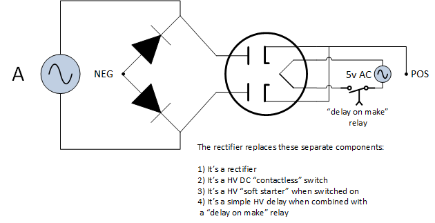

I hope I drew these schematics correctly and its not a stupid question. Which configuration makes the "best" hybrid bridge rectifier, A, B or C? I have a "hunch" of which I like best, but no science behind it. I found schematics in my stash to be varying.
A: NEG (diode/diode) - POS (tube/tube)
B: NEG (tube/tube) - POS (diode/diode)
C: NEG(tube/diode) - POS (tube/diode)
'A' is preferred because the two tubes can share the same heater supply, and you can use rectifier tubes with shared cathodes.

If you use a typical tube type power transformer with a center tapped HV winding AND you ground that CT to get a positive and negative supply for a tube amp, then A is the only useful choice. The Tubelab TSE operates this way, and you absolutely want that negative bias supply stable before the B+ comes up. Many DHT's like the 300B can begin to conduct within a few seconds of filament power application. They are faster than a 5AR4 or a damper diode. A SS rectified negative supply ensures that bias is applied to the grid before the B+ supply comes up to avoid an uncontrolled start up.

Thanks, been thinking about how to solve this timing problem in the cheapest way using that dual rectifier... When the amp is powered up, all the other tube filaments will be started and the bias will be present. But the filament to the rectifier would get a "delay on make" relay inserted into its 5v AC filament supply. This would make the rectifier behave like a "contactless" HV DC switch when the filament warms, no? Additionally the HV will reach the circuit "softly" as the filament warm-up time adds to the delay. That tube is replacing many components it seems!
Is there anything incorrect about this circuit? Do I need to tie the upper filament leg to the cathode maybe?
In a typical 5AR4 the heater is already connected to the cathode. In a 5Y3 or 5U4 the heater IS the cathode as they are directly heated. The 6BY5 does have two independent cathodes and an isolated heater with a 450 volt H-K rating so the cathodes can be at up to 450 volts of B+ while the 6.3V heater is grounded or lifted to some intermediate voltage that suits all the other tubes in the circuit. The 6BY5 was originally intended for an oddball TV design that used a PAIR of damper tubes. They were seen in some HiFi designs in the 1960's. Most individual damper tubes also have a fairly high H-K breakdown rating in one direction only.

I'm not so sure that the rectifier tube would like having all of the other tubes hot and ready to draw full current while its heater was slowly warming. I have never actually tried using the heater of the rectifier tube for a switch, or a time delay. What I have done is to use a mosfet in series with the ground side of the HV power supply (HV winding CT or negative side of the bridge). The drain of the fet gets tied to the CT or bridge, the source goes to ground, and the gate gets a PWM pulse train from a PIC chip or dual 555 timer. You power up with a zero pulse width which increases to 100% (5 volts DC) over the desired soft start time.
