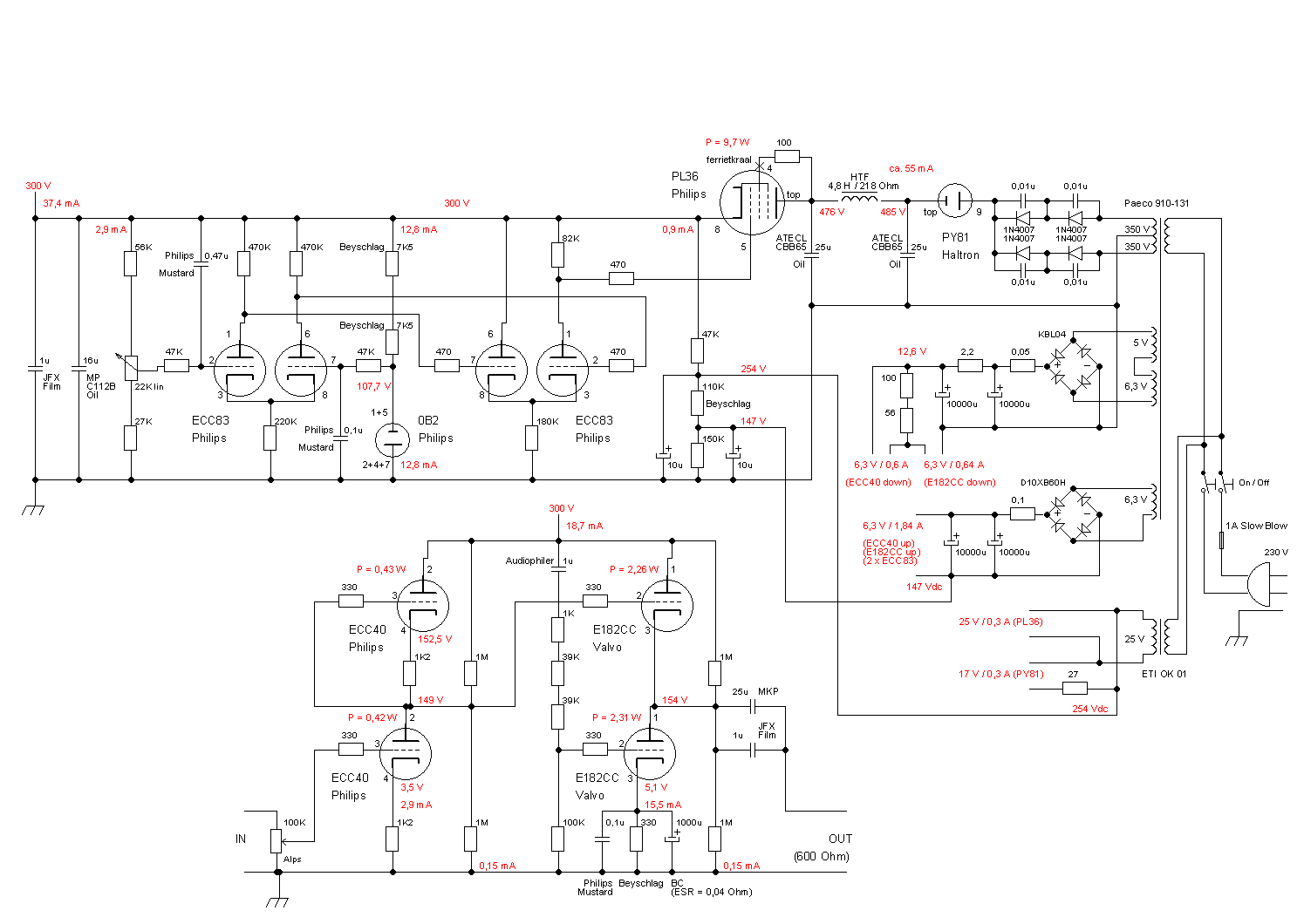

I use a PY81 damper diode between the full wave rectifier and the first capacitor as a delay in my Aikido headphones amp so that all the tubes (especially the tubes in the regulated power supply) are ready for action when the voltage comes on. The PY81 takes about 50 (old production) to 30 seconds (newer production) to conduct fully so it works very well as a delay.

I'm a bit surprised about what you wrote about the recommendation in datasheets of some damper diodes to let them warm up before current is being drawn from them. I never saw this recommandation before but ofcourse I didn't study the datasheets of all damper diodes.
Could you please mention a type for which this recommendation applies?

Apologies, I do not remember where I read it. (I've been looking all afternoon.) I remember that I came across it in some obscure location when I started last year to investigate the use of damper diodes for rectification / slow B+.I'm a bit surprised about what you wrote about the recommendation in datasheets of some damper diodes to let them warm up before current is being drawn from them. I never saw this recommandation before but ofcourse I didn't study the datasheets of all damper diodes.
It was either in Tomer or one of the many tube manuals. Basically it had to deal with that if the damper diode had to be fully heated up before full current was drawn by the rest of the circuit. (otherwise there was cathode stripping).
If the damper diode had a similar heating up time as the rest then it was not a problem. Many damper diodes like the 6CL3 are fast heat up (6CL3 is 11 seconds) which is similar to tubes like the EL84 / 7868 / EL506. The problem is when the damper diode is slow heat up.
Some rectifier tubes are specifically made for slow heat up and can withstand that. But quality NOS rectifier tubes are not cheap....
Thank you for your reaction.
Like I wrote, the PY81 damper diodes of early production (early fifties) had a heat up time of about 50 seconds. Because of that, the screen grid of the tube for horizontal deflection, which was the EL81/PL81 at that time in The Netherlands, had to be designed so that it could take/dissipate the B+ on it while the anode voltage was not there yet (for that the PY81 had to be functioning, so had to be heated up enough).
