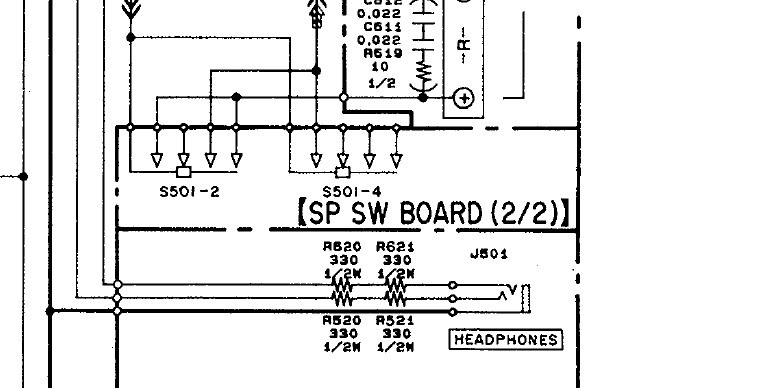

So, my attempt in a methodical test continues:
I've attached a speaker to all four outputs. BOTH left channels are significantly quieter than the right.
When attached speaker and plugged in the headphones sound continues out of the speaker AND the headphones (which seem to work evenly on both sides but it's difficult to make out).

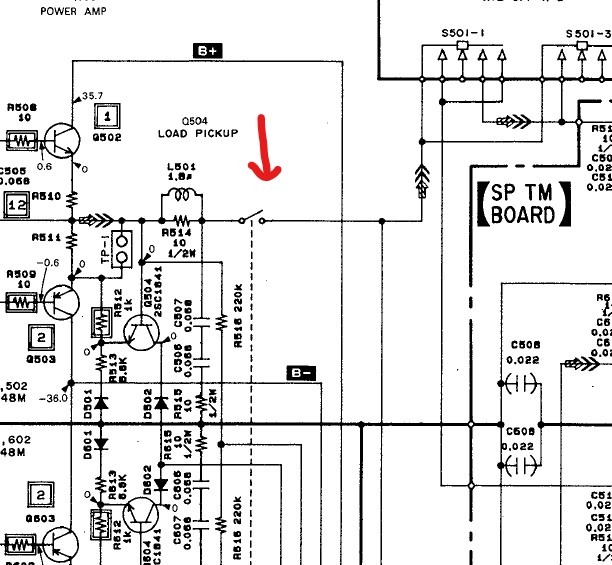

There is a speaker relay (so another mechanical switch contact) in the circuit. Low audio can be a classic symptom of tarnished contacts and occasionally will improve at least temporarily if played at much louder volumes. The higher currents can punch a way through any insulating film of oxidation.
Ideally we would use some test equipment to see where this was falling down (scope, signal generator etc) but I'm guessing you perhaps haven't got that available.
You could try bypassing the relay and switch combination to prove if there was an issue with these. This shows the relay. The path to the right goes to the speaker selector switch. By connecting the positive speaker lead to the left hand side of that relay contact would bypass all the switches.

The speaker relay is the black rectangular part to the left of those two large capacitors. You can temporarily connect a speaker before the relay by identifying the correct point on top of the board but it sounds like this might be beyond your comfort zone tbh :)
As a simple test a sharp tap on the relay while it is playing might show if there is a poor contact within it.

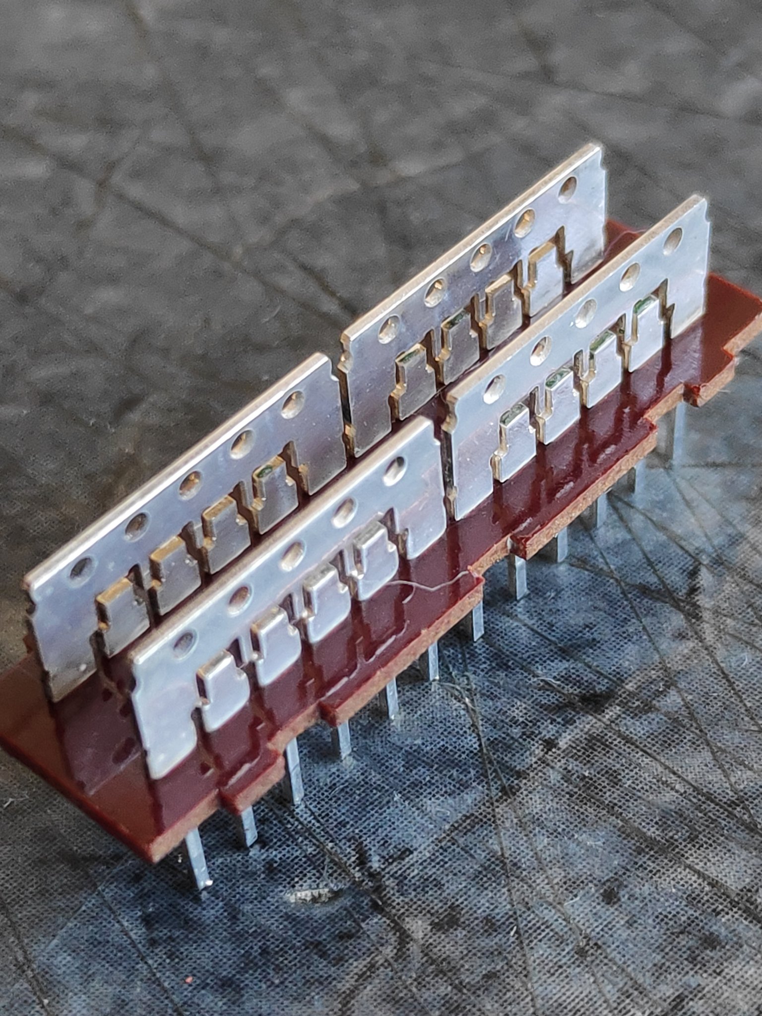

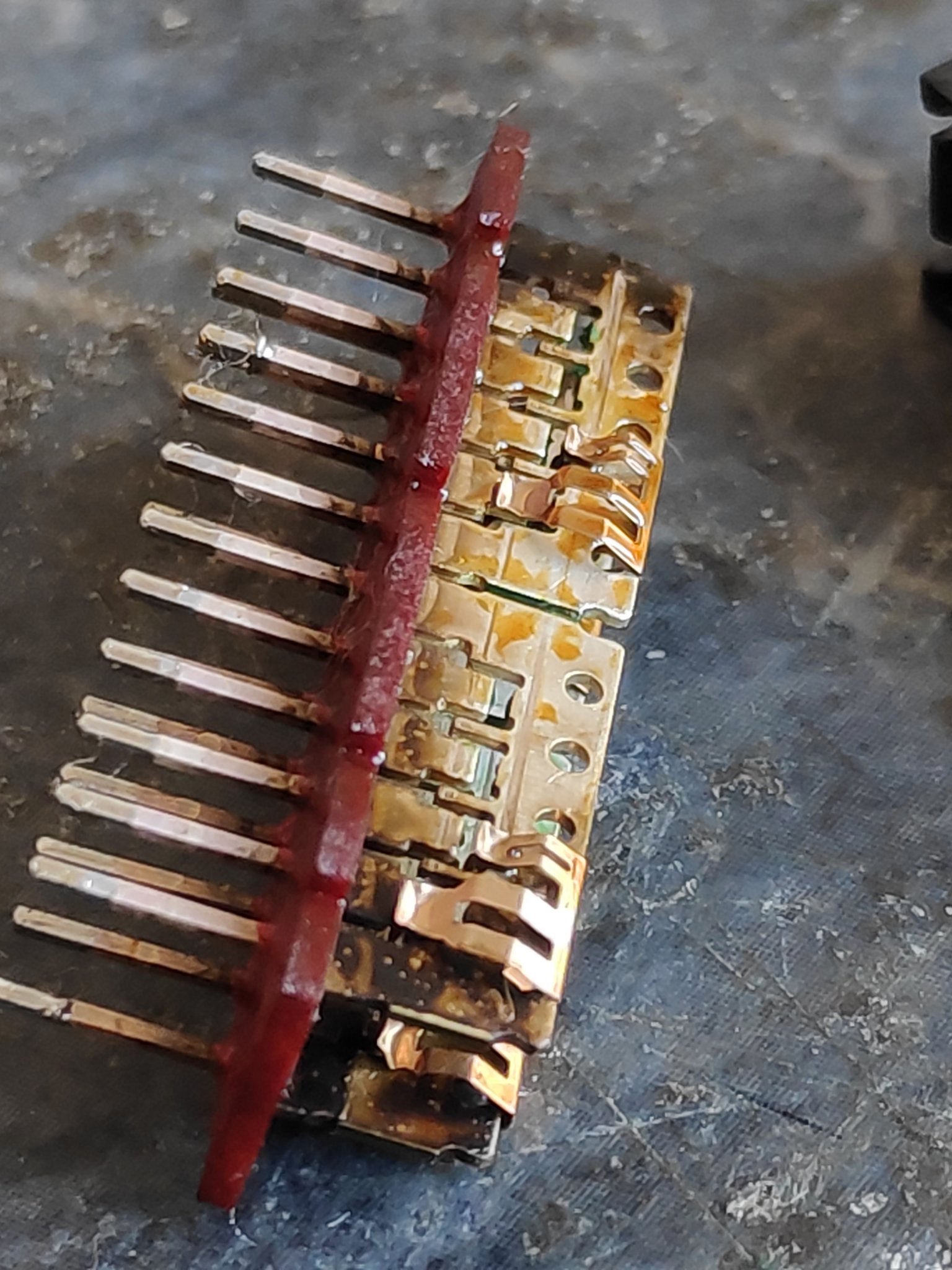

There's another set of likely tarnished contacts in the input selector switch - the 2 blue parts in your photo. The bottom blue part is the switch control on the front panel of the amp, that contains no contacts at all, just the mechanics to operate the metal slide connecting the 2 parts of the switch. The contacts themselves are buried in the right-hand (blue) pcb mounted slide switch, and unfortunately, are a b**** to get to. To clean them properly, the switch really needs to be removed from the pcb, dismantled, cleaned, and rebuilt. Unfortunately, Sony had a thing about this type of switch for a few years... and they're all obsolete now, so proceed with caution.
This is the inside of a similar Sony remote slide switch from one of my own amps, before & after cleaning - the small brass coloured 'slides' are very delicate.
