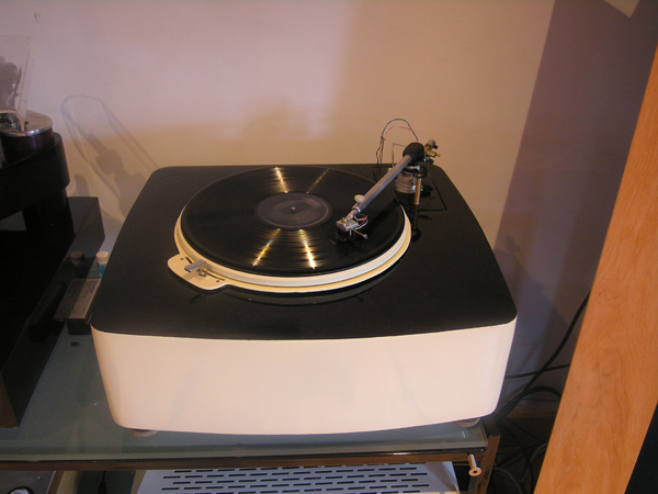

I haver a modded L75 and its a great deck. Well up there with the best of them, rock solid bass, no rumble etc etc.
There is a bit of work in getting them going really nicely, but its well within the DIY capabilities of most.
I'd say sit it out for a L75 or 76. See example:

The one shown below is my table

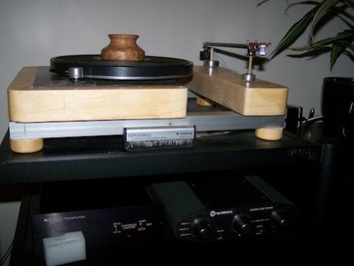

I continue to be perturbed by the cost of some "classic" tables, given the state they are often in, to the point that I have designed a couple, re-plinthed a couple and am contemplating an all new idler construction turntable as a commercially viable product.
Attached is a picture of a re-plinthed Sugden Connoisseur, and an arm of my own design and construction, proof that one need not spend a load of $$$ to get something that sounds very good. Arm is comparable to my SME 309 (magnesium version)... table is comparable to my old Oracle...

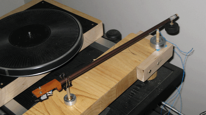

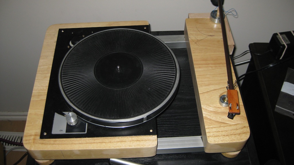

My TT is a Sugden BD1 in a new plinth, and my "Nanook's $2.19 tonearm". Do a search, I've posted a bunch. of information and pictures. Even the re-plinth has been posted. I've changed the design slightly for ease of manufacturing, and am contemplating a major revision. I've retained belt drive, but use a tough knotted nylon thread as a belt.
The tubing is Easton (arrow shaft). This tubing is typically in the 70-90 ksi yield strength range, and is veery light. The headshell is a Yamamoto inspired one made by someone else. If it seems I'm being a little vague, I am. I am contemplating making a commercial version....but priced very modestly. Please note: this tubing is very brittle, and cannot be bent. Any changes to the shape of the arm have to accomplished by other means. I've changed the design slightly for ease of manufacturing, and am contemplating a major revision. The uni-pivot bearing is perhaps amongst the very best available at a very reasonable cost. Rather than spell out a recipe for the arm, I encourage you to PM me. This particular arm is 330mm in effective length, and is set up for 15mm O/H. Th picture shows a brutally crude arm rest, but that is being altered as well.

Attached is a picture of the arm, hopefully large enough to see some details., and another larger over-view of the table. The hard drive in my 20 inch iMac died this past week and I've lost everything, but as required, I've been taking photos...

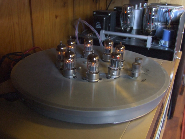

I found a Lenco 75 at a thrift shop and got it for $40.- To my surprise, I liked my old Pioneer LP12 better and ended up using the Lenco's platter for my phono preamp
That is a very hefty aluminimum chassis.
After too many years my trusty Pioneer died, and now I have a (modified) Project rpm5, which is an upgrade and very good for the price.
Heres a pic of the Lenco-preamp:
