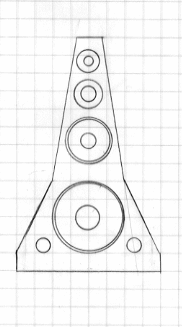

First build for me.
-Room is 20’ x 20’ and open to rest of home. 10’ ceiling.
-Looking to build a 3 way speaker. If possible with a 10-12” woofer.
-I want lots of detail. As much detail as I had in my jbl and KRK studio monitors if possible.
-Ideally should have a very wide sweet spot. Ok to put 12” woofers in separate boxes and have 4 smaller speakers if necessary for wider coverage.
-It’s ok if the speaker is power hungry, but would like the bass to kick me in the chest. I’d rather not add a sub. I’ll get a dedicated Crown class d amp if necessary.
Budget - $650? I don’t want to pay double for 5% improvement, but will spend more if necessary. I want bang for my buck.

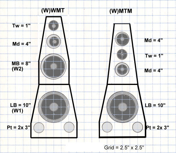

This isn't exactly a design, more of a design idea, but feel free to steal it -
This is actually two separate design concepts. On the left a 3.5-way, on the right, a straight forward 3-way.
This is from this thread -
The HALF-WAY House ...er...Speaker
Though again, more of a concept than a design.
The speakers, depending on budget, could be Dayton Classic, or Dayton Reference.
Note the 10" woofer in the separate cabinet is not a Subwoofer, just a woofer. Though if you design it right you could use a Subwoofer driver. The Crossover for the 10" Bass driver in the case of the 3.5-way would be very low. In the case of the 3-way (on the right) a Sub-Driver might not work as the crossover is likely in the 500hz range.

Though probably not worth much as it is also not a complete design, here is roughly the same design in a single cabinet.
For what little it might be worth.
Steve/bluewizard
