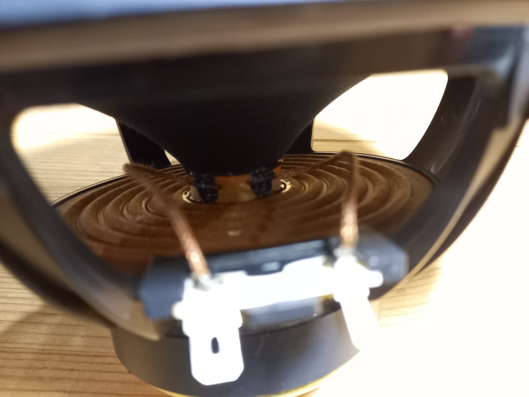

Here's a picture of the only spot I can see there is a bit less glue:

Has the currugated rear suspension (the spider) become detached from the cone/voice coil assembly?

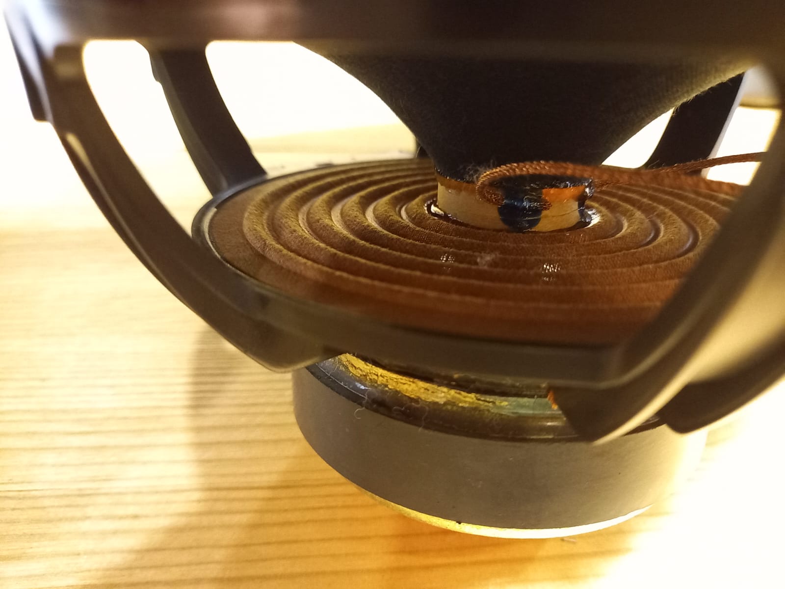

Perhaps more photos (and not taken so close up) would help.

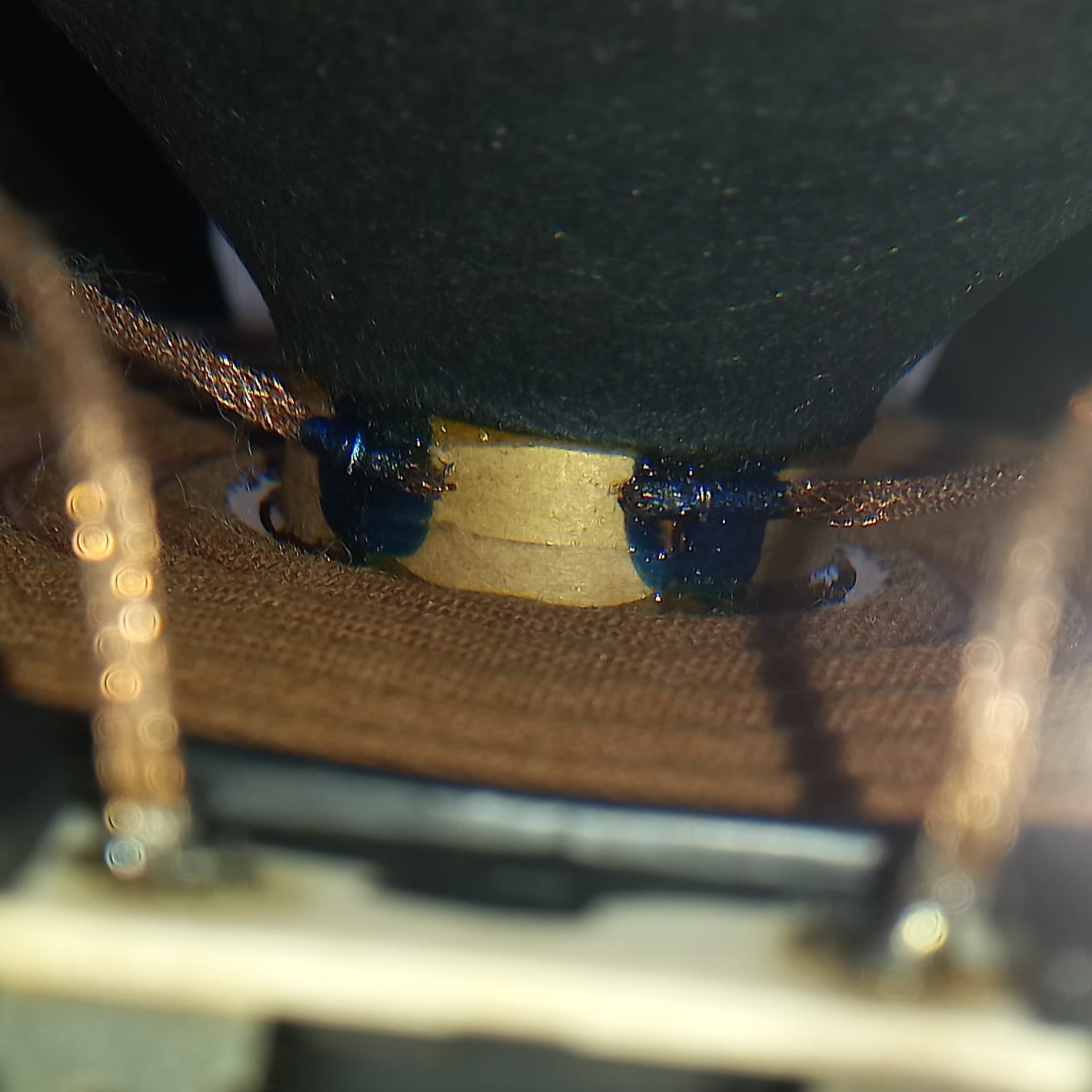

Thanks, those photos are clearer and I can see the spider is attached.
I suppose there could be an intermittent connection where a tinsel wire is soldered to the voice coil wire on the voice coil former.
Well if that's the case I don't think I will be able to resolder that connection without damaging the cone...
The joints are covered in some sort of blue paint...
