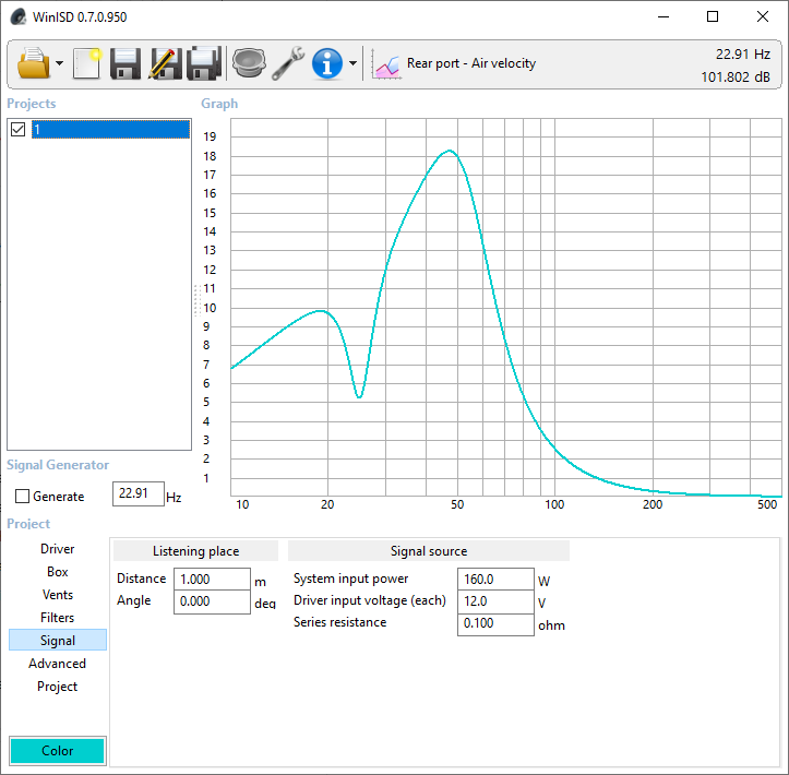

Adding more drivers will only raise SPL. It won't let you deeper. The 6th order bandpass I showed reaches just below 40Hz.
You can tune them a little lower, but they will lose SPL dramatically due to limited xmax.

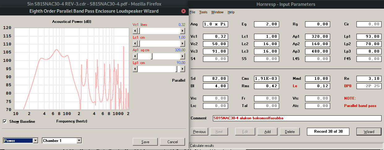

With four SB15NAC30-4 in a 8th order bandpass you will get force cancellation due to opposed drivers and distortion cancellation due to drivers working push pull.
The 8th order bandpass alignment will very effectively low pass filter out a lot of driver noise and distortion for a very clean bass reproduction. The large exit mouth will keep the air velocity down to very reasonable levels and the midbass peak will add a much needed "punch" to the bandpass alignment.
1200 x 1136 x 196 mm if build of 18 mm plywood.
Great efficiency for a very flat "behind the sofa" subwoofer with 30 Hz response.

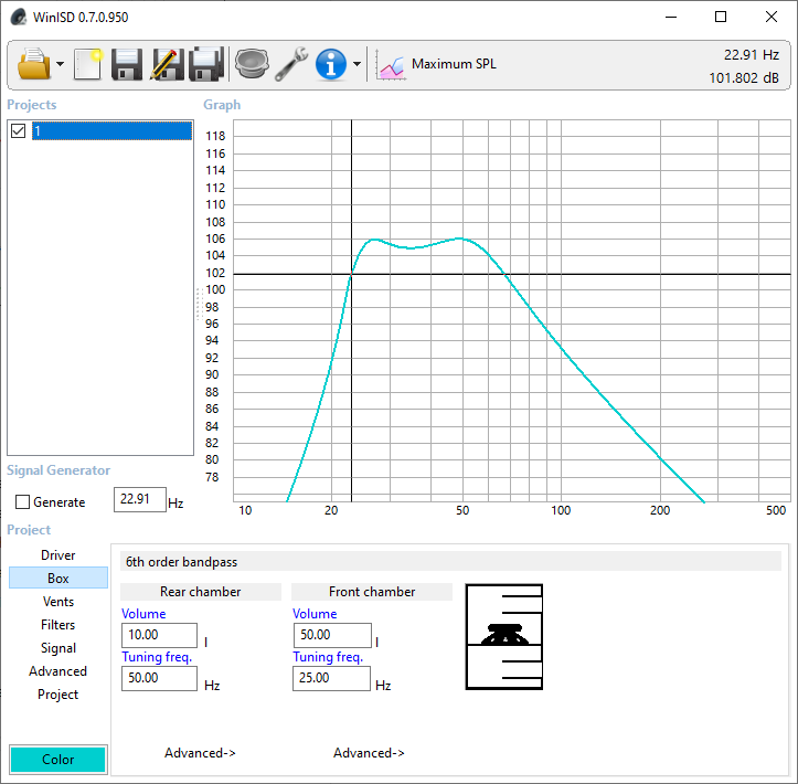

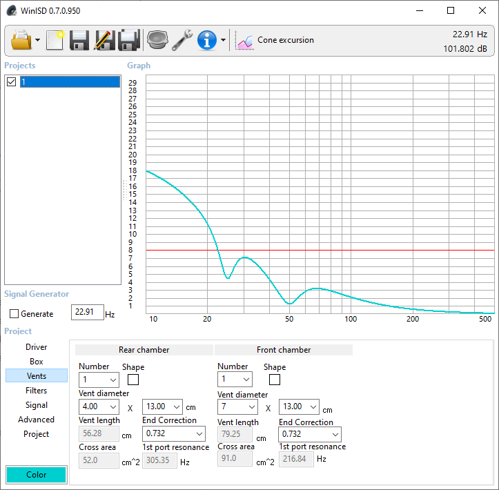

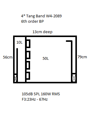

Before you scrap your plan. Tang Band has a 4" beast too:
Tang Band W4-2089 - 4" Woofer
fs = 35 Hz easy to tune lower; like f3 = 23 Hz.
And a 8 mm xmax for more power.
They are 13cm wide, so if you fit them tightly between walls, the enclosure will be 17cm deep
Make them fire to the front at the bottom, beneath the sofa.
