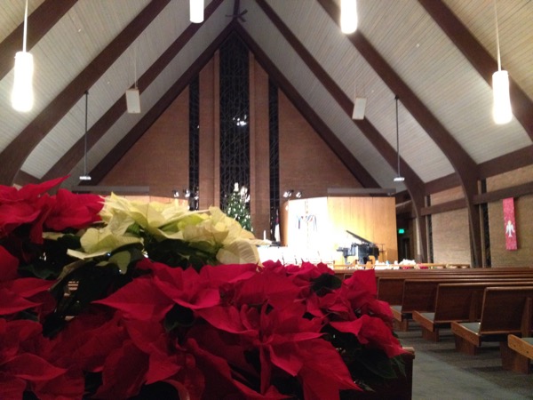

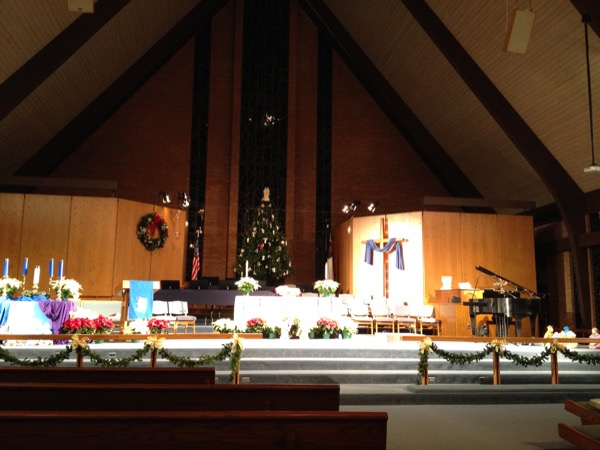

There are other considerations as well, such as the room, which is very large, and the location of the speakers once they are installed. (See attached pictures)
The speakers will live up on top of the large wooden rooms that flank both sides of the altar. There is roughly 12x12' of space on each side for all the speakers to live.
