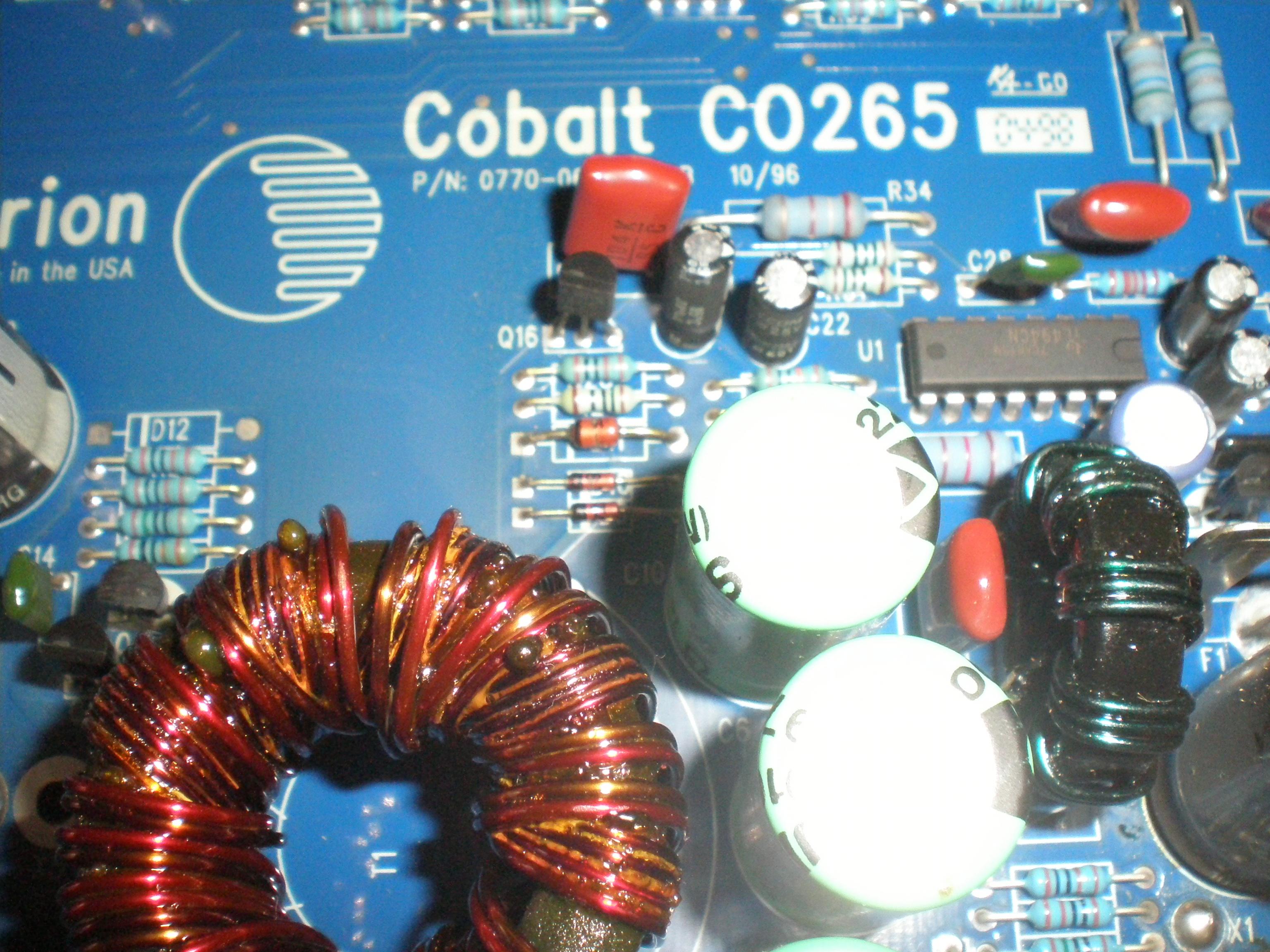

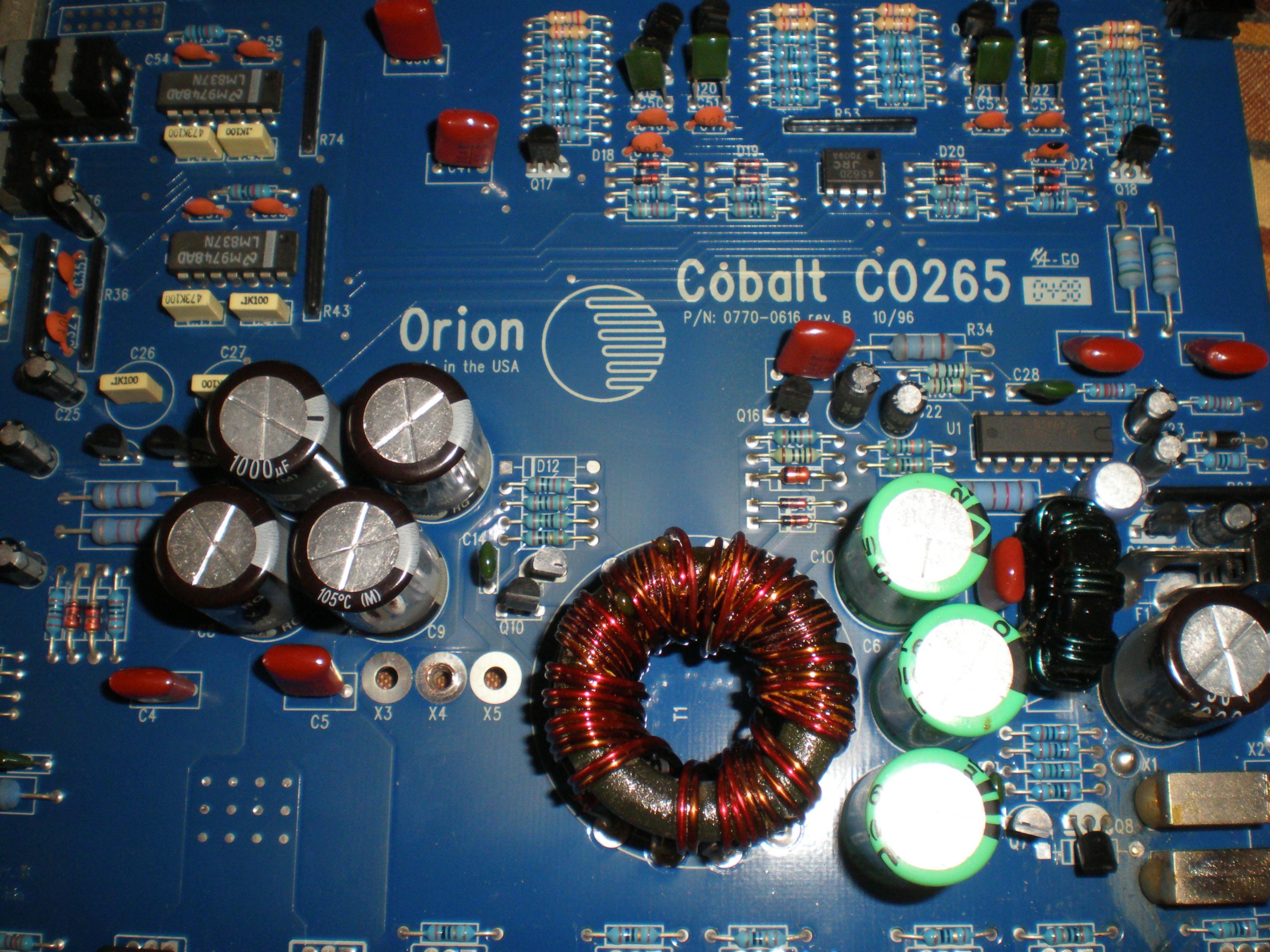

I took an ohm reading between the grd (-) terminal and the B+ (+) terminal. The result was continuity and the OHM was 4.9-5 Ohms.
These are quick pics. I can take more detailed as needed.
Thanks,
Matt
Thanks,
Matt
Is the brown cap leaking or did something just get spilled on the board?
Power supply has likely failed due to an output transistor failure.
It doesnt look like it leaked but I can not be 100%. Can I test the cap while still on the board? I have a good meter that tests caps.
Matt
I have been examining various components. The vertical inductor near the fuse reads low ohms (.8). Should it read high or low resistance. The large horizontal to the left (t1) reads quite high, assuming I am testing the 8 leads correctly. (188-189) across the 4 pairs.

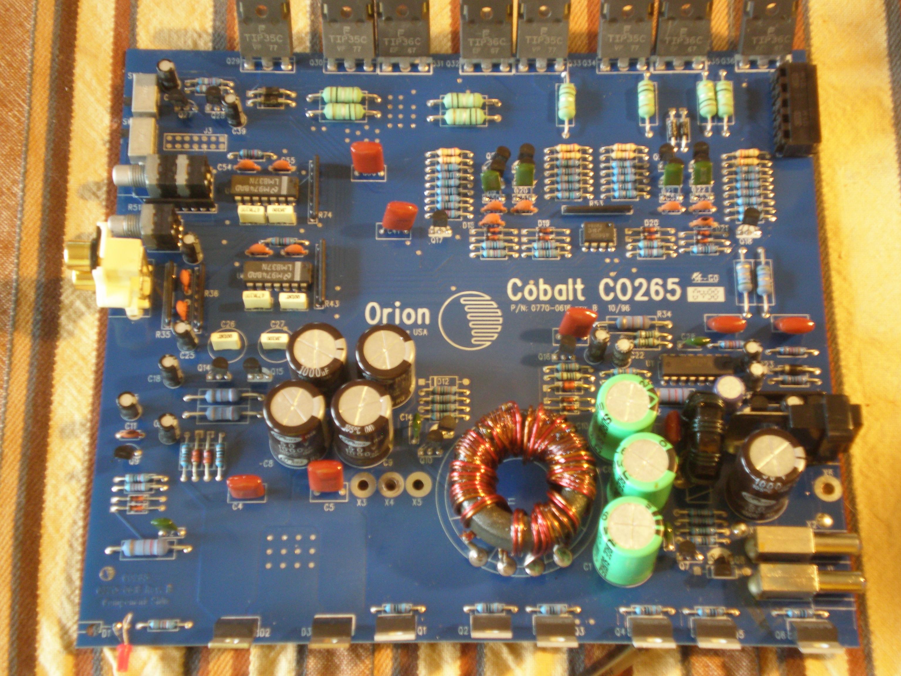

Progress update. Issue located
Well I think I found at least one issue.
I used a power supply and 7.5a fuse slowly bringing up the power to the amp. One of the power supply FET's got hot immediately
Fairchild NDP7060 seems to be the part #. I also checked the gate resistor and it tested good.
Datasheetcatalog had the specs for it so I hope to match it to a readily available one.
Is there anything else I should test? Even though it was the only one that heated up I fear something else may be afoot.
