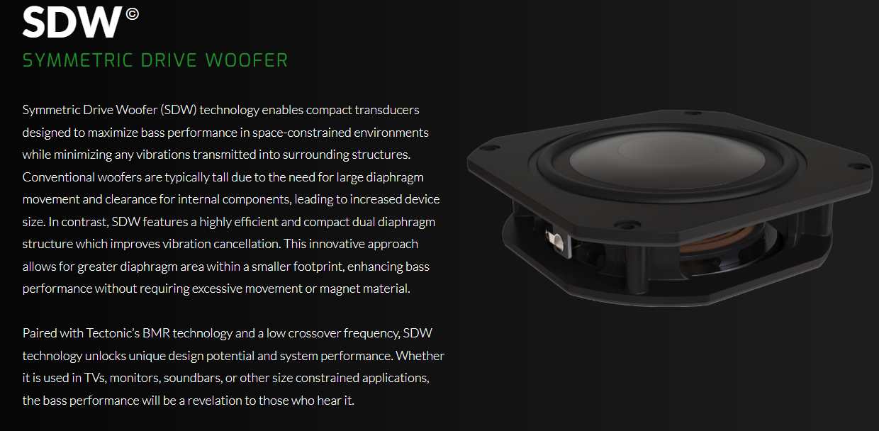

I seem to have missed where they mention the relative movement between the cones.
From their technology page:
"Symmetric Drive Woofer (SDW) technology enables compact transducers designed to maximize bass performance in space-constrained environments while minimizing any vibrations transmitted into surrounding structures. Conventional woofers are typically tall due to the need for large diaphragm movement and clearance for internal components, leading to increased device size. In contrast, SDW features a highly efficient and compact dual diaphragm structure which improves vibration cancellation. This innovative approach allows for greater diaphragm area within a smaller footprint, enhancing bass performance without requiring excessive movement or magnet material.
Paired with Tectonic’s BMR technology and a low crossover frequency, SDW technology unlocks unique design potential and system performance. Whether it is used in TVs, monitors, soundbars, or other size constrained applications, the bass performance will be a revelation to those who hear it."
