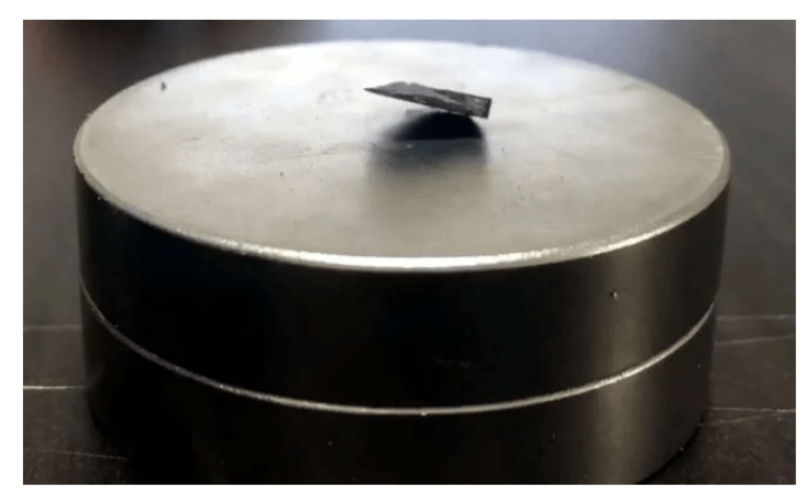

Extraordinary claims require extraordinary evidence, as the saying goes. So far there is no replication neither strong evidence towards this substance being a superconductor.
First, actual resistivity as shown in the research data is larger than resistivity of copper:
Secong, "semi-levitation" is replicated using ordinary diamagnetic, a piece of pyrolytic graphite:

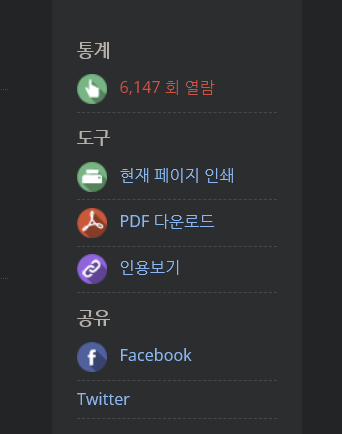

If someone wish to take a deeper dive, here is open acess paper:
https://www.kci.go.kr/kciportal/landing/article.kci?arti_id=ART002955269
(click "Download PDF" button on the right)
