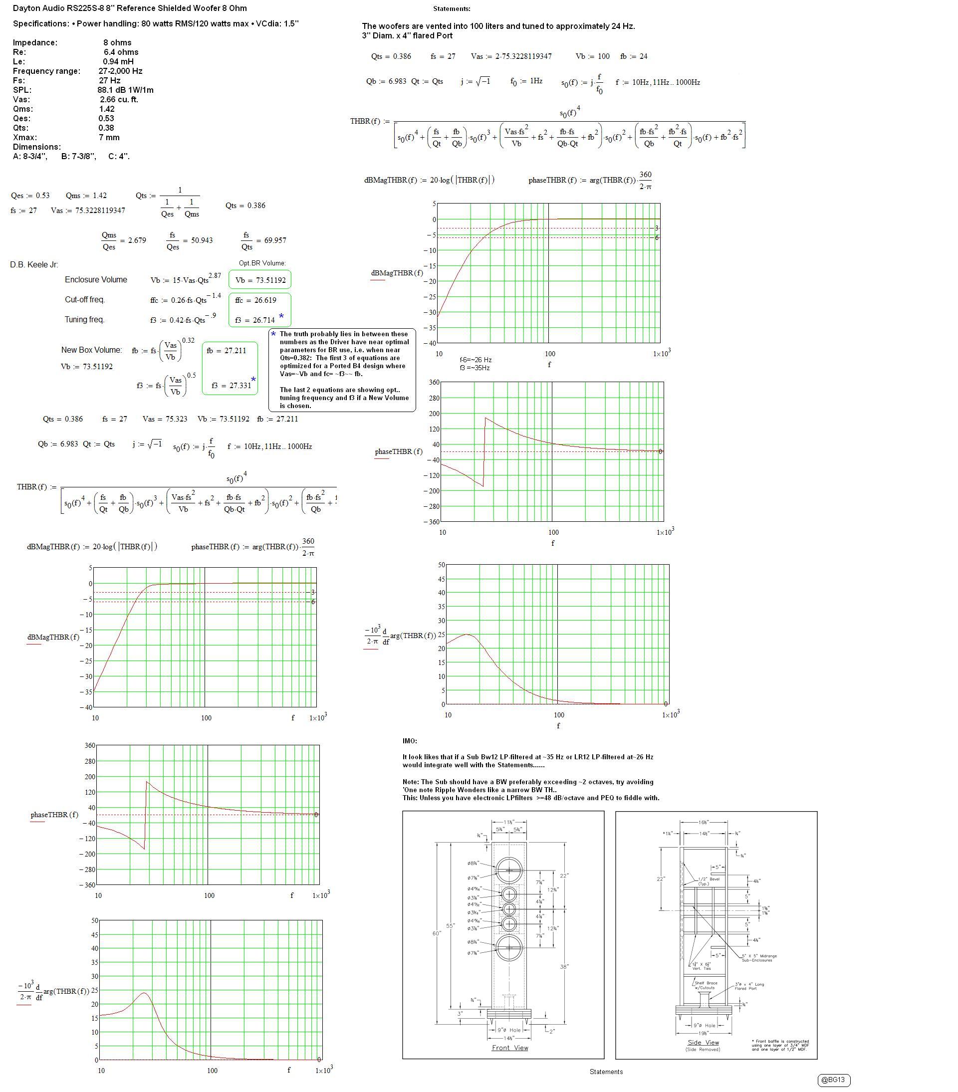

The midrange in the Statements is a
Dayton Audio RS225S-8 8" Reference Shielded Woofer 8 Ohm
Specifications: • Power handling: 80 watts RMS/120 watts max • VCdia: 1.5" • Le: 0.94 mH • Impedance: 8 ohms • Re: 6.4 ohms • Frequency range: 27-2,000 Hz • Fs: 27 Hz • SPL: 88.1 dB 1W/1m • Vas: 2.66 cu. ft. • Qms: 1.42 • Qes: 0.53 • Qts: 0.38 • Xmax: 7 mm • Dimensions: A: 8-3/4", B: 7-3/8", C: 4".
so I was thinking of a sub that will be 10Hz to 27Hz
like 2 x 15 inch one facing front and one facing floor
need design plans and details ??
Any thoughts ?

That's the Fs of the woofer in free air, or mounted on a baffle for testing. Inside your cabinet, plus there is a second woofer, the system response will change.
You'd need measurements of your current setup, or an idea of what the speakers are capable of But I don't think only having a subwoofer play under 27Hz is a good idea with main speakers with 8" woofers...
And unless you NEED 10Hz, I'd forget that idea all together. My 18" build seen here does have SOME 10hz output, but it's not a lot. And this is a large amp and driver, and it's not really a tiny box either....

You didn't need to start a new thread, I asked your goals in the other thread. Is this for music? For home theater and movie sound effects? What SPL are you looking to achieve and at what distance? (How far is the listening position from your subwoofer)
What size limits are you placing on this subwoofer build?
Those are just some of the questions which are necessary before you even think about a build!

Hi Wavelight,
Good idea to add a (A single ?) suitable sub if very demanding HT records are in use, but I find your request of a Sub with 'one facing front and one facing floor' very odd and Lemon-scented with wishful thinking.
At what SPL's do you expect the Sub should survive?

OK noted this will be for Music - Jazz / World Music / Classical
some home theater and movie effects
as for the SPL = the listening distance will apron 10 to 12 ft - what SPL , that I am not sure of , they do say the bigger the better
Curt - the guy who designed the "Statements " did say even though he is not a sub guy - the more the better with subs - therefore may be I do 2 x 12 in for the best effect - as I will be running a NAD T747 7.1 receiver 2 subs would give a great effect for movies - and perhaps turn them off for lighter listening - YTP
You would be wrong.
I highly doubt the statements give you solid 30hz output...unless we are talking about very low SPL
