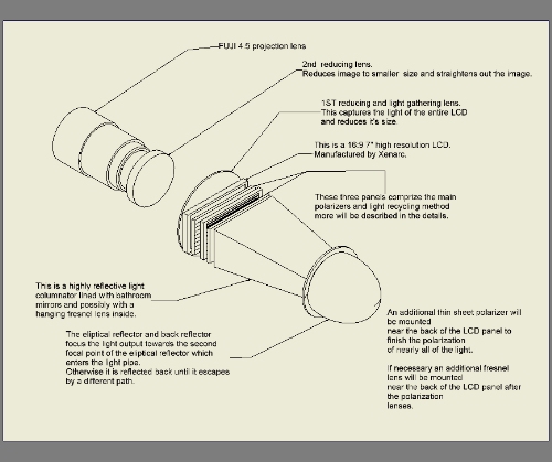

Xenarc 7" 16:9 LCD resolution
Xenarc says that this little LCD monitor can do something like 1280 x 7XX but a closer inspection shows that the native resolution of the panel is 800 x 480. Not near HDTV but still nearly as good as were going to get unless we use a 17" 16:10 display. If we use a 4:3 high rez monitor half of the vertical resolution is wasted on 16:9 DVD playback images.
The Xenarc is around 450 -499 USD and has it's own built in controller. How well it will adapt to thhis use I don't know but I'm prepared to mount the controller on any side necessary to get the LCD oriented correctly.
I still think this is a good size compromize as higher resolution LCD's of this size might become more available in the next couple of years.
The only possible way to get really good rez and contrast is to shine polarized light through the LCD.
I think this is a better design solution than the brute force one of using a giant light source.

Re: Xenarc 7" 16:9 LCD resolution
First of all, that's absolutely not true at all. You'll lose about 30% of the horizontal resolution with a 3:4 panel cropped down to 16:9. If you have an 800x600 panel, you'll lose maybe 50 pixels or so (if any) on anamorphic DVDs, and you won't lose a thing with a 1024x768 panel.
Don't confuse 16:9 with 2.35:1 "panaramic" widescreen. 2.35:1 films are still encoded at 16:9 and still have black bars on the top and bottom. There is no such thing as 2.35:1 video without letterboxing.
$450 is too much. If it were under $300, then I might consider it a decent deal, provided that the contrast ratio was at LEAST 300:1 and the response time is under 50ms.
As of now, I have yet to see a small widescreen LCD have anything beneficial over a high-res 3:4 screen.

Correction. You'll only lose about 26% of the horizontal pixels when viewing 16:9 on a 3:4 display. I think an 800x600 panel will fit the whole thing w/o any pixel loss.
There's also a major concern w/ that design. Unless you using a very weak bulb (which in itself would be a problem) you'll burn a hole through the LCD, as there is not even any breathing room for the lamp, let alone any airflow to cool it.
Honestly, w/ high-contrast XGA 15" moniters at $250 and less, I don't see the practicality of going with a non-fresnel/small panel design anymore. These projects were great 6 months or a year ago, but the lowered cost of LCD moniters (that of course all have built in controllers) make these fresneless projects seem like a bad idea. I'm not trying to be negative 🙂)even though I always shoot people down in all of these 7" widescreen forums). It's just that you get a MUCH better image and you don't have to worry about hotspots or elliptical reflectors. Only disadvantage is you have a bigger box- but that's probably a good thing as far as heat management goes.
If you get your hands on a small LCD (w/ controller) for less than $50, then I'd go for it. Otherwise, I'd either get an Nview Spectrah C (no work involved) or an NEC 1545 (work involved but 3 times better res and contrast). I have the latter, and I watch everything in widescreen with no complaints whatsoever.

Response
I did not actually calculate the pixel loss but when I play back widescreen DVD's on my 4:3 monitor the vertical size is a little less than half of the vertical size of the monitor. This is done with PowerDVD. I don't know that I have any anamorphic DVD's or not as I just got into this DVD thing but I havn't noticed any that say anamorphic. Or are they all that way by default?
From what I am hearing you say, you claim that the DVD is just letter boxed 4:3. If this is so how can we gain the lost pixel resolution without expensive and complex electronic manipulation of the image.
What do the 16:9 tv's use to get rid of the black spaces?
PowerDVD supposedly adjusts the picture output of the DVD to best fit within the screen of the monitor regardless of the resolution.
I have to disagree with you regarding the other points.

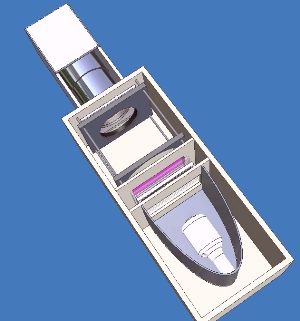

First, the cooling and lighting are not shown in the picture as it is an incomplete mockup. The re-reflector is slightly apart from the main reflector which lets a small amount of light escape but also lets air escape. Another hole not shown at the base of the reflector passes a mounting post for the light and also has an air gap for forced air circulation.
A smallest possible light source should be used because otherwise much light is lost by taking a path back into the original light source.
My goal is to make the best possible picture not the cheapest.
This same design could work exceptionally well with a high resolution 4:3 LCD panel.
Second, using a large non polarized light source will probably generate more heat in the LCD than this method. This is the method the commercial units use.
The reason I chose this size of aN LCD is because it is the only 16:9 LCD with adequate resolution of a reasonably small size.
The larger the LCD the harder to make the focusing lens.
This method could work without the focusing lenses but would have some reduced light output.
Even the OHP based strategies need to have polarized light if they are to have good color balance and maintain the LCD contrast ratio.
The Xenarc has 300:1 or 400:1 and a reasonaly fast response time. I would welcome any less expensive solutions but havn't found any yet.

add on
It was not my intention to make a fresneless design. I plan on using one if necessary to correct for uneven lighting. The columnator should work in conjunction with the light polarizer\recycler to make it more effective and by not wasting light going where it doesn't need to go we can use a smaller and less heat generating light source.
I am very picky about visual quality and though the good images I've seen look pretty good I would like something better. If it ends up being a larger high rez LCD then that will be it.
In theory if done correctly, the projected image should look as good as the original screen except with pixel enlargement and some minor abberations caused by imperfect lenses, etc.

more still
After having reviewed a DVD on my computer screen I feel that you are generally correct. Somehow my memory recalled less vertical use of the 4:3 monitor.
I still feel that this is a good design though it will probably require the use of a fresnel lens close to the LCD to even out the light output better.
I am now leaning towards the 4:3 LCD and building an anamorphic lens to add to the design. This will give me more LCD choices and I will have no loss of pixel resolution.

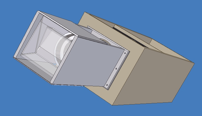

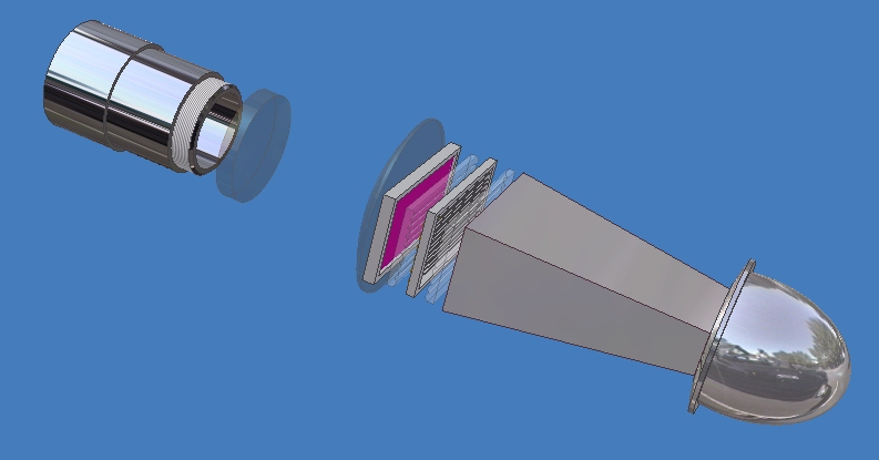

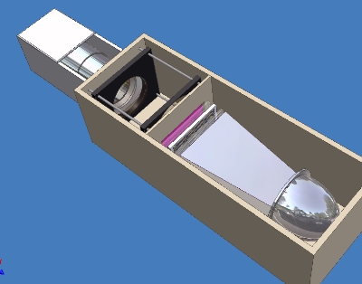

more pictures
Lifter, thanks for your responses. You are much more knowledgable than I regarding the technical aspects of the video formats however there are some physics here that you might not be seeing.
1) Your point is well taken regarding the LCD panel.
2) I have done some research on light pipes and this design does indeed re-reflect (for want of a better term) light in many directions until it can only escape via the columnator. Light which is not reflected out of the parabolic reflector into the columnator is reflected back into the parabolic reflector via the dish shaped reflector. It can take many paths but cannot escape (disregarding ventilation holes) until it finds the columnator opening.
3) I have some ideas for forced air cooling that I hope are sufficient to keep things adequately cooled. The LCD will be further physically seperated from the air in the hot side by a glass plate or combined glass plate and fresnel lense.
4) Right now I'm looking at a small Phillips HMI (halide metal iodine) bulb of about 100-150 watts. They are used for location film lighting equipment and are 5600K temperature. They are also expensive, but this is a no holds barred project (relatively).
Here are some more pictures with the anamorphic lens mount of the projector. I have not redesigned the LCD size yet because I want to be able to visualize the whole design first.

Gotcha. Like I said, I'm no expert on that stuff, just on the film and video stuff. That's a very interesting project. If you can get a nice output with a 150W bulb, I'd be very impressed.
All I can say is that loss of light is not the end of the world. I have a typical OHP setup with no "cones" containing the light paths, and I'm using a 15" display. Before I made the thing, I was very concerned about losing brightness, etc., but I can assure you that it is not even close to an issue of mine. While my OHP is pretty powerful (3M 9850), it has a switch to lower the output to 7000 lumens. I almost always use this setting and it's still bright enough. I have a halogen lamp in the room, and the image is bright enough to where I can have this lamp on and it still looks very nice.
I guess what I'm saying is that if you used a fresnel and a 15" screen, I don't think you're lumen output will suffer as much as you might think. Like me, your interested in a nice projector- not a cheap one. I myself don't have any use for a giant screen that looks like crap, no matter how cheap it is, and I'm sure you feel the same way.
I've been exploring future designs. I do have issues with fan noise, as well as the amount of heat that builds up in the room when the door and window are closed. I'm also concerned with the cost to replace my bulb ($350 everywhere I've looked).

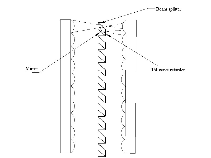

More talk and polarizer issues.
I have ben studying two different engineering textbooks. One on LCD's and the other on imaging optics. At this point I have probably only assimilated 5% of the information but one thing that I have gathered from both textbooks is that because of the way the LCD molecules interact with the light rays coming through the LCD panel, polarized light is necessary to get high performance.
The following JPEG is a scetch of how the polarizer/recycler works.
It works on a similar principle described in the light recycling article that can be found elseware in the link archives of this site but it is a more elegant solution for a projector if somewhat less perfect.
Heres how it works.
1) Light enters the first set of lenses which focus the light towards the next lens system. Some of the light is polarized and some of it is not.
2) The poarized light passes through the beam splitter and goes into the next lens without incident.
3) Light that is not poarized is reflected at a 90 degree angle towards the mirror which then reflects it again to pass through a quarter wave retarder. This light then makes it to the second set of lenses.
4) After this process a large portion of the light is polarized. Enough that a film polarizer can be used to polarize the remaining light nearly completely without losing too much of the total light output.
This method has several advantages over a film only solution:
1) It doesn't waste as much light output.
2) If film polarizors are used soley and the light source is very bright the film will absorb too much light and heat energy and the film will be destroyed and lose effectiveness possibly even destroying the LCD.
Here is the schematic.
Heres how it works.
Cheers, Hezz

Alternative lighting source
Here is the essentially same projector with an easier to build and less expensive lighting source. All components are not shown such as the light base and transformer, etc. Plus size is smaller.
This would be easier to cool with a large fan and light trap.
One large fan on top and lots of ventilation holes on bottom.
A light trap would be necessary to reduce too much reflected light
into the room.
One fresnel would be used prior to the polarizing lenses. Another right before the LCD if needed.
Use inexpensive 250 -400 watt metal halide bulb.
Hezz.
