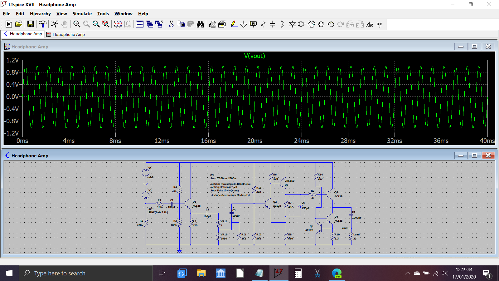

thanks... it works for me in my Germanium headphone amp simulation with all the original resistor values used in the real build.
GERMANIUM Single ended Class A Headphone Amp.
Yes, that's the circuit (right of volume) I copied to build... just taken from the shelf (some dust... cough) and with different parts: AC125, AC130 (npn!), AC132, 2 x AC124K.

Thanks!! I happened to have a GE plan open in Pspice. I had another AC part model; yours drops in and runs with less difference than I would expect across a bagful of Germs.

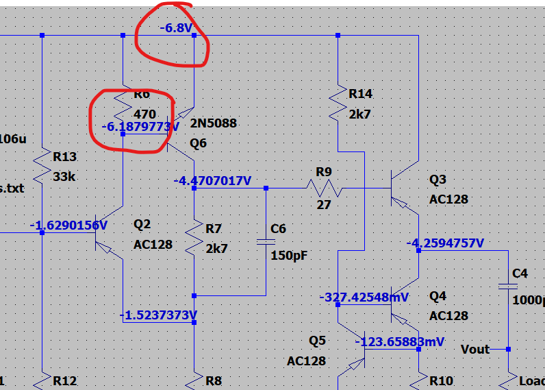

sgrossklass - you were so right! I re-did RB calculation based on Vbe plot (instead of numbers printed in datasheet), and it came out much higher at RB=180. That might not be best value for noise simulations, but for Vbe and Ic response, the model is spot on up to at least 100mA. Thanks for the suggestion.
I would use RB and RBM parameters as the base resistance will vary with current. Your rb of 20 might be better as an RBM figure.
I would also include RE and RC every time. These could be determined from the Vbe (indirectly) and Vce (sat) voltages. Note that the only parameters which stop excessive currents are these resistances.
What current is the 5088 working at?
From the devices I have evaluated old (Mullard) BC108 types had Vbe=0.62V at 1mA. Moderns (On Semi) BC547's have Vbe=0.65 at 1mA. Hagtech likes working from the datasheet so typical results from (old) datasheets might be where his IS has come from.
