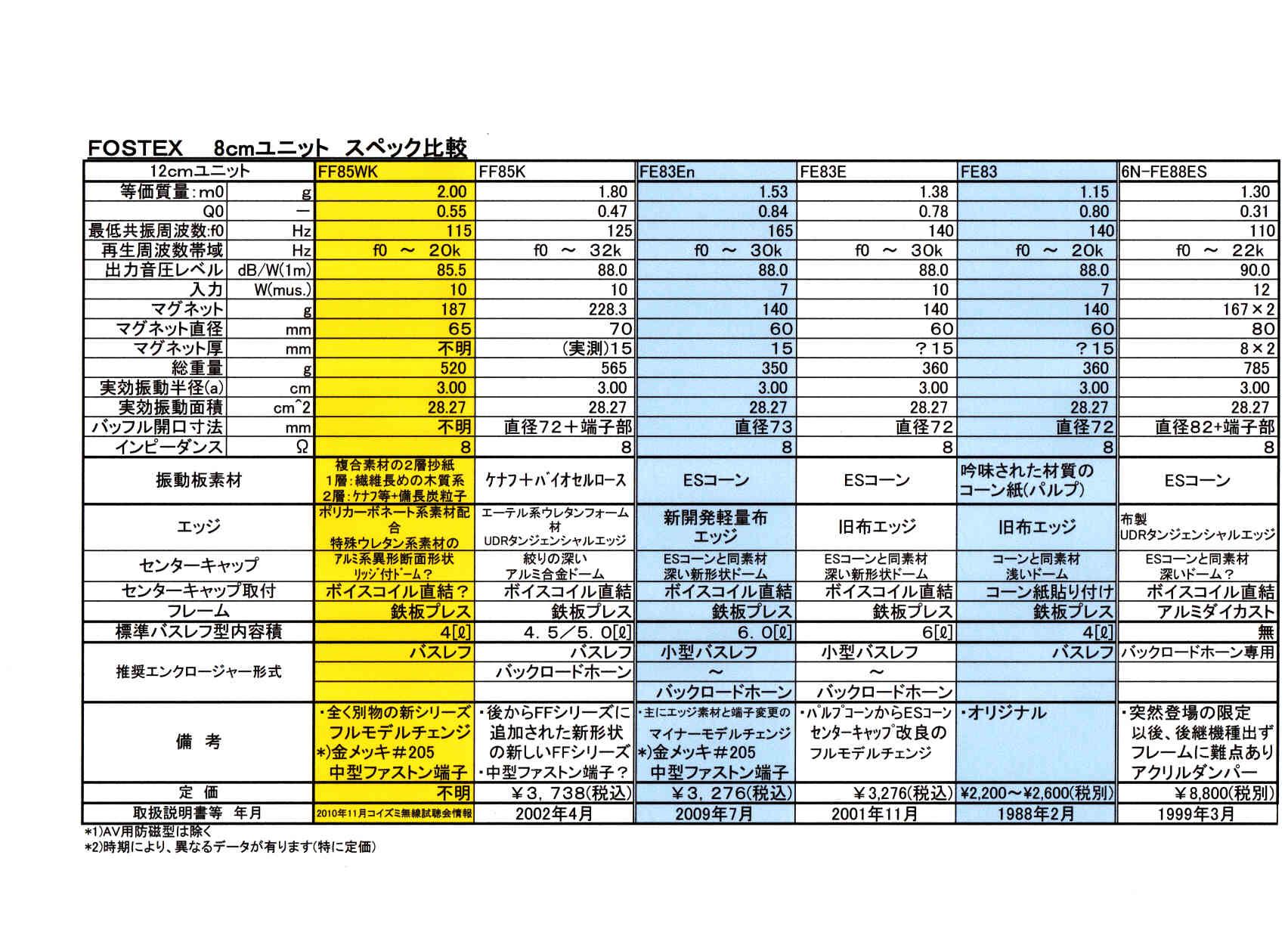

Kinda hard to tell from the resolution available on the 20 page PDF whether the UDR surround has been retained on the FF85KW (or expanded to other models), but it's heartening to know this driver will still be available, and the new FF105KW could well be a very interesting piece indeed.
Now, if anyone can translate the table posted above, or has access to full T/S parameters for the new units , the intrepid modelers can start (re)engineering enclosure designs.
As for the apparent reduction in sensitivity of 2.5dB between the old and new FF85K(W) and the in said table, it could well be a combination of more accurate measures than before, and some engineering changes in the motor/suspension components - note the 10Hz lower Fs.
Lastly (for now) - what will be most interesting will the be actual delivery dates and stocking levels of these new models. Remember how long it took for the recently revised FE -En series to reach all markets and stocks of previous and discontinued models to deplete?

Judging from the Qo figures, the Qt will be in the ballpark of the defunct FExx7E series units.
