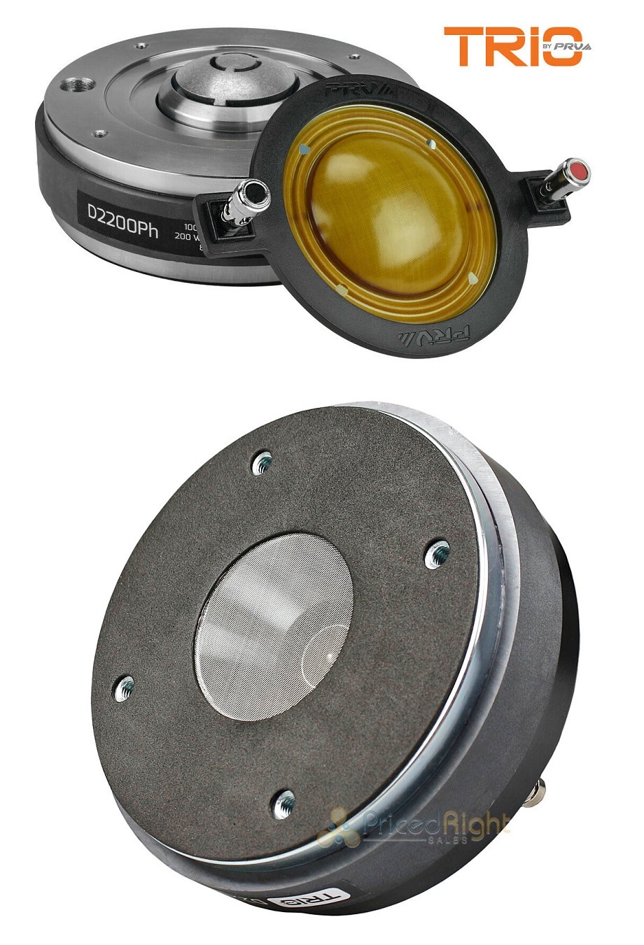

PRV's D2200PH driver seems to be one worth using
https://community.klipsch.com/index...-audio-d2200ph-2-driver-on-18-x-10-zxpc-horn/
I was curious about the DS18's as well but not enough real data.
The D2200Ph is a bargain for a midrange driver and it sounds good. Some more test results at :
D2200Ph on Exp300
D2200Ph on ZXPC 11x17
D2200Ph on PWT

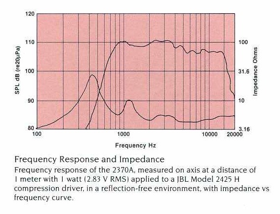

I guess you're referring to the on-axis response curve of the driver. From what I have read, all 2" exit drivers fall off before 10kHz, while 1" drivers hold up to 13kHz or so. However, a horn that compensates for this rolloff can avoid this issue, as already hinted by weltersys. One example I have seen is the JBL2370A that crushes the vertical so much that the horizontal gets equalised to within 6dB (picture). Other horns utilising similar tricks possibly exist.What I am really interested in, is an inexpensive 2" CD that doesn't drop off a cliff at 8Khz and can be used full-range (low end 400-600Hz) at low power levels.
According to JBL:
"....small vertical mouth dimension was chosen to allow a gradual narrowing of the vertical coverage pattern with increasing frequency. This provides acoustic equalization of the frequency response of the horn in the horizontal plane and compensates for the falling power response of all compression drivers."
I've used the 2370 with the Eminence ASD1001 and very little EQ is required to get to flatness. However, note that this is a horn for a 1" driver. If you're looking for 2" setup, the K-69 driver used by Klipsch with the K-402 horns (BM-D750) is easily available in the open market for DIY (link here) for reasonable money. However, do not trust the response on the BM-D750 datasheet, instead judge this driver based on its actual measured response given by people in the Klipsch forums.
