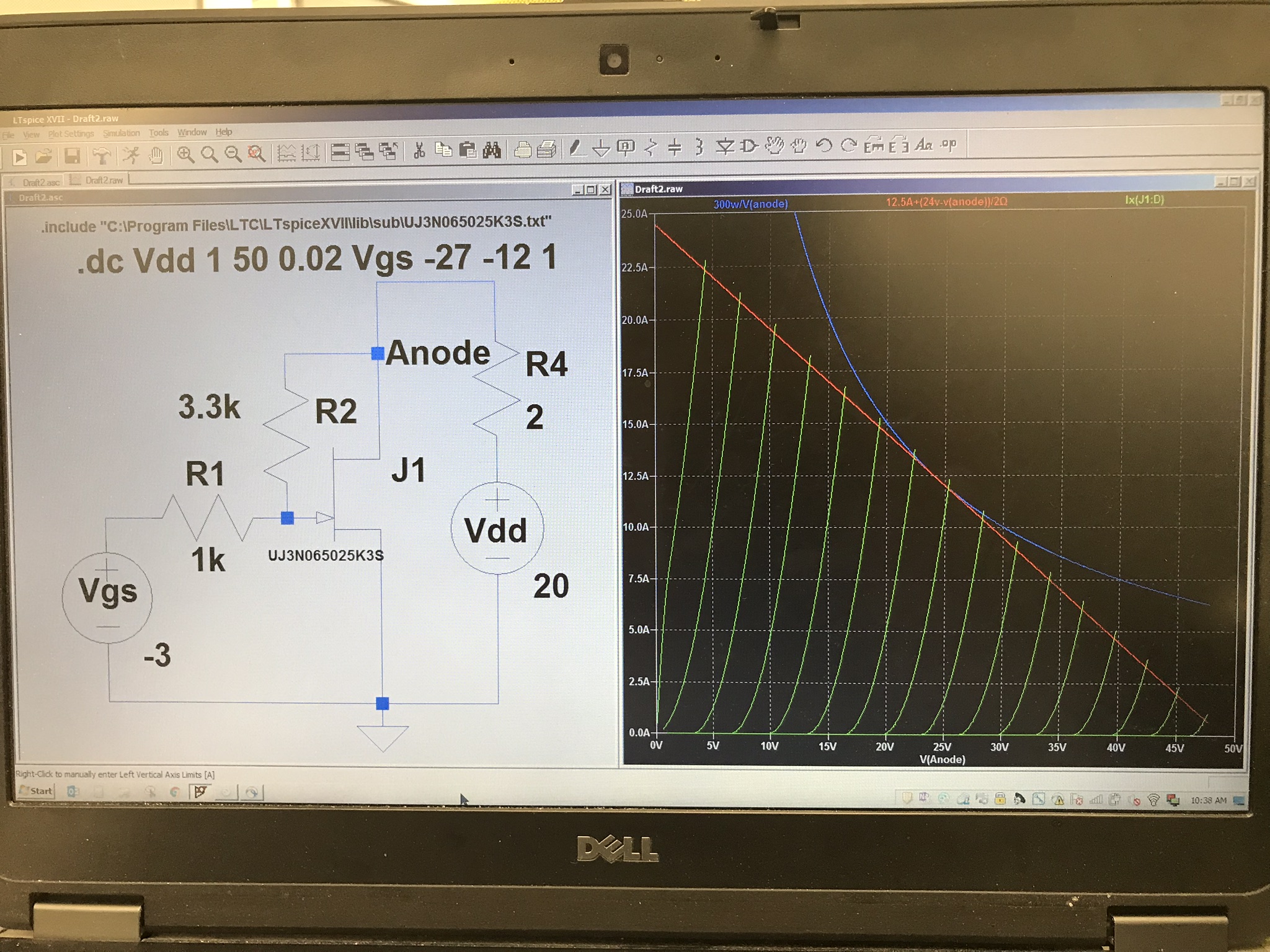

I got a notice from Big Brother (Google) on my phone that UJ3N0650803KS was 65% off at Mouser.
Less than $5 each if you buy 100
UJ3N065080K3S UnitedSiC | Mouser
Would you be able to use these in the Sissysit or is the threshold gate voltage too far out of the ballpark (-6V to -14V)?
