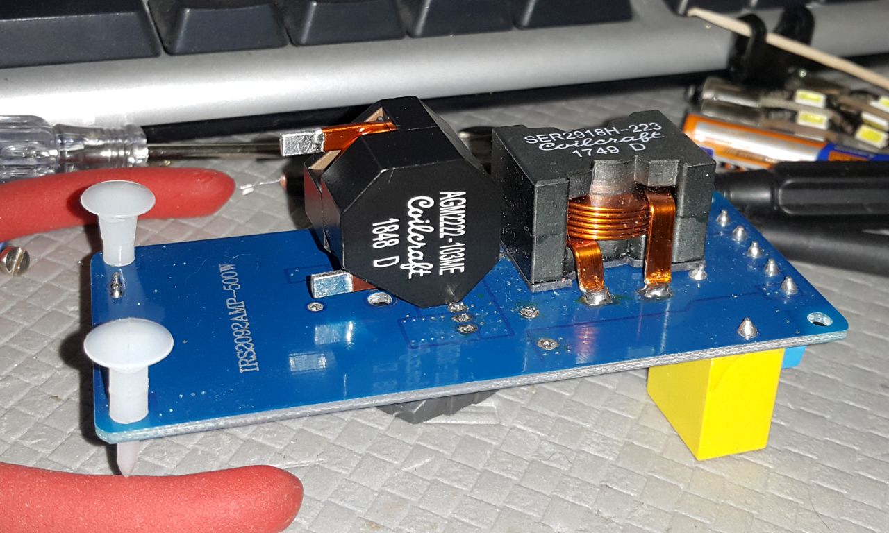

I asked Coilcraft for the voltage ratings of these inductors and they responded, that all are tested at 100Vrms for 1 second, when they are manufactured.
So, I think these inductors will be very good for TPA3255 and similar power amplifiers, with single power supply under 80V, or for dual power supply up to +/-40V.
What do you think about them?
Will they be good for Class D amplifiers?

With the maximum inductance of 10uH they might well be OK for 4ohm speakers. Higher impedances though would need to look to another range. Since the core material is powdered iron, what are the losses like at ~500kHz? Normally powdered iron is fairly lossy at higher frequencies and the wire doesn't look to be litz.

These AGM2222 are not really suitable for Class-D power amplifiers since the inductance really change vs current (load).
This results in more distortion.
All measurements I've seen proved gapped ferrite being the most linear core material. Any kind of iron powder including carbonyl is inferior.

Linearity is not related to low loss - I found lowest losses with carbonyl cores.
