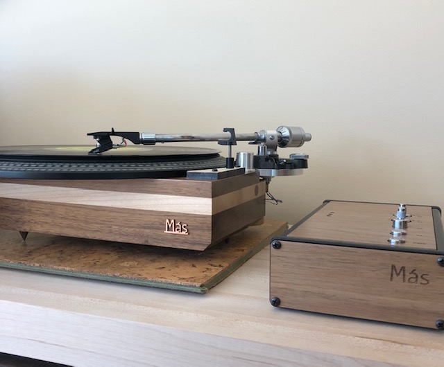

Gattu, in my opinion the dimensions of a plynth are not important. What I think is important is to maintain the original dimensions between the spindle and tonearm and to have a mass that absorbs resonance. I use Maple and or Walnut on my custom plynths. My main requirement apart from the critical dimensions and the parallel planes, is what it looks like. I have a minimalist preference for my TT's and I treat each one as a piece of furniture or art piece. Most turntables are pretty ho hum visually. Same with loudspeakers on the whole. The TT in the pic is typical of what I like to build. This one has a separate power supply to house the control electronics.

That is a beautiful piece of work and I won't expect to do anything close to that but I share a fondness for nice building materials with you. And as long as those are not an impediment for the sound (or if the difference is negligible), I'd go for a nice chunk of walnut, ash, oak, or maple.
Thank you for your compliment. Of the various woods, I prefer working with maple, However Walnut looks gorgeous but one needs to take measures to prevent accidental chipping at edges. Sharp cutting tools of course and I also use masking tape where possible to stop pull out.
Regards John
