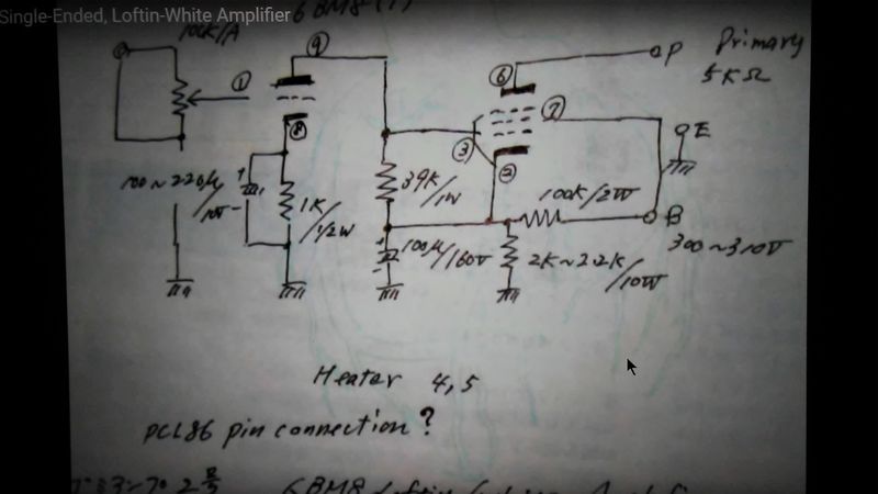

Grid stopper is necessary for the input to avoided the operating current go up and down while turning the volume.
Good luck. Fingers crossed the first power up goes well. You may need to play with the triode’s plate or cathode resistor to get the pentode bias right.
Have you seen TubeCad’s article reliability upgrades?
Loftin-White Amplifier
A nice upgrade when yours is up and running might be to implement the simple current limiting transistor version. I actually built his inductor version recently.
What’s up with the 100k resistor at the pentode’s cathode?
