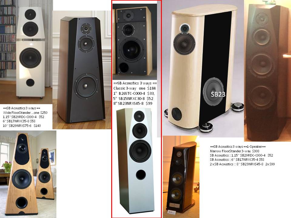

There are several SBAcoustics diy 3-way designs on the web from teams around the world including: (1)large 3-way bookshelf or stand-mount - using a 5" midrange with one 8" woofer; (2) generic HT tall and thin floorstander using a 6.5" midbass and two 8" woofers; (3) old-school combining a vocal range 6.5" midbass with a 10" woofer. Variations in cabinet design widens your options.
=====SB Acoustics 3 ways ====1-Speaker==
Classic 3-way $184 crossovers at 200Hz and 2.2Khz
SB Acoustics :: 1" B26STC-C000-4 $33,
SB Acoustics :: 5" SB15NRXC30-8 $52
SB Acoustics :: 8'' SB23NRXS45-8 $99
search for "SB Acoustics 3 ways" or try this link:
troels.gravesen@hotmail.com
Narrow FloorStander 3-way $308
SB Acoustics :: 1.15" SB29RDC-C000-4 $52
SB Acoustics :: 6" SB17NRXC35-4 $58
2 x SB Acoustics :: 8'' SB23NRXS45-8 2x $99
http://www.diyaudio.com/forums/multi-way/212738-sb-acoustics-3-ways.html
Wide FloorStander 3-way $250
diyAudio SB Acoustics 3 ways
SB Acoustics :: 6" SB17NRXC35-8 $58
SB Acoustics :: 10'' SB29NRXS75-6 $140
