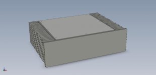

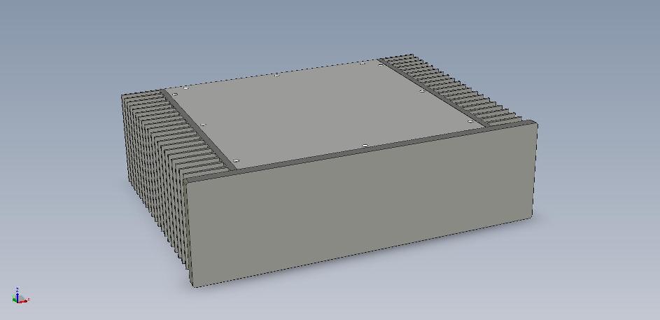

I am working on both amplifier and pre amp chassis for several personal DIY projects. There are only a few commercial cases available to us DIYers for this type of construction, and they are expensive to purchase and nearly as expensive to get to the US so I decided for the same money, I could roll my own.
The front dress plate is 1/2" thick aluminum with blind attachment from the back. The heatsinks are about 5" x 12" (3U tall case) and about 2.3" fins. The bottom plate is 0.080", the top and back are 0.062". I am looking into a hardwood for feet.
Aside from adding some vents to the top and bottom and figuring out what to do about feet, am I missing anything?
