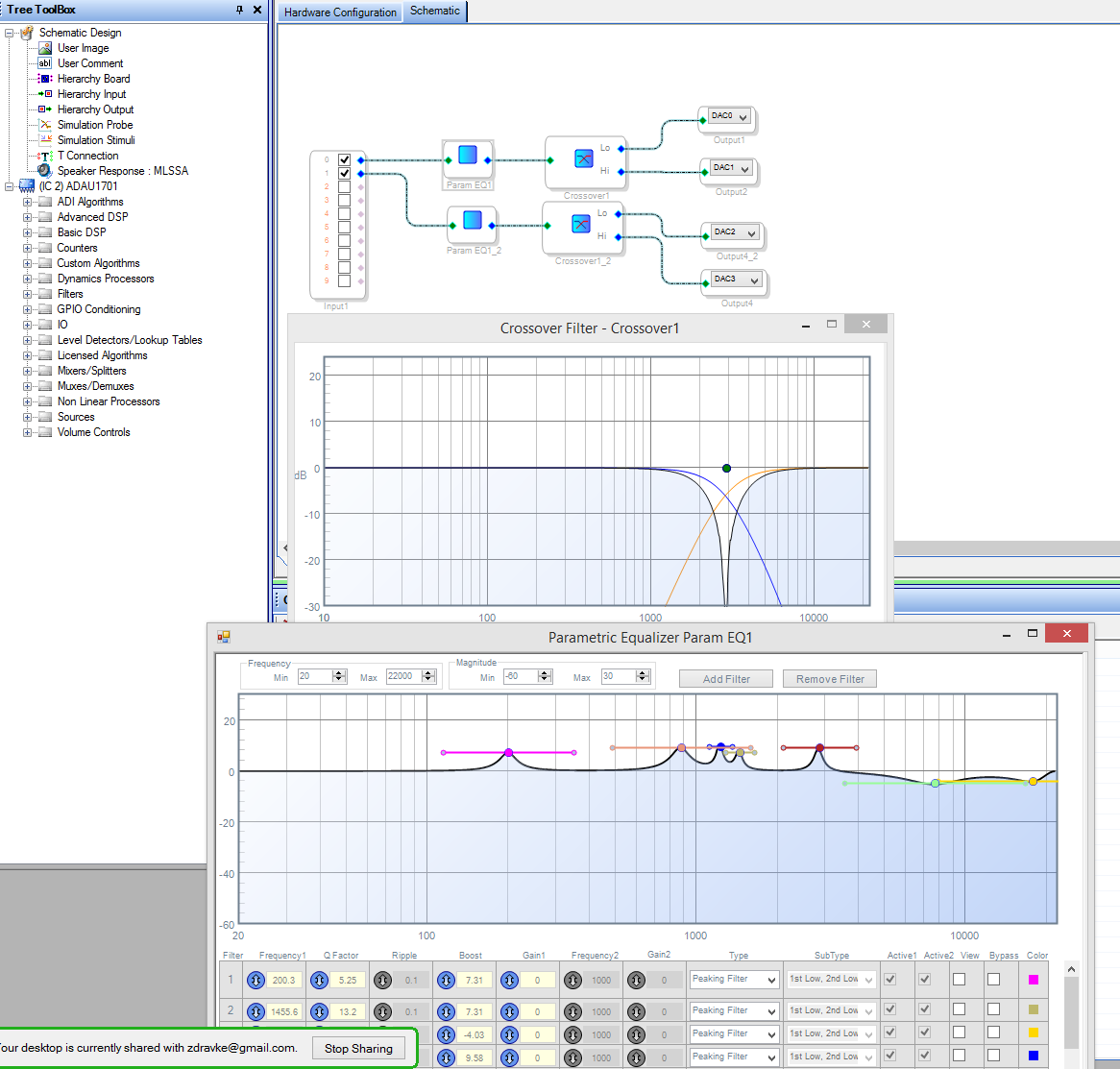

Which hardware? I have: RCA->freedsp-> 4 channel parallel LM4780 GC with passive pot->2x2way vented box. I still have to add two more channels to my GC, and put freedsp in the same amp chassis. So far, only 2 channels playing into one of the boxes.
Freedsp seems like a very nice alternative to chunky and expensive passive crossovers, so I wanted to try it out. If it's good for Mr. Linkwitz, it should be good for me
Future plans include arduino based 1602 LC display, relay input switching and motorised volume control, if the preliminary sound makes me happy enough.
Not sure if minidsp has ability for realtime parametric eqalization and crossing. Everything is realtime in freedsp with usbi programmer.
