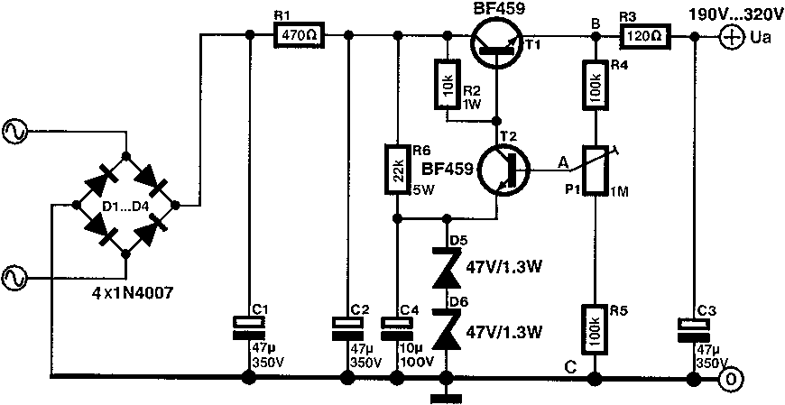

Make the + output the common or ground connection and the 0 output now becomes your - output.
Simple.
Yes that would be simplest solution. Thanks
The capacitor polarity stays the same.
All you do is relabel the outputs. and move the ground connection if it is needed. or remove it if it is not needed.
The zero becomes the -ve output
the +ve becomes the zero output.
After you have modified anything, use a bulb tester for next power ON.
