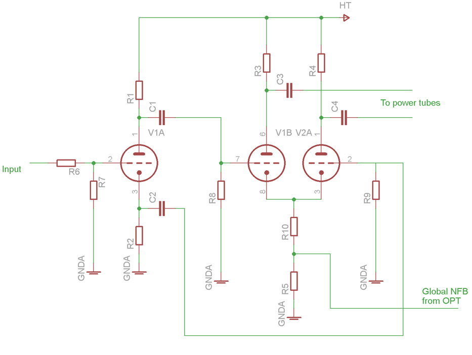

Just wondering if anyone has used negative feedback to the differential pair used as CC drivers for the power tubes. I don't mean the phase inverter configuration, but the long tailed pair with two in- and two outputs.
It's done frequently in the Circlotron OTL topology. No different, really, than how it's done with SS op-amps. The main thing to watch out for is that you buffer inputs that could be connected to different source impedances, as these add to the Rs resistor(s) and can unbalance/change the level of NFB you've designed for. It's not a prob with SS op-amps since these already use buffered output stages that have very low impedances.
Thanks for all the info! I'll look into the Circlotron topology. I understand the necessity for balanced (buffered) sources, but for some reason, the workings of global NFB to the LTP elude me...
To make sure we're all talking about the same thing, I sketched up a schematic of what's in my head, as Jehan suggested. Is it still viable??
No. Something like that is sometimes used in guitar amps, but there the aim is not fidelity but controlled distortion. The problem is that the feedback is applied in common-mode to a differential-mode stage. You should instead put the feedback on the second LTP grid. Then to avoid common-mode distortion use a CCS tail.
