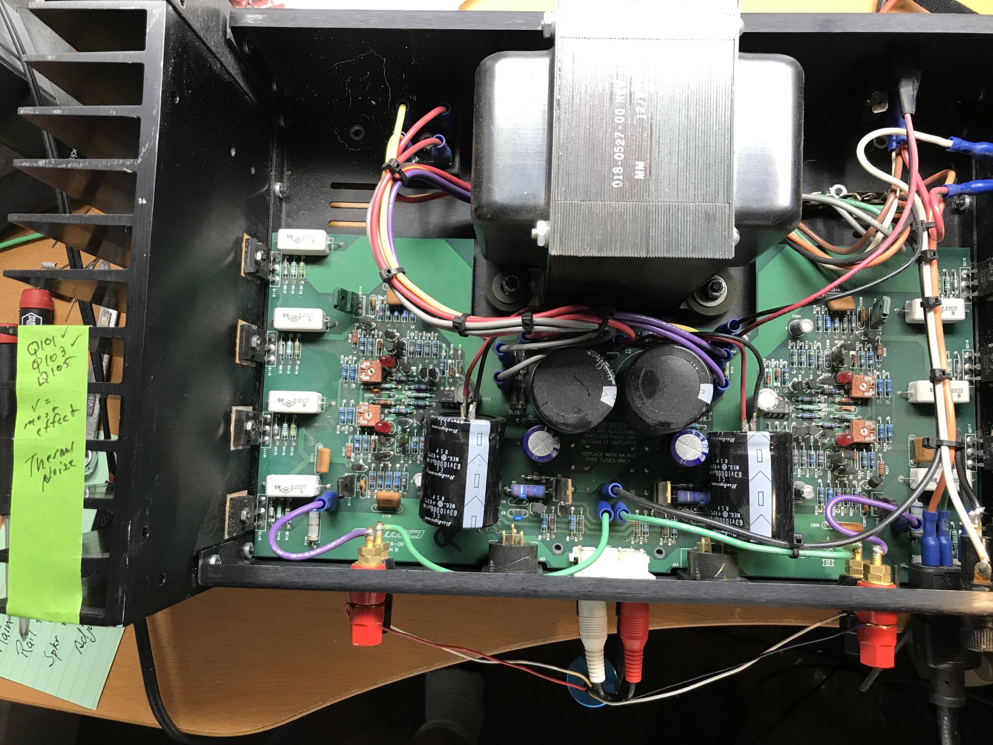

Need Sumo Polaris 330 III schematic
I was wondering if anyone might have a schematic for this power amp? I have looked high and low to no avail. I have also tried SAE news groups too.
Thanks, Rick
I am getting some thermal white noise from one channel. Using freeze spray on what I believe is the diff pair it shuts it down. It uses 2n5551 and 2n5401 and I just recently sorted a bunch so I will probably be ok without schematic but it would be nice.
