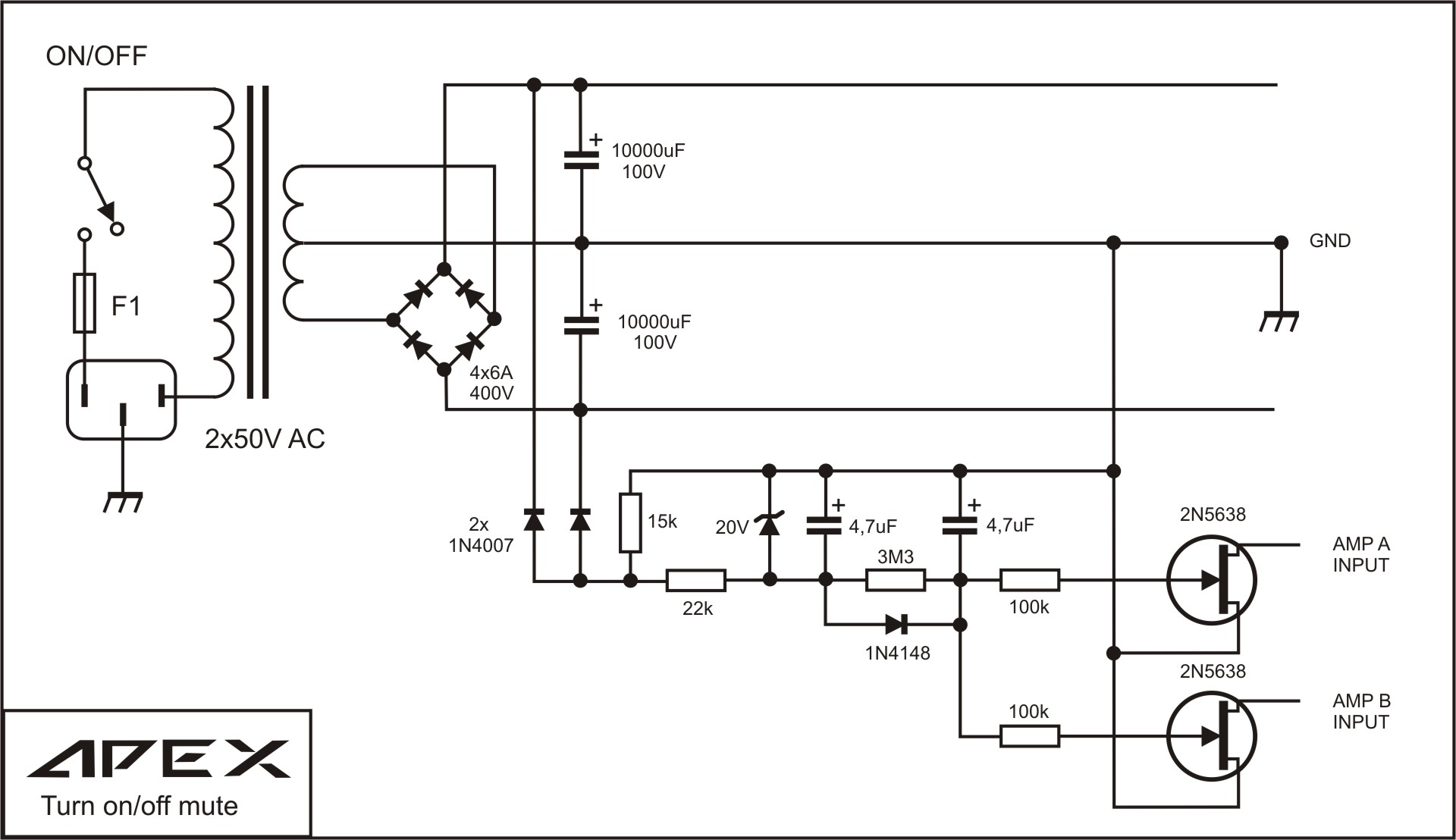

i'm building a medium-sized power amp & don't need a complex relay-type of anti-thump.
Years ago I saw a simple circuit using a fet on the very input of the power amp; I recall that this device momentarily shorts the onrushing turn-on votage, then from here on it doesn't count.

The circuit I want comes between the input cap & just before the input darlington pair.

What you are looking for has been published in this forum by user APEXAUDIO. Send private message to him asking for this circuit. Or search over his threads.
Max.
Max.
Take a look at this post: http://www.diyaudio.com/forums/soli...timate-fidelity-amplifier-37.html#post2324285

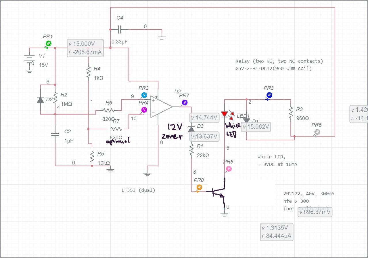

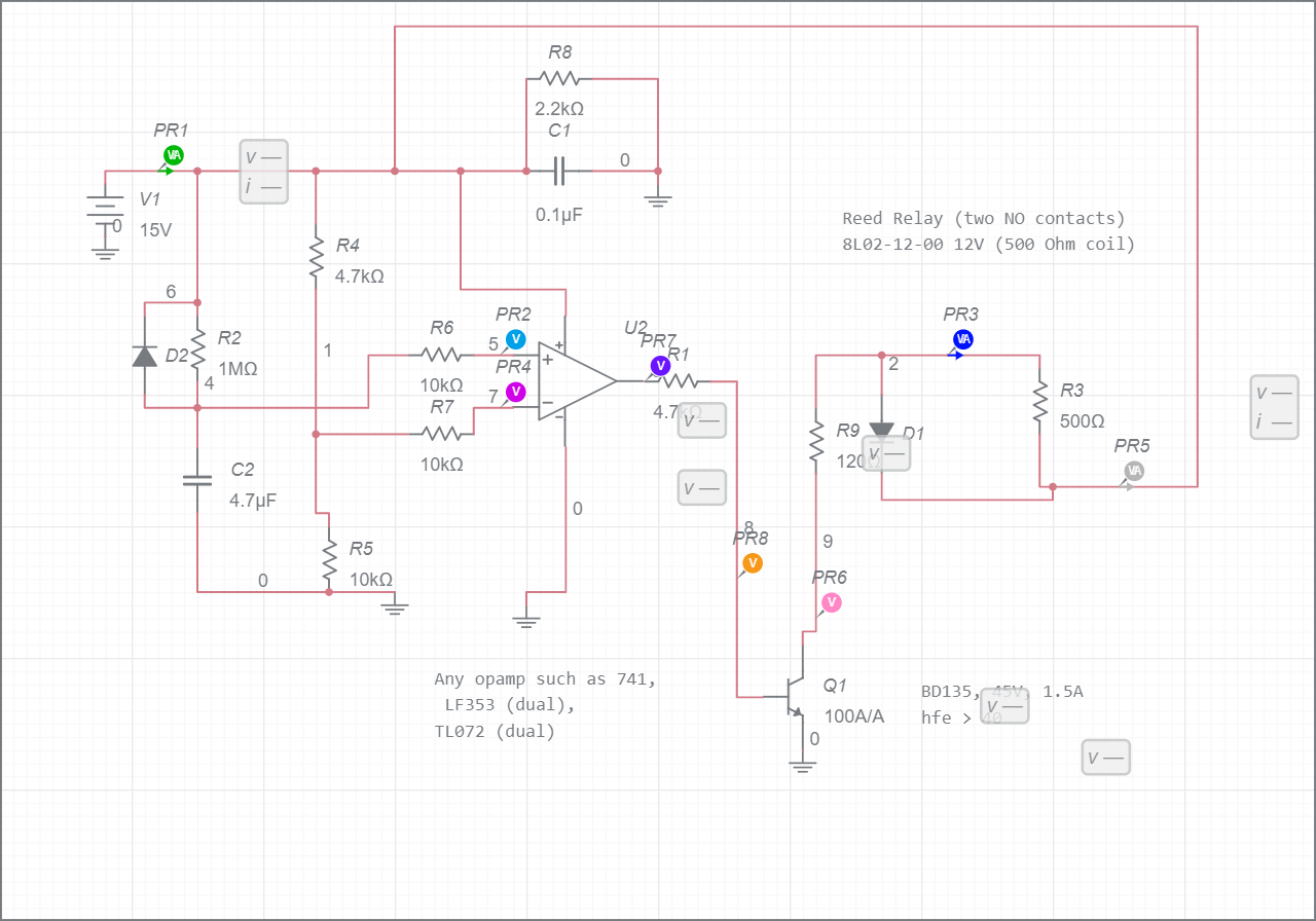

I have a new design/idea. R2 can be a multi-turn trimmer that controls the turn on delay. R3 is the coil of a reed relay (for preamps - audio signal with low voltage/low amps) or relays (for speakers). R8 is to discharge C2 when power is off.
I have thought, and have seen, ideas using transistors instead of relays for protection, but have found that relays are the best solution to really mitigate or eliminate anti thump. My opinion, and I have used this solution and it works fine.
Muting with delay w/ Reed Relay 1 - Multisim Live
I ended up building the attached for a preamplifier. 15 Vcc power supply. Relay has two NO and two NC contacts. I setup the L and R channels connected to ground when NC. It works fine. This circuit consumes less than 0.5 W. Delay is approx. 3 seconds. C2 is 1uF WIMA film. C2 and R2 control turn on delay.

My solution is merely for the output of an audio source or preamplifier, not for speakers necessarily (3 second delay). The relay G5V-2-H1-DC12 is very quiet.
