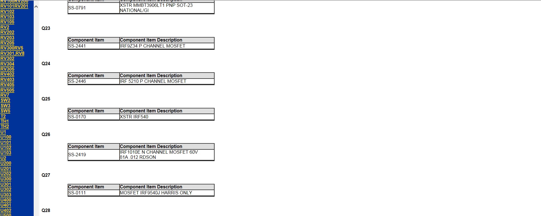

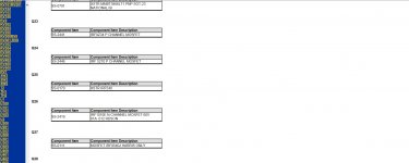

Trying to repair the sub channel on a Rockford Fosgate Power 600.5 and am having some difficulties with different voltages on the left and right sides of the sub channel. The four channel section has no issues, the power supply has already been repaired with IRF3205 transistors. Amp plays fine on the four channels with the sub outputs removed. Does anyone have a schematic for this amp? All the schematics that I have downloaded are for the Punch 600.5 which uses IRF540/9540 in the sub channel. I need the schematic for the Class G sub channel with IRF9Z34, IRF5210, IRF540, IRF1010E transistors in the output section. Thanks.
The only schematic that I was able to find is named 600a5 _PC-1986-E.pdf. In this schematic the PS FETs are SSP60N06 while my amp came with IRF1010E in the power supply.
The PC # on my amp is PC-3296-D.
The power supply FETs may have been changed when the series went from a5 to .5 and I understand their similarity, but does that mean the sub channel of my 600.5 can be rebuilt using 2 IRF540s and 2 IRF9540s instead of the IRF9Z34, IRF5210, IRF540, and IRF1010E that it originally came with?

Well, I guess the circuit schematic and component locations are the same.

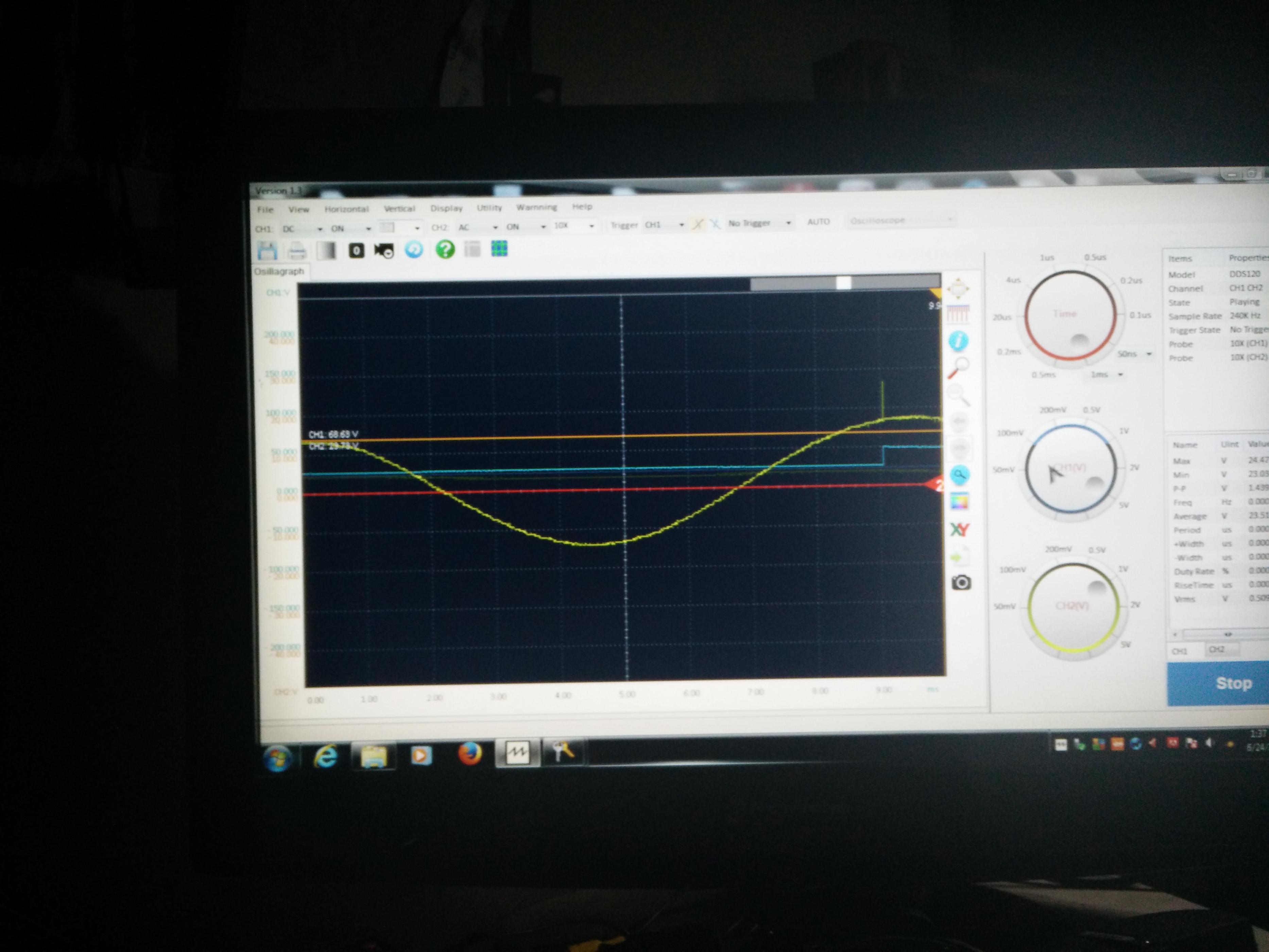

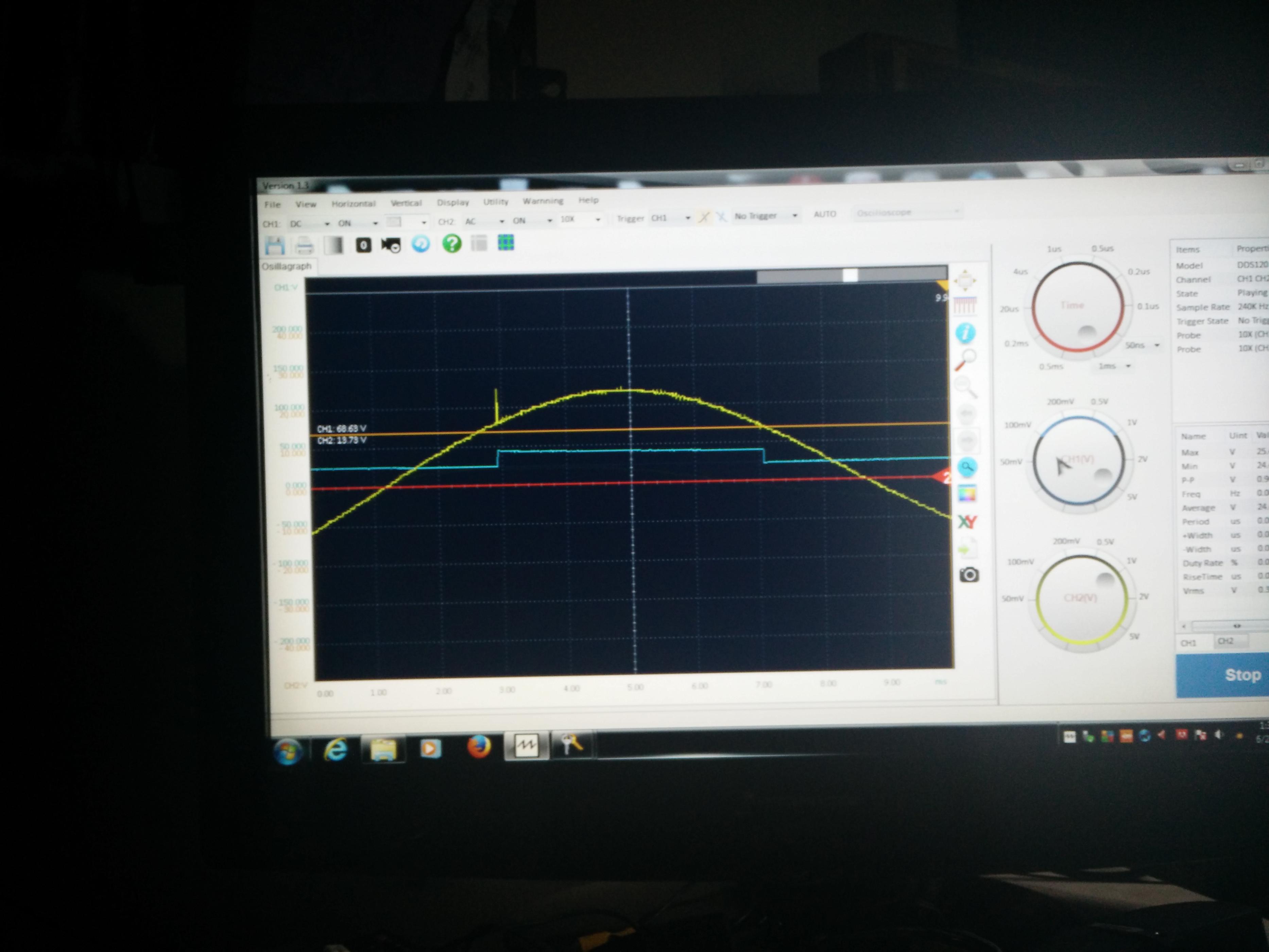

Are these pics an example of the HV rail switching into the LV rail?
The blue line is channel 1 connected to the source of the positive output, while the yellow line is channel 2 connected to the drain of the positive output.
It appears so but the scope isn't set correctly. Set the scope to DC coupling and use the same vertical amplifier settings for both channels.
