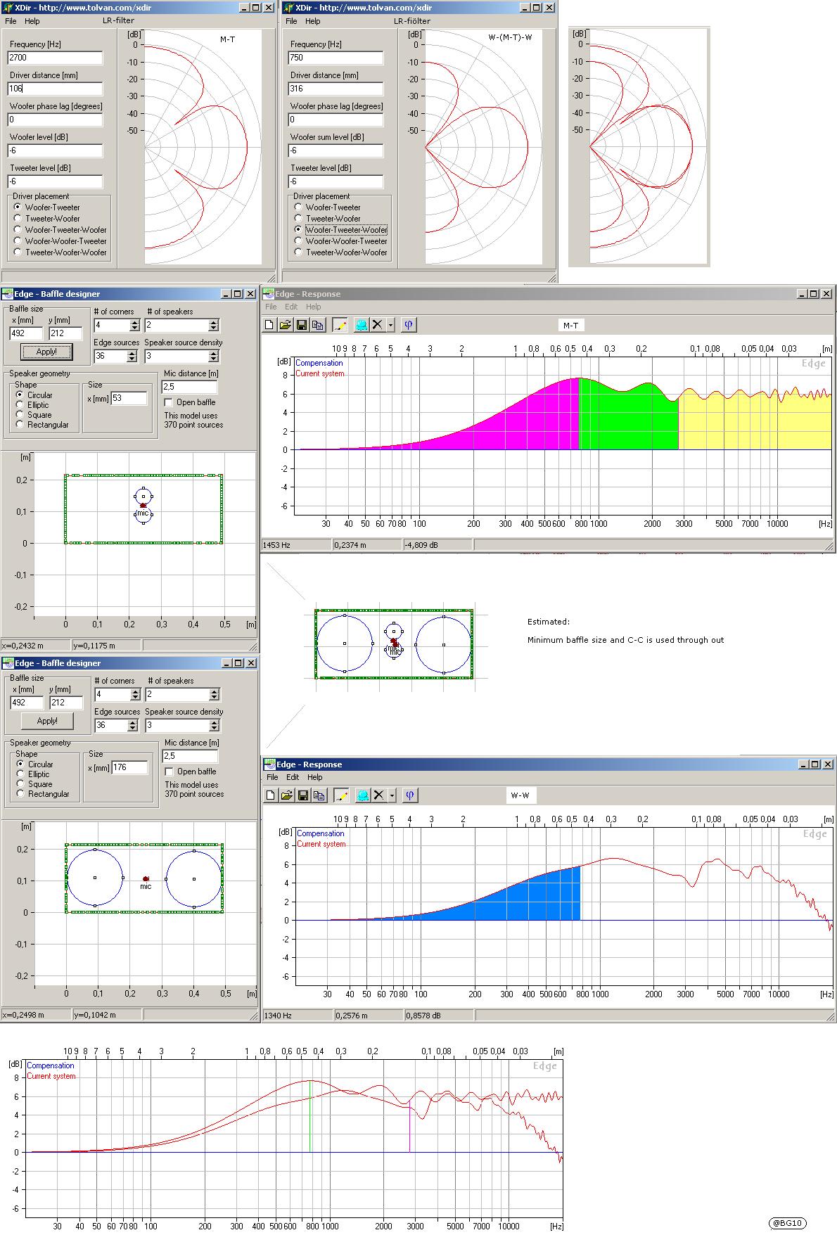

Hi kjgarrison,
Would you mind posting a picture showing your current filter design and the corresponding component values in use?
Have you thought about baffle impact on the center FR and do you have any FR measurements done at 1 m on axis?...See the picture for hints

TBH in your shoes I'd be lloking at the crossover design and your original
choice of drivers, I would be looking at replacing the two bass drivers
with lower efficiency drivers (they will have more bass extension) and
using the Seas in another project for a pair of speakers.
The two seas in parallel are too efficient for your mid and will be for
the jordan as well. Active level controls would help but its a fairly
expensive way of fixing a fundamental problem.
FRD Consortium tools guide
And looking at Zaphs centre version of the ZDT3.5 should help.
I'd say look at a pair of these
Dayton DA175-8 7" Aluminum Cone Woofer | Parts-Express.com
The reference RS180's might be still a little too efficient,
but if not an obviously better choice.
If you simulate correctly and use Zaphs centre response alignment
you should get better results than what you currently have, and
using the Seas bass units data confirm what your problem was.
rgds, sreten.

bjorno, thank you for the reply.
I will look at the hints you provided to see if I can figure out what you are asking.
[EDIT: bjorno I looked at your hint, and I have no idea what software that comes from, and of course I don't have images such as that to provide for you.]
