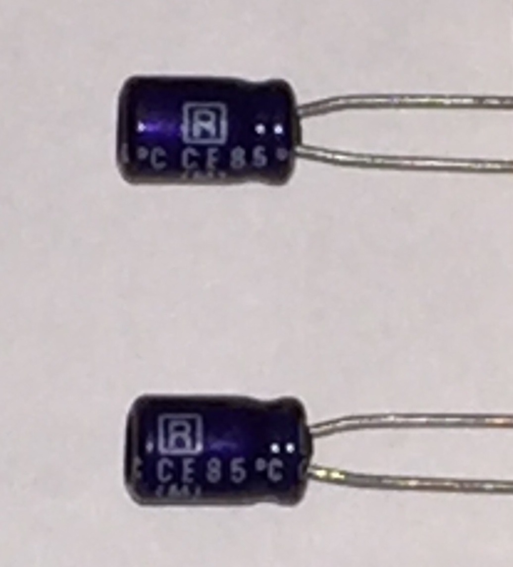

Hello,
Does someone know the manufacturer associated with this logo ( letter "R" inscribed in rounded square ) ? It's an old capacitor with build date 1999 so we might need to jug our collective memory 😎. It's propably a Rubycon but the cap is too small to write in full. This cap was built at the beginning of the infamous "capacitor plague" era and I need to confirm it is not from an affected manufacturer.
It would be nice to have a table with manufacturer logos both current and historic, I found some "general equipment" ones of for ICs on the net but none specific to capacitors. Perhaps someone here knows of one?
Thanks in advance!
Joris
Yep, Rubycon. See here for an example: https://www.digikey.com/en/products/detail/rubycon/25MH710MEFC5X7/3562778

It measures fine. I should add that they were stored bagged and boxed in a cool controlled environment. As a matter of fact, I do have some caps from the affected brands - These went to the trash bin. But most are from "reputable" brands that weren't affected.Measuring beats guessing 1000:1

I've put some Panasonic caps from that NOS lot in my amplifier; so far so good. I give them a 24-hour "reforming" treatment - low current at close to rated voltage, as rule of thumb for this is 1-hour for each year in storage. I measure them after the treatment and they are still on spec; I even check them for heating while running the treatment. Yes I have too much time on my hands 😛 ! Still an interesting experiment though.
I won't have them in the amp for decades though. The amp is undergoing re-capping due to aging, I recap section by section and these are just a stop-gap measure while I recap the rest with fresh parts. When I'll replace the NOS caps it will be an opportunity to evaluate the effect of top-grade components in various parts of the circuit.
According to Wikipedia, the capacitor plague affected all kind of electronic products but yes, mostly PC products, since the erroneous electrolyte formulation was for low ESR capacitors. That may have saved the day for products that didn't need the lowest ESR caps.

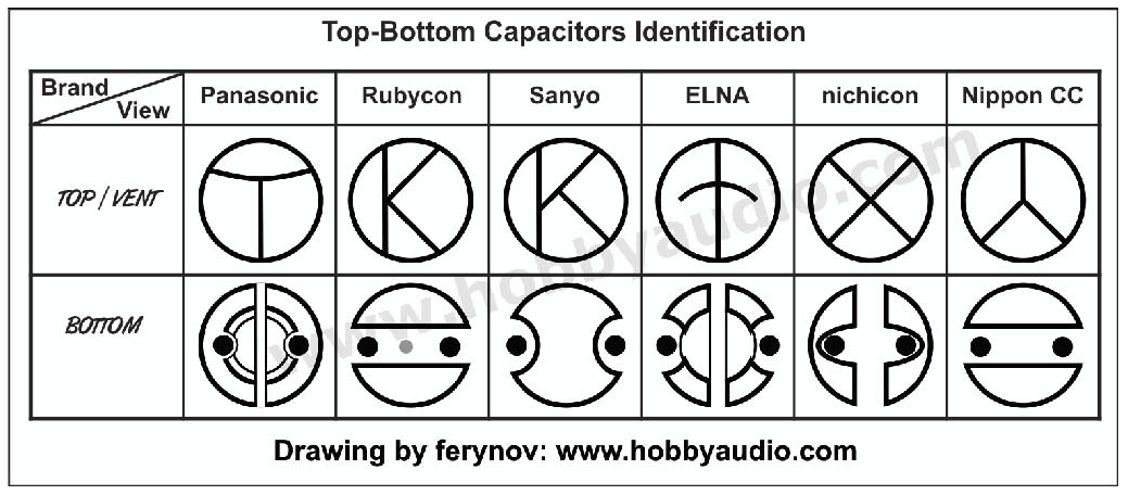

Thanks for this, very interesting indeed! I didn't know this form of physical branding even existed.Not logos, but at least some form of identification
Mind you, those legs show some corrosion.
Not "unusable" but might not take solder well (or at all), I'd play some soft background Music and wipe a full bag worth with steel wool (not emery cloth which would remove too much) , a couple swipes between thumb and forefinger, to restore bright shiny surface.
And use these within a year.
Use Scotch Brite / similar or fine (more than 600 grit) abrasive paper, try not to remove the plating, the copper underneath corrodes faster than the plating.
A brass wire brush is also quite suitable.
I would do the cleaning just before soldering.
