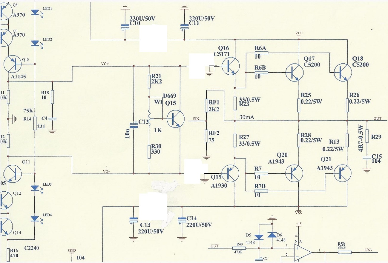

Hi.
I bought some PCB's which are an adaptation of a Marantz MA9S2, but incorporate some custom changes(such as an op-amp-based DC servo), and utilizing multiple pairs ON-Semi 4218A/4302A with 62v rails.
See attached schematic
In testing I'm utilizing an incandescent light bulb in series with the variac, then the transformer, rectifier, caps, then F1A fuses in series with the VCC and VSS rails; milliamp meters in series with each rail, and a voltmeter to probe across each 0.22 emitter resistor to determine the bias current(target is 50mA). Outputs and bias transistor are mounted on large heatsink(Conrad MF35-151.5).
First tests as I slowly bring the rails up to only 1vdc, 2vdc, 3vdc I notice that the rails draw up to almost an amp of current. The voltage across the 0.22ohm emitter resistors reaches about 95 mV(which I calculate as over 400mA bias).
I've checked all my component placement and soldering and it looks fine.
The only changes I made from the stock board were to enlarge the coupling caps slightly, and to locate the VBE multiplier transistor (Q15)on the clamping bar used hold the outputs to the heatink with a 3.5" wiring harness connecting the three transistor leads to the pcb.
I'm afraid to increase the rails any more at this point, until I get some help or advice on what seems to be happening (or is wrong).
I truly appreciate any help at this point!
-Chas

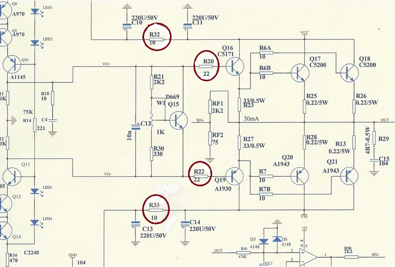

Divide and Conquer is the way.
Remove R32 and R33.
Remove R20 and R22.
Ground the base of Q16.
Ground the base of Q19.
Bring up the power supply slowly. If there's still a bunch of current, then you know that the problem lies in something around Q16-Q21.
Good luck...

Q16/Q19 bases grounded; 4 resistors removed
Okay.
First shown is diagram with referenced resistors circled.
Second is diagram showing removal of said resistors, plus
Q16/Q19 with bases grounded, as recommended.
Test setup will remain the same as before when powering up with variac.
Any other recommended test points for checking this circuit as modified?
-Chas

We're in sync. Check voltage on all emitter resistors of output transistors. That lets us know where the high current goes.

The schematic shows a (badly drawn) 1K trimpot next to C12. That's to set the quiescent current. You need to adjust it to get the correct voltage across the 0.22ohm emitter resistors. You'll have to undo all the changes djoffe recommended first though.I notice that the rails draw up to almost an amp of current. The voltage across the 0.22ohm emitter resistors reaches about 95 mV(which I calculate as over 400mA bias).
