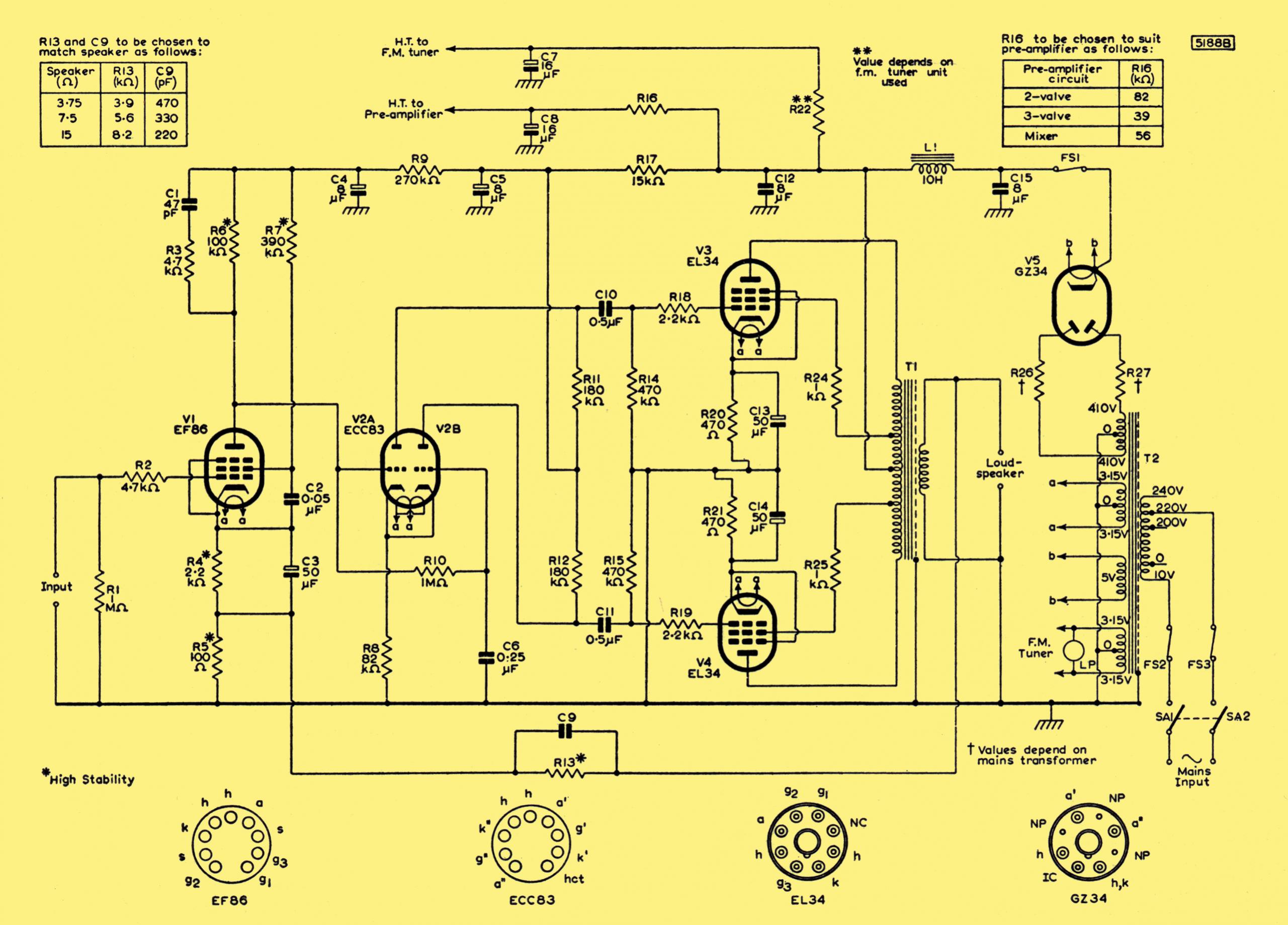

Next question. What tube and configuration is good for an input stage? Would a simple common cathode triode work?
I previously recommended Mullard style circuitry. I've uploaded Mullard's seminal 5-20 schematic. Please observe the key features, which are a common cathode voltage amplifier DC coupled to a differential, AKA LTP, phase splitter and a GNFB loop.
Use a different small signal complement, as the EF86/12AX7 combination shown yields too much gain for mating to today's digital signal sources and both types are low transconductance (gm). High gm is protection against slew limiting, in a circuit with loop NFB.
Another improvement is to replace R8 (the LTP tail resistor) with a 10M45S constant current sink (CCS). A CCS in the LTP's tail, instead of a resistor, forces symmetry between the 2 sides.
Highly unlikely, especially if you include NFB.
As far as the front end goes, there are lots of possibilities.
Ex 1
Ex 2
Other possibilities include the "Williamson" topology (uses cathodyne splitter behind a second stage of differential gain). There are various other kinds of splitters, but none as good as either the cathodyne or LTP.
