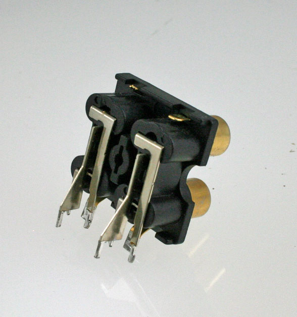

I assumed that the photos showed what you needed.
They do. Look at the 2 taps underneath. They attach to just to the shields.
So, the large tab connects to the bottom shield and the leg that sticks out the farthest connects to the top shield.

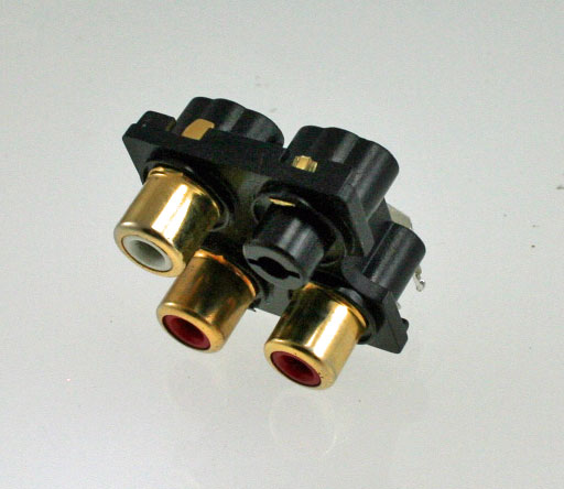

The RCAs appear to be like those in the attached photo. The wide tab is the shield for one channel. The connection farthest back is the shield for the other channel.

No they won't. The shields on those are tied together. The one I need the shields are isolated. I think they do that so that they can invert one channel for bridging.

That is correct Perry. Like these also.
Is the only problem the missing shield? If so, you could pull one from another jack.
I tried that Perry. The flanges for the jacks are different. There is also a little donut-shaped spacer in there too.
