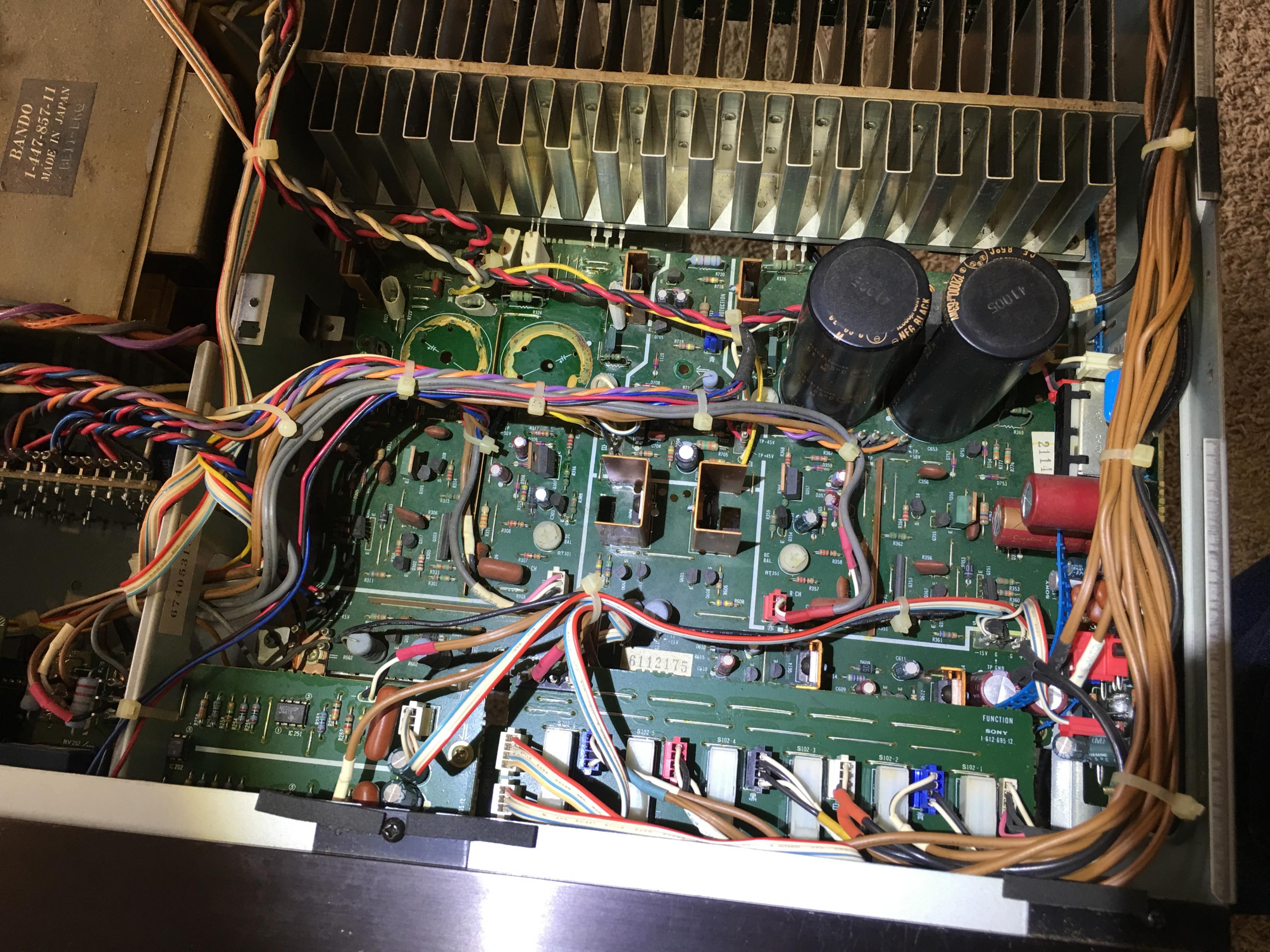

Hello, Trying to repair the left channel on this Sony ES amp and not having much luck. Suppose to be getting 45 vdc +- on the left side but only getting around 32vdc +-, also getting around 5 vdc on the speaker +-outputs of that channel which isn't good and causing speaker to pop. Any help on this would be greatly appreciated.

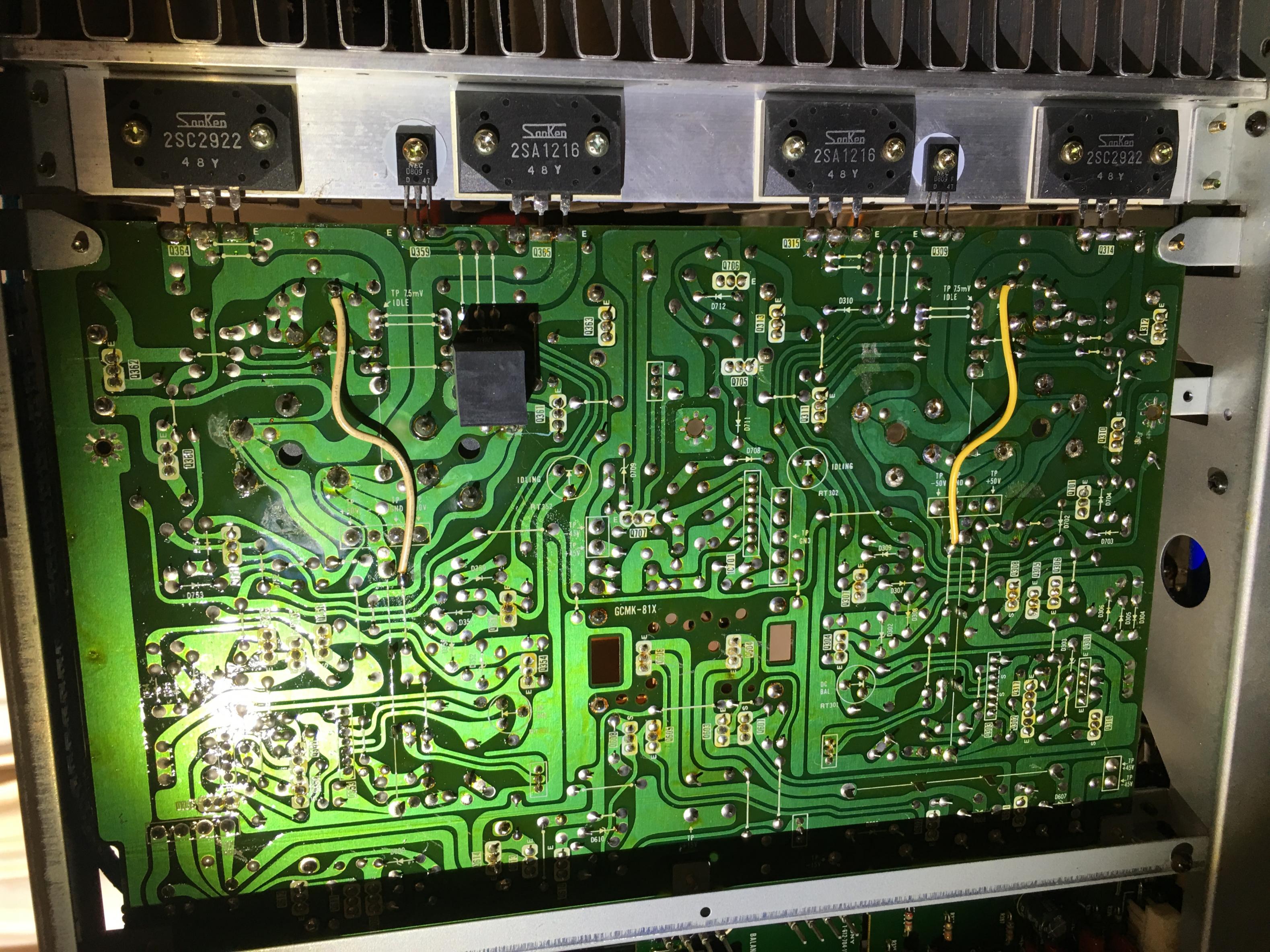

I'm sorry, I meant 50 vdc +- on power rails. No shorts on Sanken Transistors but on left channel I am getting 10k resistance on the E legs of those transistors 2SA1216 and 2SC2922 with the big caps removed on left channel. The caps had been leaking so I removed them to order replacements and cleaned up the board where the electrolytes had leaked. Not sure if it should have that 10k resistance to chassis ground on E legs left channel only?
I got the 45 vdc +- from the transformer inputs test points and they tested a little low as well. If I remember correctly I was getting 42.3 vdc on the positive test point and 43.8 vdc on - TP.

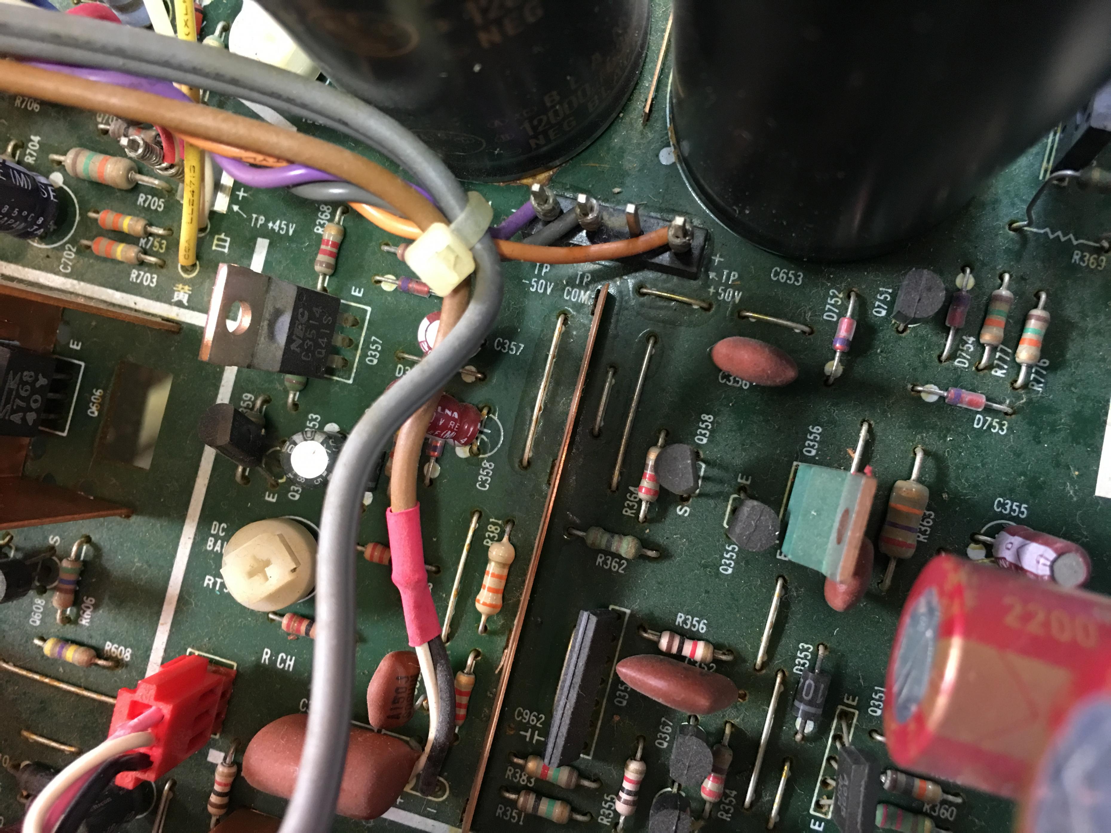

Nominally +/-48Vdc. The candidates are,
transformer winding
noise path caps eg, C601, C915
rectifier bridge
main filter caps
Check/measure AC voltage on transformer secondary, compare with
other channel/transformer. Getting +/-32Vdc suggests cap failure/leaking

Thanks mbz, I will check those things out and see what I can find. I screwed up on the title and its really a Sony TA-F444ES not ESX and only has 1 transformer instead of separate transformer for each channel.
It does have one transformer, but with three separate windigs: left, right and low voltage.
So if possible, check the bridge as said by mbz and if ok swap the rail wires left-right.

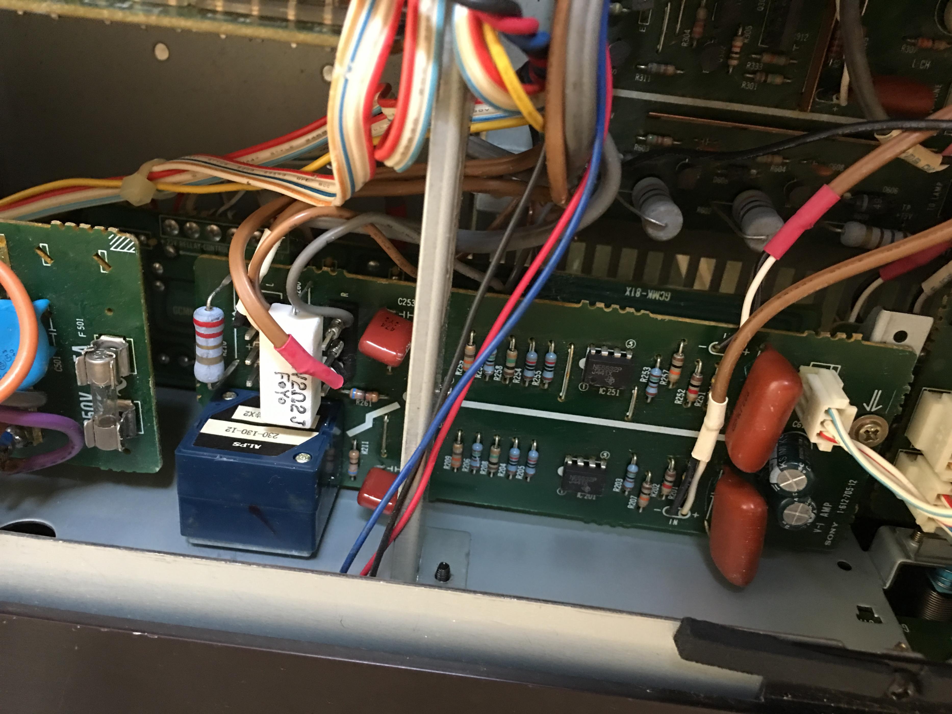

Well Good news, Found a bad 2watt 2.2ohm resistor on volume right channel control board that was bad and reinstalled main rail caps on left channel and now I am getting 50 vdc +- at test points. I adjusted DC bias and DC idle on both channels and came out really close to spec within .1mv.
So then I hooked it up to test with speakers and barely turn volume and right channel jumps from no sound to full blast and have no adjustment. Left channel I get nothing but a little background hiss. So I think amp board is working but have a problem in volume board or pre amp?

Only had a 5 Watt resistor to replace it with. would it be possible that it took out one of the ne5532p on the right channel?

Only had a 5 Watt resistor to replace it with. would it be possible that it took out one of the ne5532p on the right channel? I am getting the 15vdc +- to the volume board. not sure how to test opamp?

Okay, I removed preamp (Volume) board and removed and tested opamps. One of the NE5532p's are bad for sure but the opamp in front of the 2 NE5532p's is an NEC C4082C and it doesnt test same as the NE5532p's so I cant tell if it is good or bad. Would you know of any good replacements for it? I have a bunch of audio opamp stock like TL072, LM358, OP275, AD797az, OPA2164, OPA2134, AD823, AD712, OPA2228 etc...
